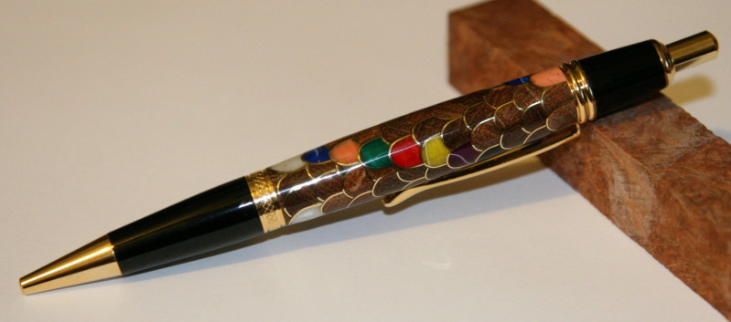

Depends on what you are wanting to do. What Roy Quest did was a tough procedure and not seen before or ever again from what I know. At some time I may try his method. But if you are looking to do something like I did and show here than the tutorial is in the library. Look under blanks and scalloped segmenting. That is all this is. a bunch of scallops on top of one another. http://content.penturners.org/library/pen_blanks/scalloped_blank.pdf

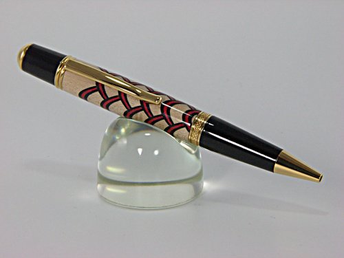

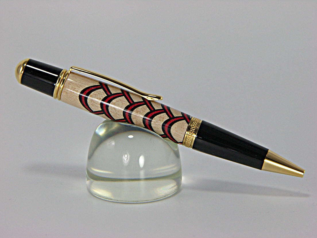

Here's one of Roy's fish scale pens:

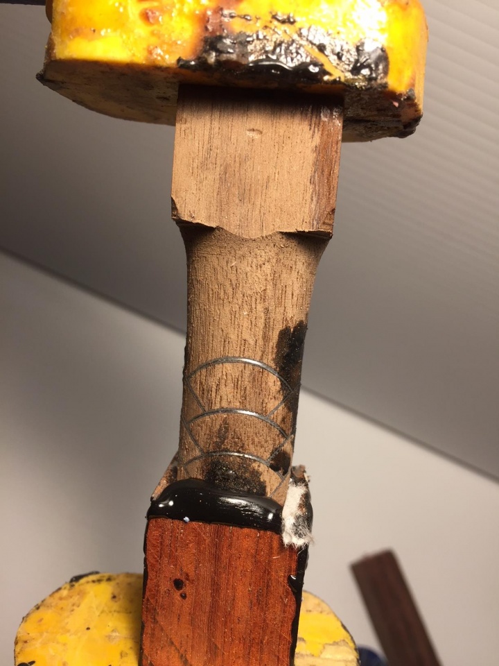

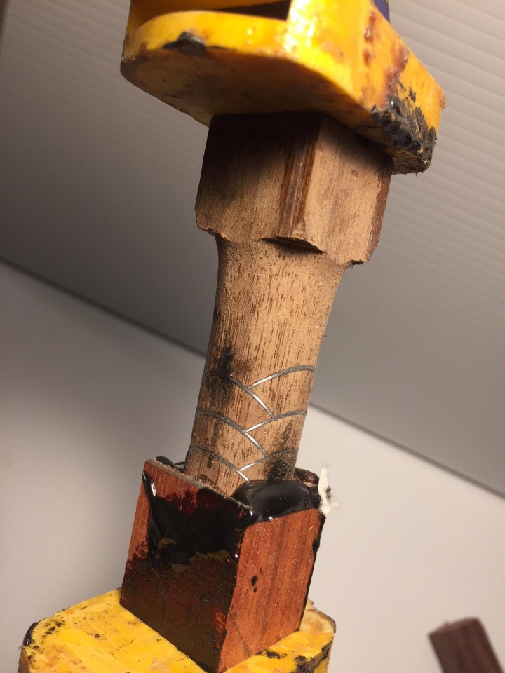

Are you looking to do something like the photos below?
