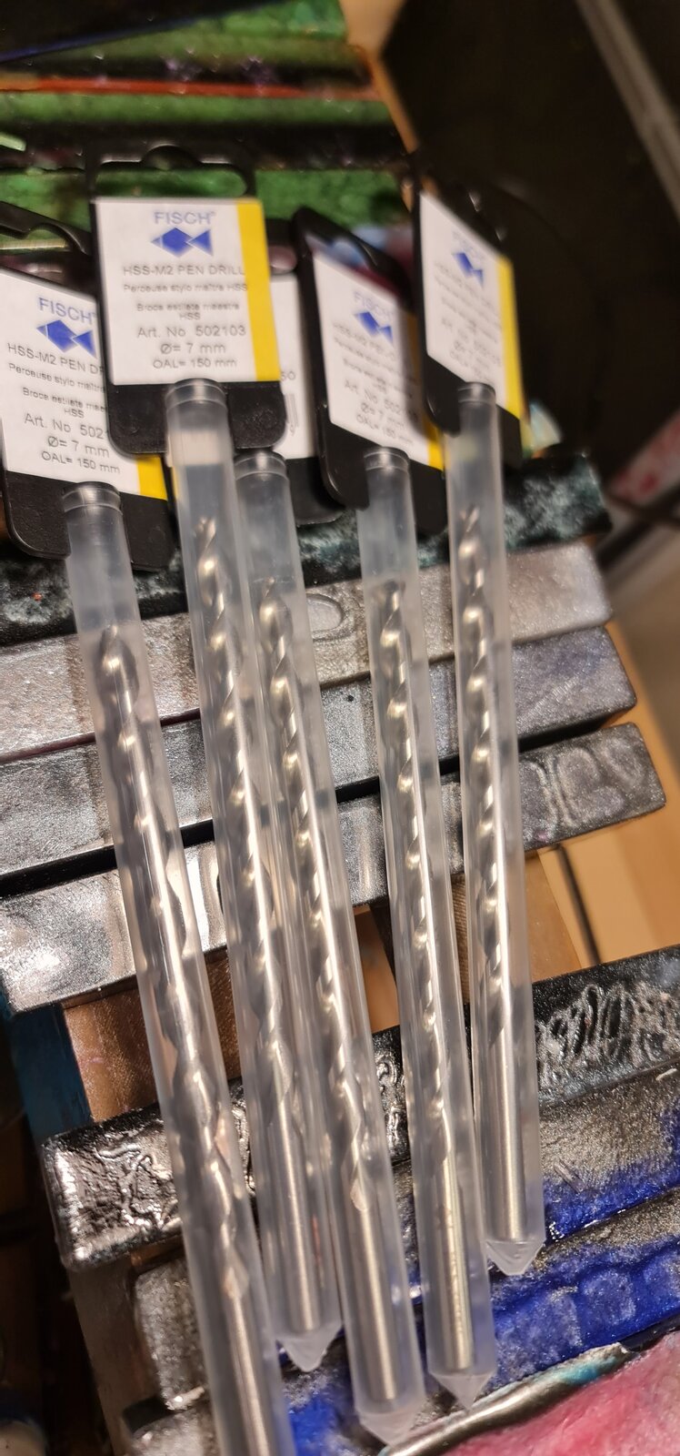

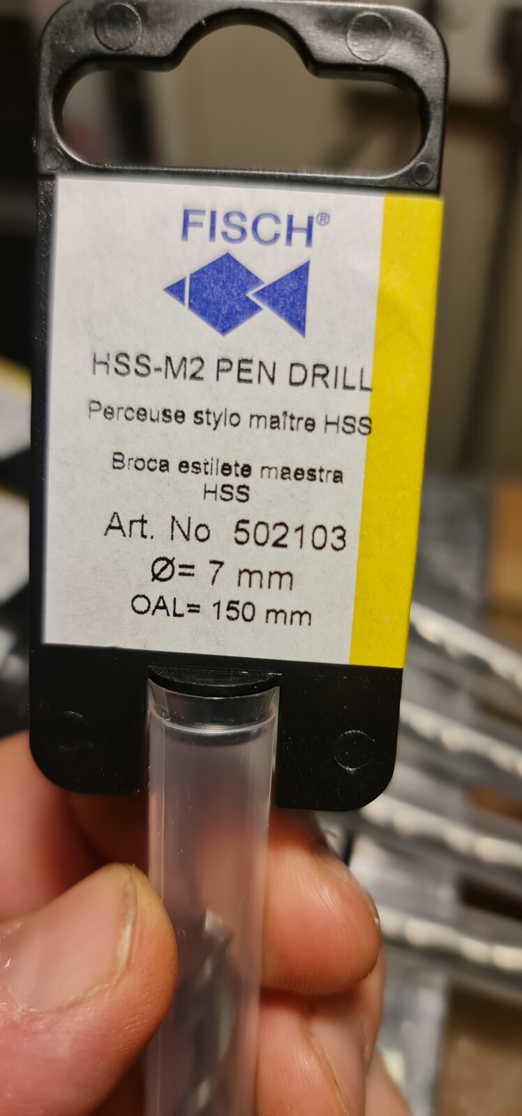

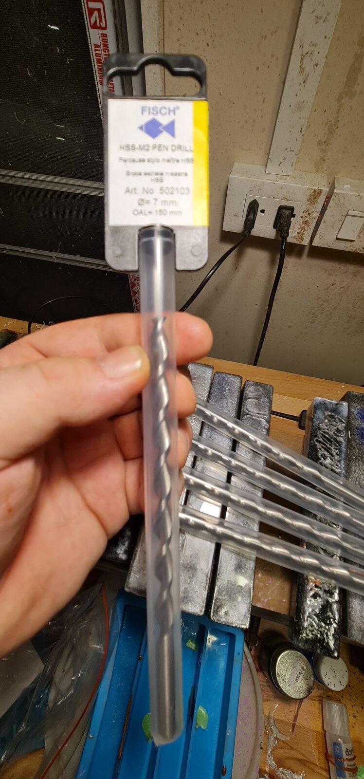

I have been through nightmares most of you would never believe/understand. I have imported 7mm drill bits from Japan, china, Australia, North America. If you are making pens with 7mm tubes these Fisch bits are the only bits worth owning.
I would love to find an alternative because these bits cost me a fortune to import. ($120USD)

Respectfully... all drill bits, even the highest quality, will get hot when drilling harder materials. It isn't a matter of the quality of the materials or process making them, it is the simple physics of friction. Of course, sharper bits will cut better with less friction and therefore generate less heat. When drilling harder materials, or those that are very sensitive to heat (some synthetics), we need to remember to go slow and in small increments and to allow the bit and material to cool in between.
Edit: Drilling speed is also a factor, so don't forget that one too. Drilling at too high a speed will contribute to excess heat.
d_bondi is correct. Got the bit at Woodcraft. Works fine. Learned early on that a bit will fuse to a synthetic blank if it gets hot without withdrawing it to cool.
I didn't want to leave you wondering if you had wasted your money on Fisch. They make excellent products, at least the ones actually made in Austria. Be aware that they also have a "Quality Line" that are QA'd in Austria but not actually made there. They are less expensive but still pretty good bits.
I have a complete set of the Fisch Wave Cutter Forstner bits (made in Austria) and they are truly excellent. I have a few of their single packaged pen making bits (also made in Austria) that are great. The 3mm-10mm set of the "Quality Line" that are what I will call Good Enough.
Another significant factor for heat buildup is the rate of feed of the bit into the material. Going too slow with the feed rate will often cause the bit to heat excessively. My experience with the more expensive bits is that they will move through the material relatively rapidly, never giving the work a chance to heat up excessively. One of several factors at play.

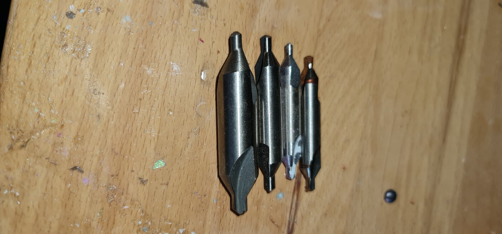

I highly recommend these bits I start the hole with a center bit and then drill dead center through 1\2" x 4 1\4" blanks.
I start all the holes with a 60° center bit. I acquired a few of them from a local metal shop.
