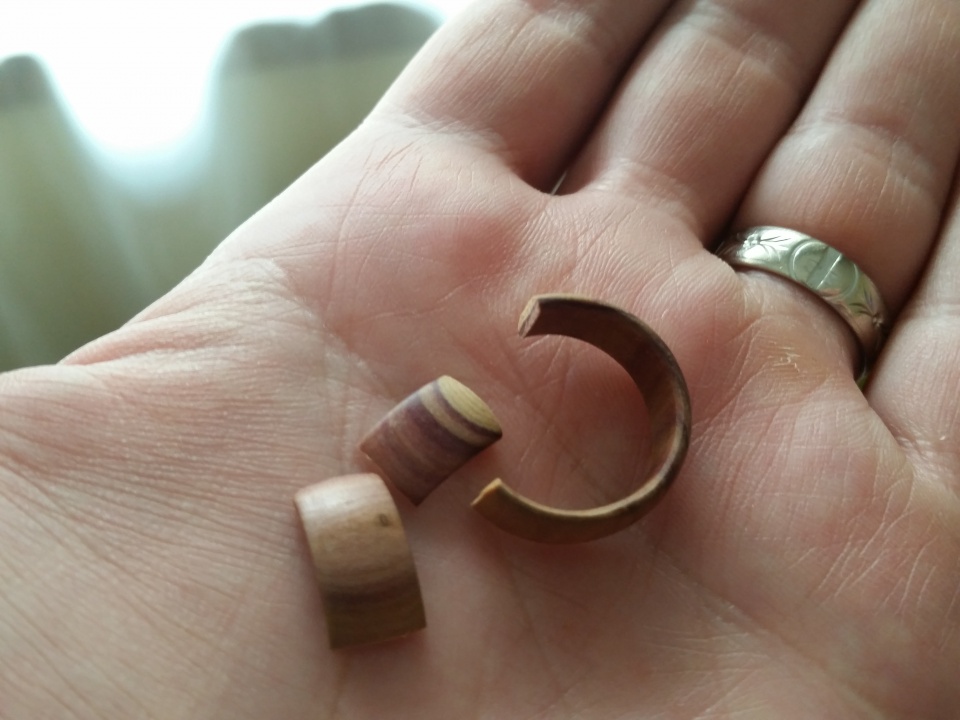

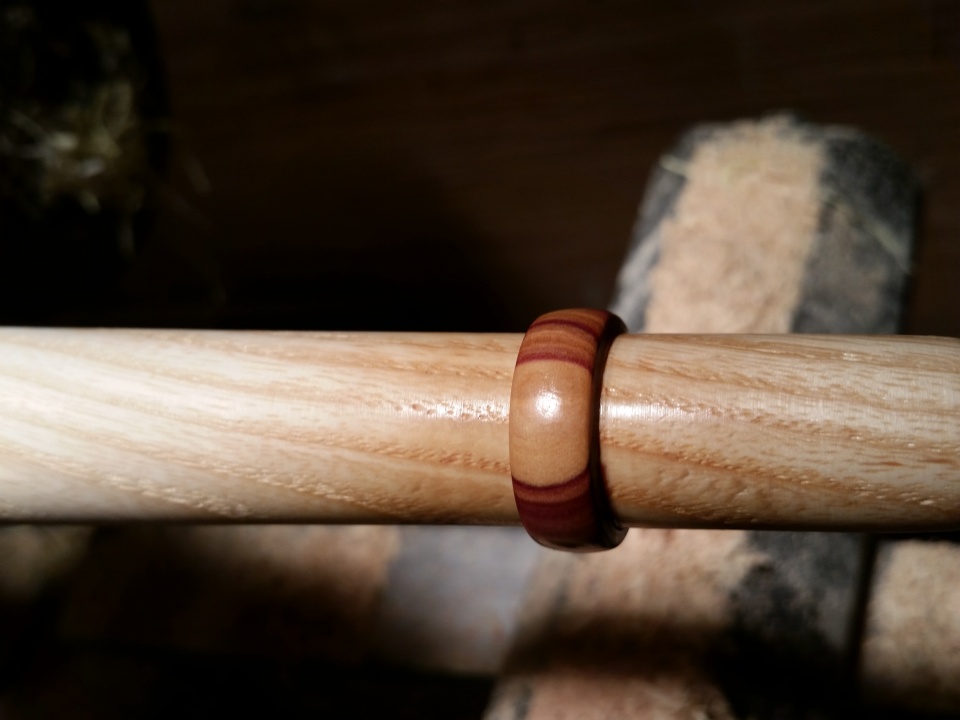

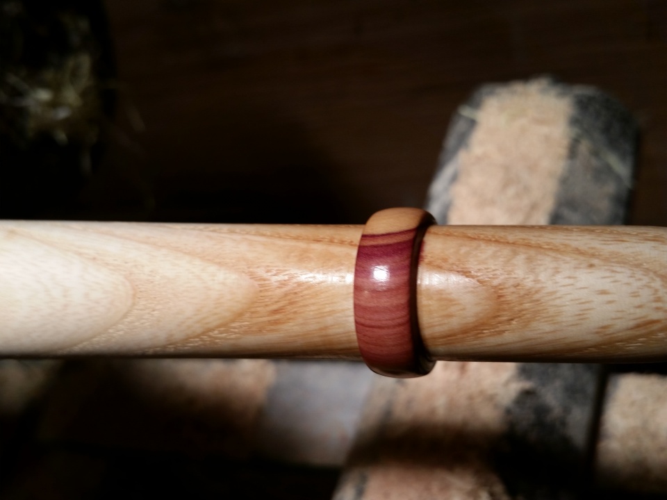

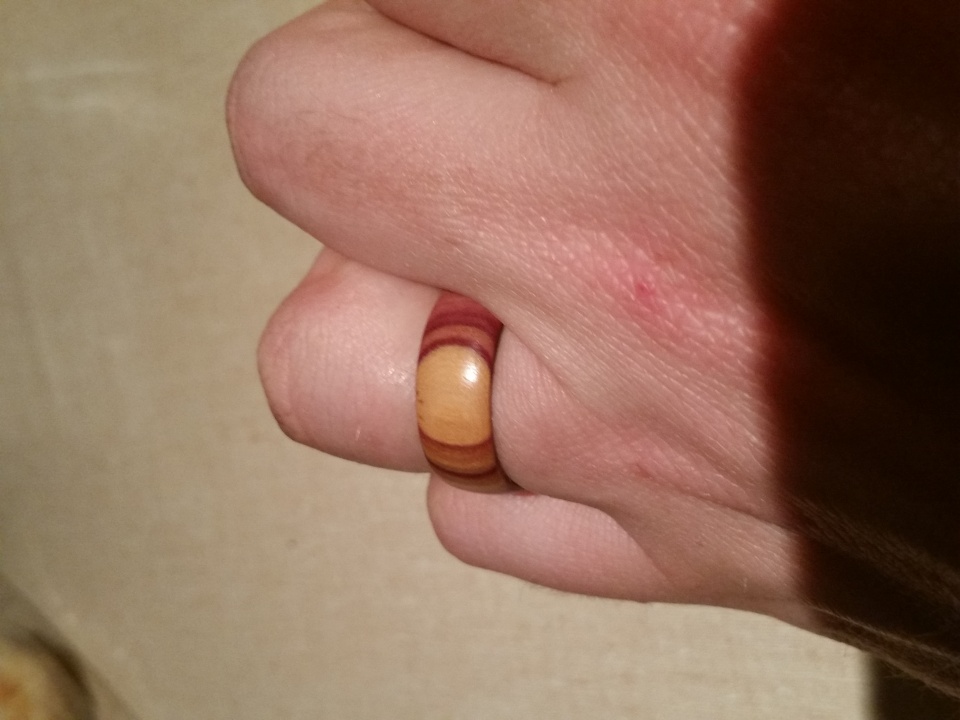

My first two attempts at making a wooden ring failed. 1 ended up having some pith in it so it cracked the next one I made too thin and it cracked. Third time was a charm at first....

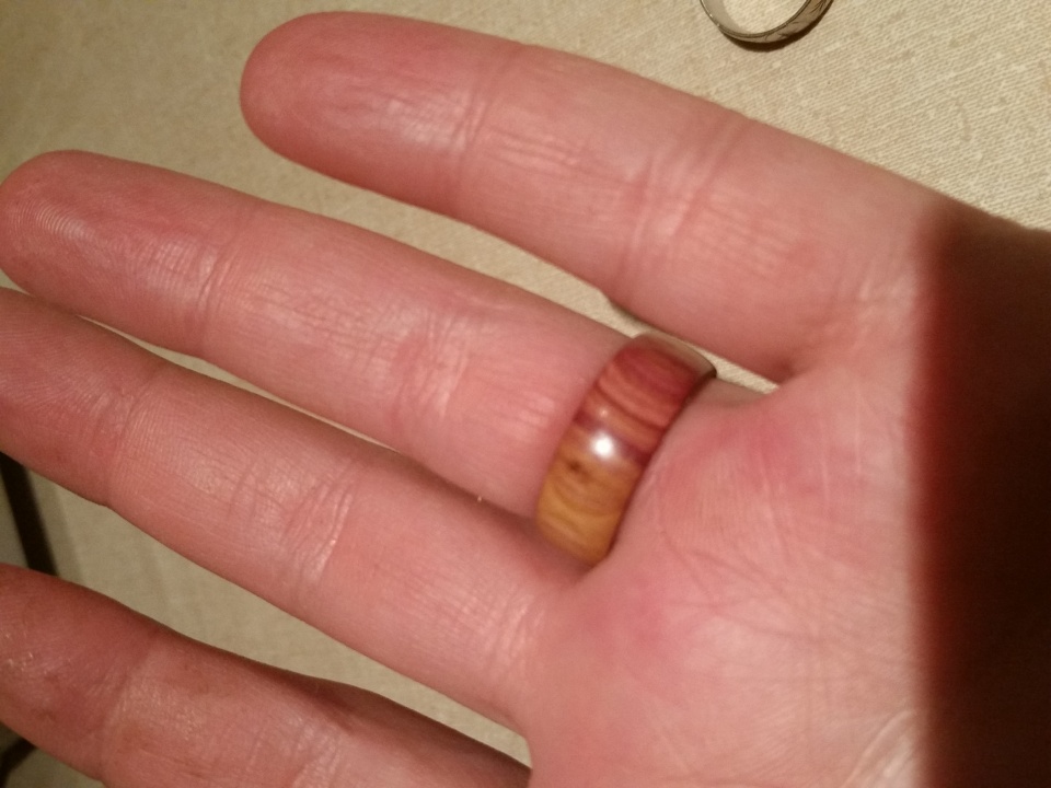

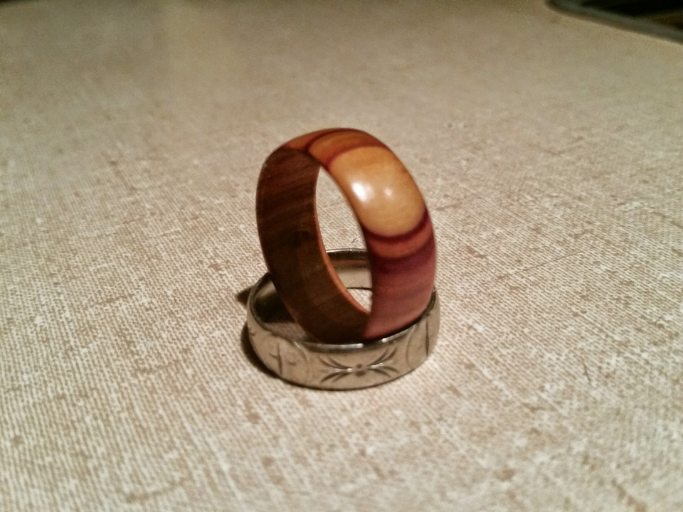

I have been asked by a customer to make a wooden ring. I figured I would make one for myself and see how the fit and finish worked and lasted. I finished this lilac wood ring with pens plus. After wearing it for a few days and playing with it a lot intentionally to see how the finish lasted, I will not use pens plus again. I think due to playing with it and the warmth of my hands helped to remove the finish or at least dull it within one and a half days.
I then put my hand in a fist and pushed my body up off of the ground and the wooden ring cracked. Granted I am very rough on things and should not have had the ring on outside while working under my car. but my goal was to put this ring to the test.
So I searched the forum and found the bangleguy.com. I love what I see on his website but I need to make a ring that is a size 9.5. It appears he only sells full sizes, not half sizes.
What's the best way for me to make a size 9.5 preferably with a metal core in it for stability. Any other websites that sell metal course? Please help.

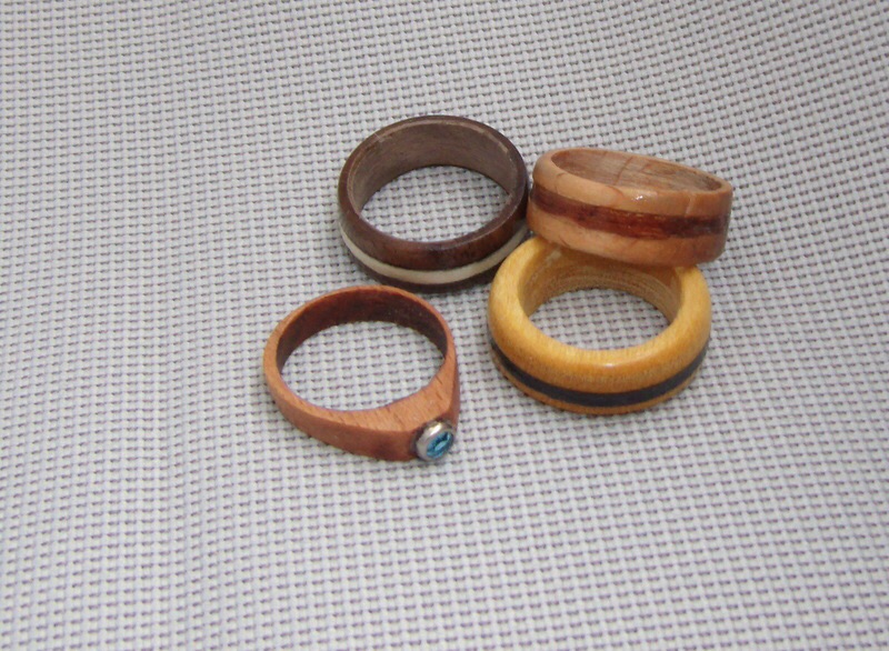

The 'trick' to giving strength to making a wood ring last is cut a groove/tenon and use a veneer strip(band) to keep the ring together. You may think that a thin veneer strip would not be very strong but in fact it creates a strong reinforcement to the ring. It also adds great contrast and a decorative effect to really make your designs stand out.
I have always attached the veneer strip to the ring with CA. Have some pics if you wish to see some of results using this method.
Glue/laminate 3 pieces together for the ring (cut the ring blank in half and stick a 1/8 inch thick piece of something else in the middle). Make sure the grain on the middle piece is turned 90 degrees from the other. That should help it hold up some.
Bentwood will be very strong. Laminated is not bad but not as strong. Laminated are minimum 3 layers glued together with alternating grain as mentioned above. Unless you find somebody that will make the core for you there aren't a lot of sources out there. I have sold probably close to 300 rings and have only had 2 failures due to breakage and I still believe they were not taken care of as they were both from a couple. They are wood and they need to be treated as such and they will last if made correctly and taken care of.
I assumed the laminated piece(s) were more for looks than strength. Making dull wood "pretty" The lilac wood is so beautiful on its own I didn't want to make it uglier by adding something to it. Looks like that is my option if no one sells half sizes metal ring centers/ cores.
What would you suggest as a color or wood or guitar pick material that might actually compliment the lilac colors instead of subtract from it?
Put a bentwood liner in it so you don't interfere with the lilac. Here is an example.
