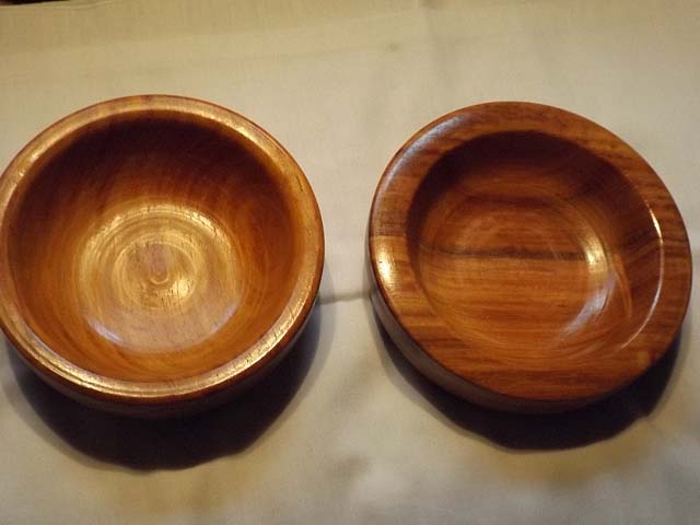

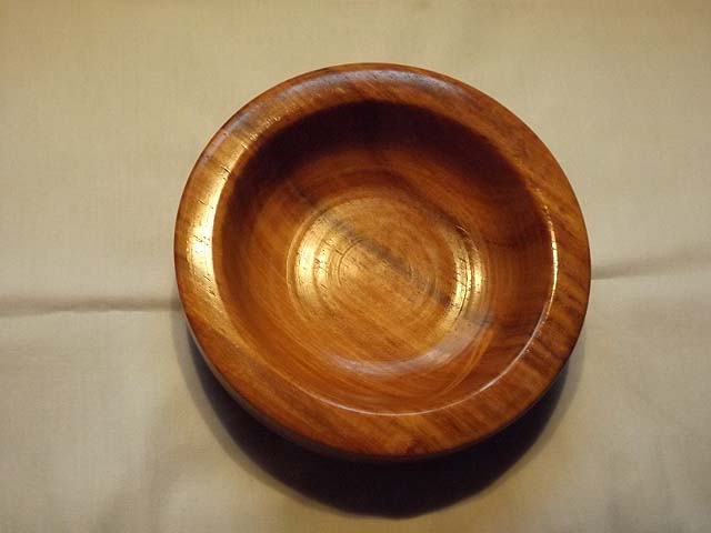

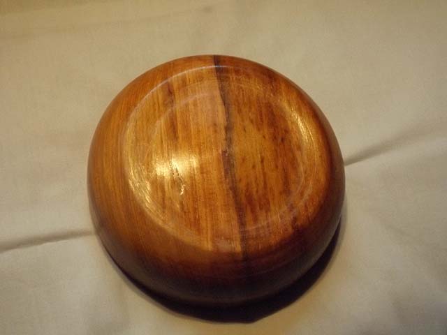

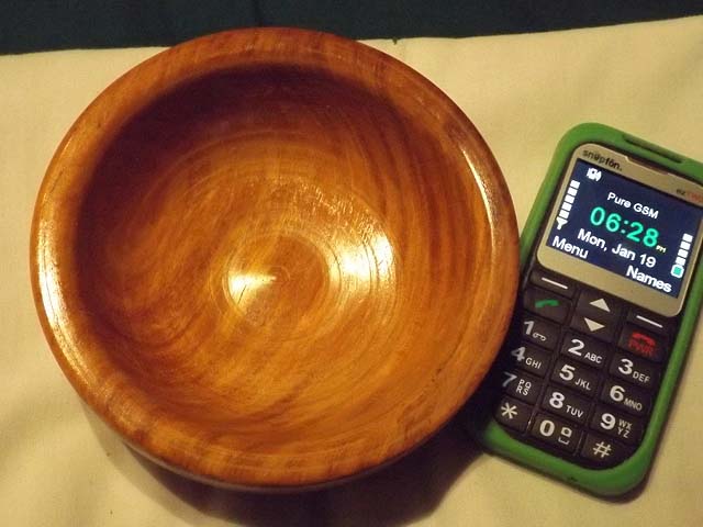

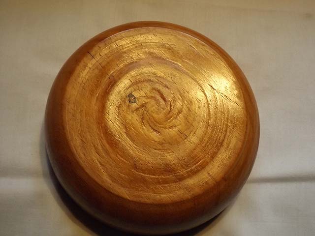

These are not t he greatest but I'm proud of what I have done so far. It will be awhile before I turn a near perfect bowl but I still had fun turning these. Enjoy. On the first bowl I found there are spirals on the bottom and did not know how they got there until I did the second bowl. It was the diamond parting tool that caused it and I was able to fix it with the new scraper that I got. So not too bad of a turn.... Will keep these to look back on as I progress.... Enjoy! Fay

A tip for checking for that bump in the center on the inside. Close your eyes, and run you finger over the surface. Your fingers are more accurate than your eyes. You may want to invest in a power sanding mandrel and sandpaper. It cuts out the marks so much easier than hand sanding. I also prefer a concave bottom so it sets solid on the table. Nice start.
Thanks for the advice on the sanders. I have a time of it sanding as my fingers will freeze due to arthritis and will stay that way for a few minutes at a stretch and it hurts when ever they do that. I think the power sander will help a lot. I will look into it and if I have enough money, I will get one and extra sand paper to go with it. I didn't tell you on the first bowl, I got some deep catches and was not sure I would be able to work them out. I did get them out and the middle was a bit hard to get and get it flat and smooth. Now that I have my Wolverine set up and the new scrapers, I might be able to get that part better than I got it and I'm planning to change the shape of the next bowl I turn. I think these are too steep of a shape and will work on getting a more slanted shape so it might be easier to get a better bottom done. Will order more bowl blanks and see how well it will go. Thanks for the nice compliments on my bowls... They really are not too bad and a great job on the first try. Fay

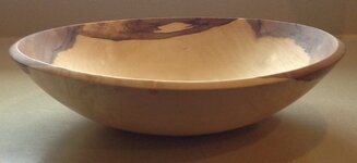

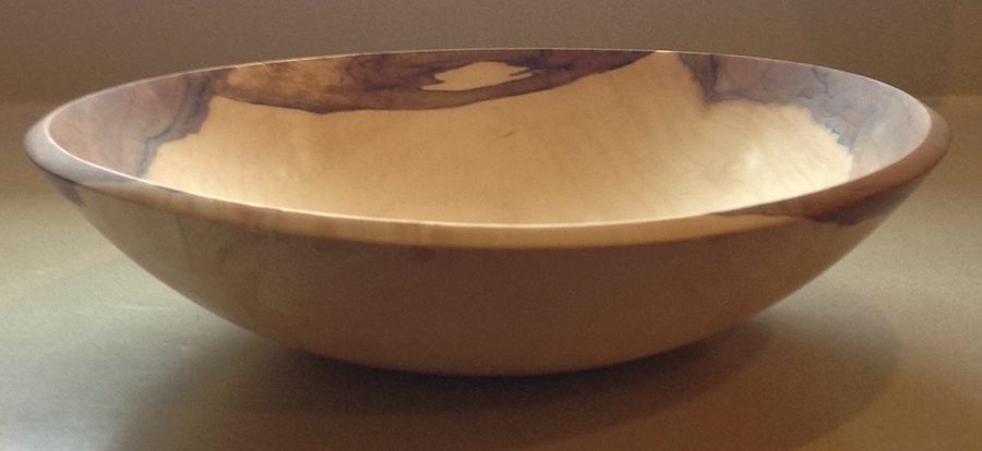

I really do prefer a more conical shape, but thought I had made plenty of suggestions already. To give you an idea, here is the last bowl I did, a 14" soft maple with walnut oil finish.

Great Start with the Bowls Fay.
Circular Grooves in the Bottom are an Occupational Hazard.
Depending on the material you use, some you can remove easier than others.
The best way of course is not to put them there in the first place.
It may sound easier to say than to do, but a secret is to try and make your final cuts with your Bowl Gouge in a single uninterupted movement, rubbing the Bevel all the time, and ending at the Centre Point where the Nib wants to form.
If there are still some minor ridges, then use your scraper with the trailing edge raised but still in contact with the timber, in a Shear Scraping method. This will produce very thin curls from the High Spots on the base, and reduce a lot of sanding on your part.
Again as has been previously mentioned there are some great Youtube videos on Shear Scraping, as well as using a Bowl Gouge.
