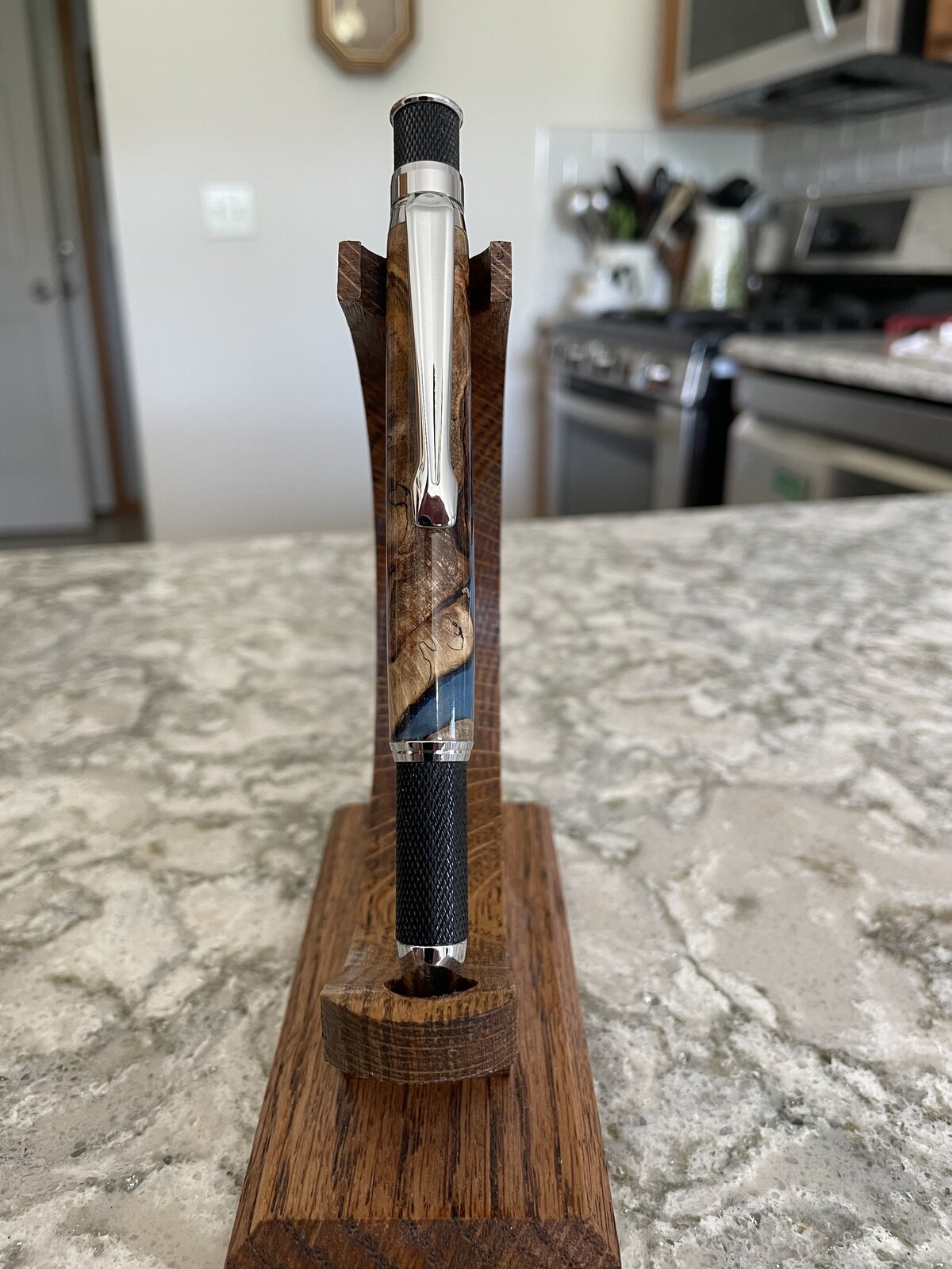

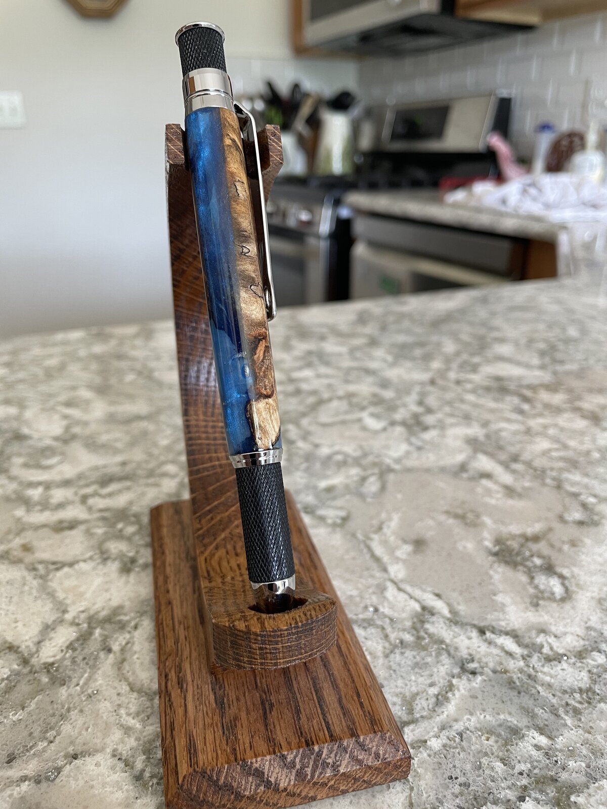

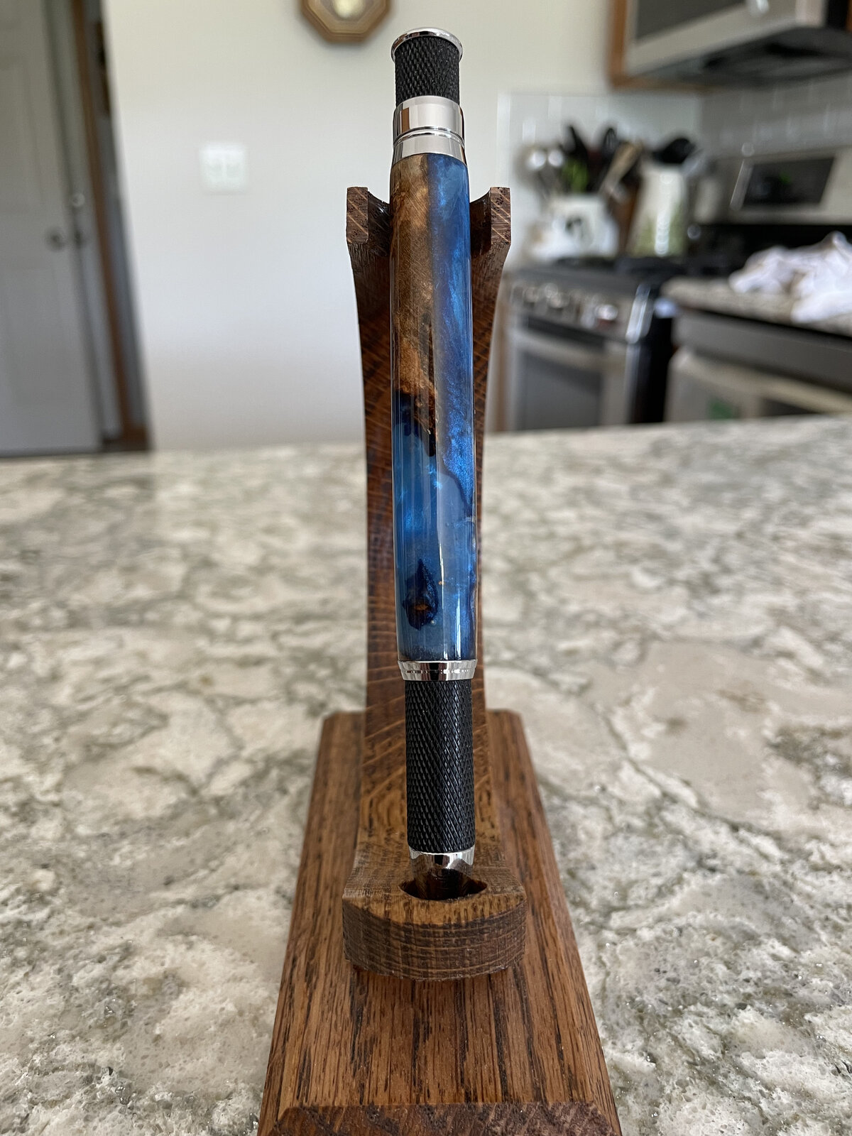

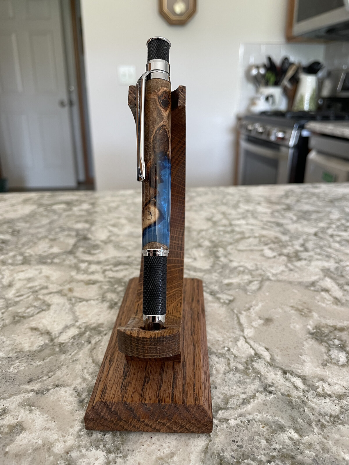

This didn't turn out half bad from someone that didn't know what they were doing. No pressure pot just very slow and careful mixing. I have a bunch of small worthless cut offs from the maple burl I recently cut up. Figured I had nothing to lose. The resin is just "Amazing Clear Cast" from Hobby Lobby and some mica powder also from Hobby Lobby. I am thinking about buying some Liquid Diamonds resin to use in more of the cutoffs. I really don't want to invest in a full scale casting setup. I just want to be able to use up cutoffs in a creative way when I have them. I am very happy with this pen and it just goes to show, you shouldn't be afraid of just trying new things. I'm sure there will be some telling me everything I did wrong. Bottom line, I'm happy 😃 Also I made my own mold.

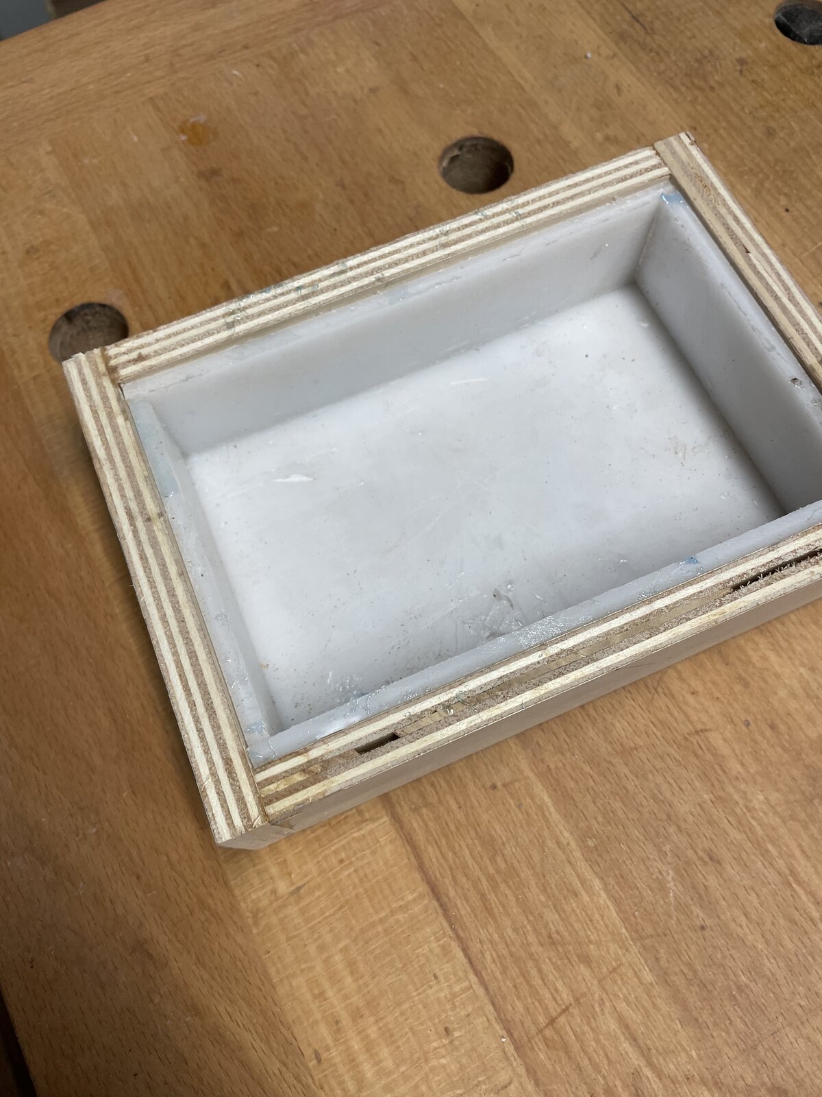

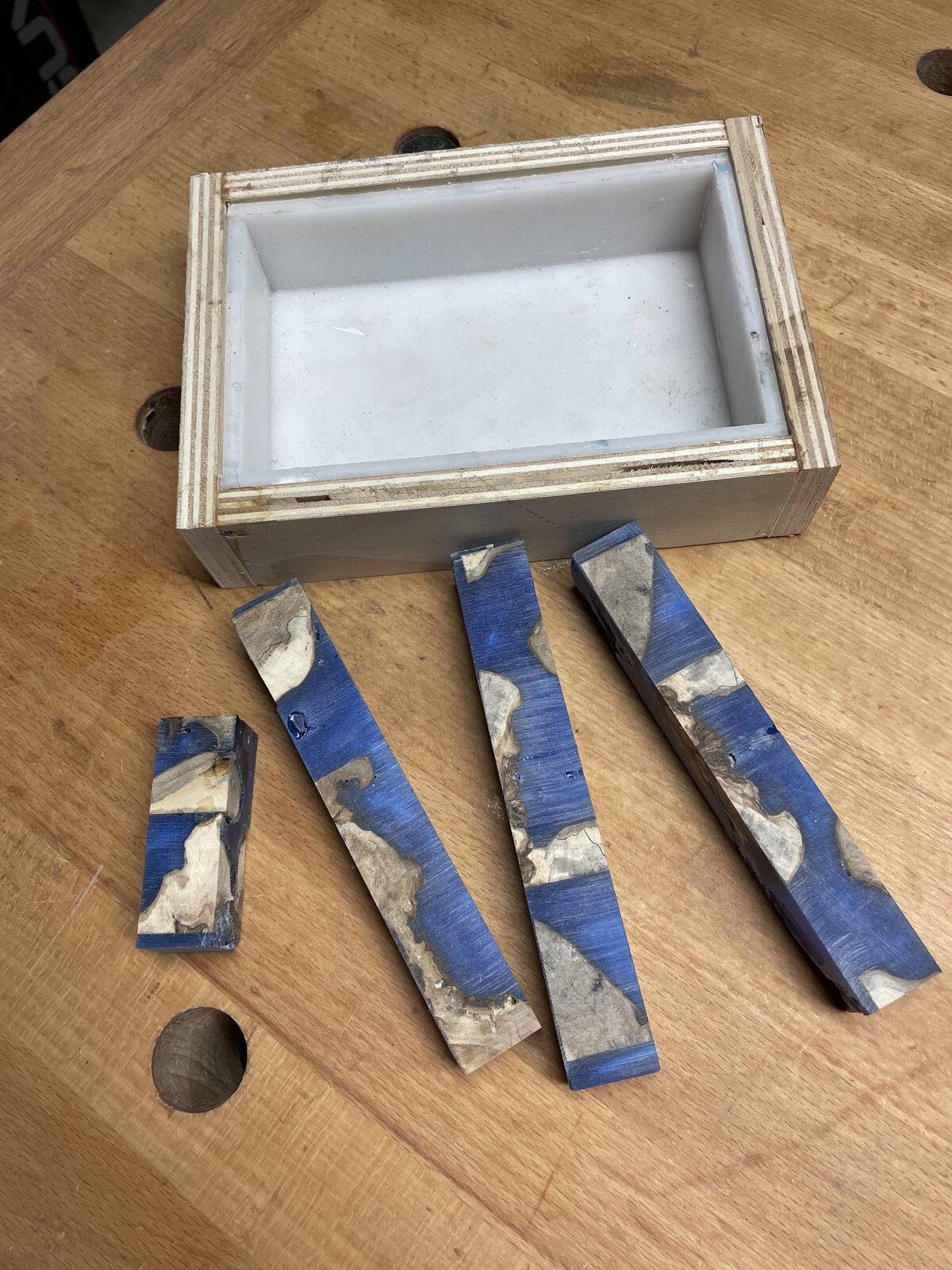

Here's the mold I made. Just cut some HDPE plastic sheets that I had to line the box. I used hot melt glue to seal the edges and I hot glued the wood pieces down. Mixed the resin very very slowly and poured it in. I got 4 blanks total from it.

Ken, I did indeed make it to Hobby lobby, and bought some of the same epoxy resin, and some powdered pigment. I do have a question for you - did you coat the inside of your mold, or line it with anything, or did you just use the HDPE sheets as-is, and the epoxy didn't stick to it? I'm just wondering (before I give it a try), how easy it was to take the cured block out of the mold. Thanks for any advice.
Kevin
Kevin
It stuck somewhat to the hdpe, but was able to pry it off. Next time I might try some sort of release agent.
