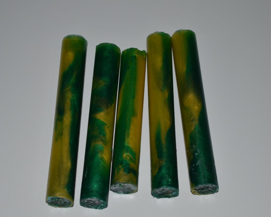

I've sucessfully clear cast, but I wanted to try color casting. I went two color, PR, no pressure pot, and PVC for molds.
Green base color is Castin' Craft dye, with spring green Pearl-ex mixed in. Yellow base color is Castin' Craft yellow dye, with bright gold Pearl-ex mixed in. I bought a sample pack of Pearl-ex on sale, so I have plenty for experimenting.
I took notes, but I doubt I'll be able to replicate this color combination. Instead of drops of dye, it mostly drizzled out. I think the PR resin might be on the old side. I bought it almost a year ago on sale as part of a kit at a woodworking supply store, so who knows how old it really is. In my zero experience, I waited 20 minutes after 4 drops per oz. of catalyst. I think I could have waited a minute or two longer. My swirl wire didn't have enough twists, and I didn't want to risk stirring them together.
Round two is below.

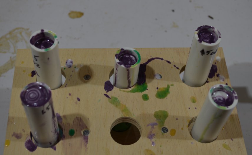

I think you might get where I'm trying to go: Green and Gold, versus Purple and White. I'm gonna place them side-by-side and let them duke it out. :devil:

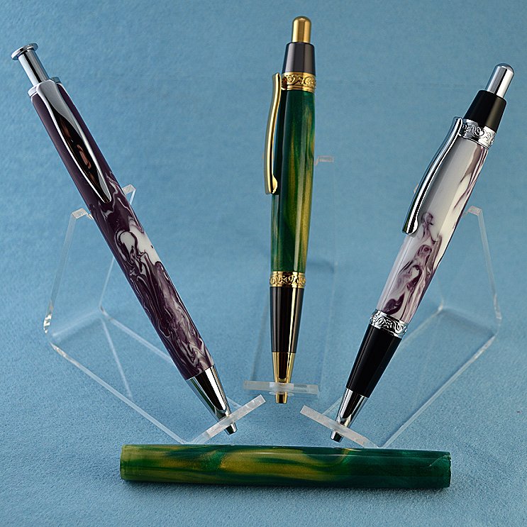

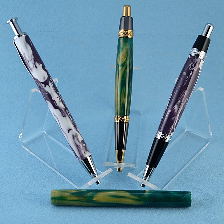

I think they came out okay.
Front view of "Purple Pride" on a Chrome Long Click, "GreenNGold" on a Le Roi Elegant click Long Barrel, and "Purple Pride" on a Le Roi Elegant click Long Barrel. The other "GreenNGold" was supposed to fit on a Gold Long Click, but I fumbled, it hit the cement floor, and it cracked on the end. :mad:
Back view:
I need to work on my swirling technique, and maybe pour a thinner stream so that I don't have the large areas of color. I didn't notice any bubbles, so that is good.
Comments and suggestions are welcomed. :smile:
I think your swirls are fine. And your color separation is outstanding. If there is one thing I'd do is to switch the colors to the other hand when you pour so the colors are distributed a little better. For example: If the purple is in your right hand, and the white is in your left. About 1/3 of the way, switch the colors to the opposite hand, and continue pouring. then do it again after about 2/3 of the way. Also, rotate a little to get the colors all the way around the blank. It's easier said than done. But I think those are very good. :good:
