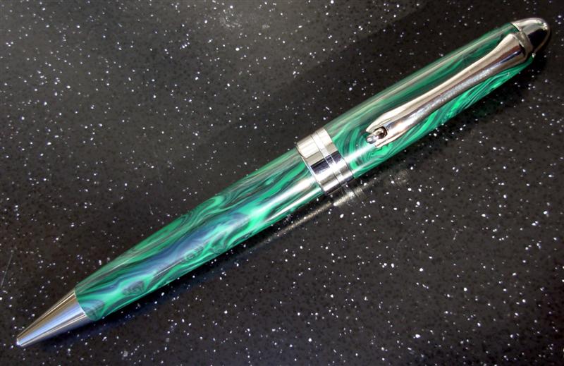

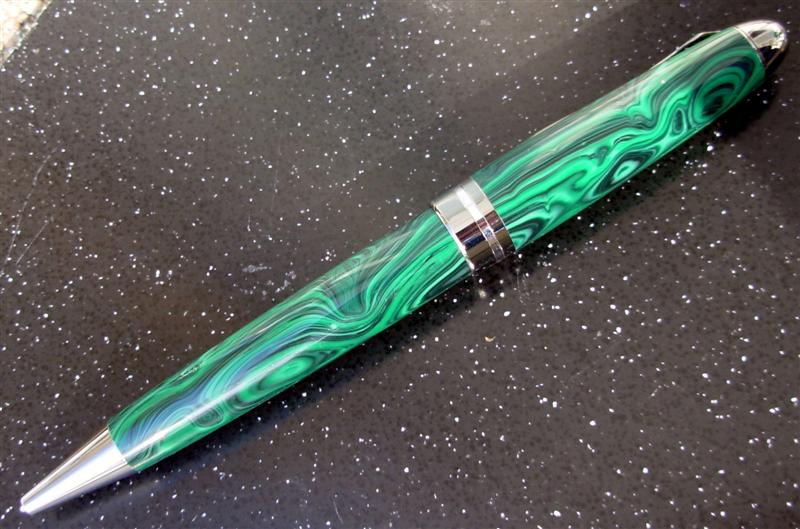

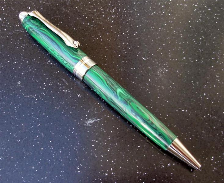

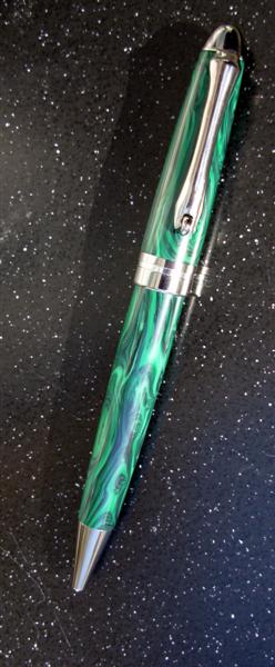

Here's a black Ti Neopean from Lau Lau, with Malachite Truestone. This was my first time turning truestone and it didn't seem all that bad to turn. I was really happy with the way this one turned out. Sorry for the bad pics.
As always Thanks for looking. Any questions and comments welcome.

I've always had a soft spot for malachite. :biggrin: Sometimes I think I should have been Irish cos I like green so much!!
Nicely done!!:biggrin:
These realy make beautiful pens. Great fit and finish on this pen. Also nice photo. This material is not easy to turn, but you did an excellent job here. Jim S
Looks great! Not all trustones have similar turning properties. Generally, malachite and turquoise are very friendly. However, I recently got into a batch of malachite that was every bit as hard as lapis typically is.
