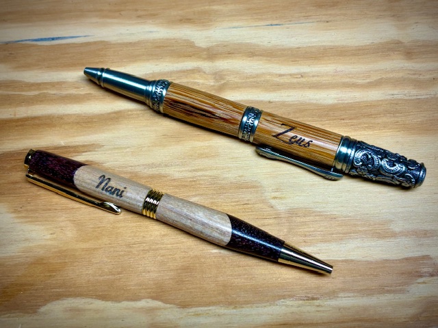

Thanks to @Cwalker935 's thread from a few months ago, I grabbed myself a cheapo Laserpecker LP1, just for personalizing pens. Today I turned these (PSI Trimline and Victorian) for my sister and her hub, aka Nani and Zeus to their grandkids. I'm very pleased with how they turned out.

I know there is a rule of thumb
about which side to put the names
on the pens, has some thing to do with
which what hand you write with
But a can't think of it right now
It may be in the library
They turned out really nice
I got both angles covered. 🤣 (quite by accident). Between the first one and the second one I forgot the image comes out upside down from the position I had the laser thingie in. I'm sure I'll forget again. If I had to guess, I'd say the Zeus pen is correct for right-handers, since the letters would be approximately correctly oriented if holding the pen in the right hand.

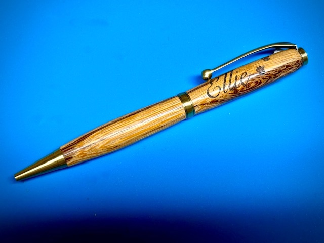

Here's the latest one I did for my wife. (Those are paw prints after her name.)
