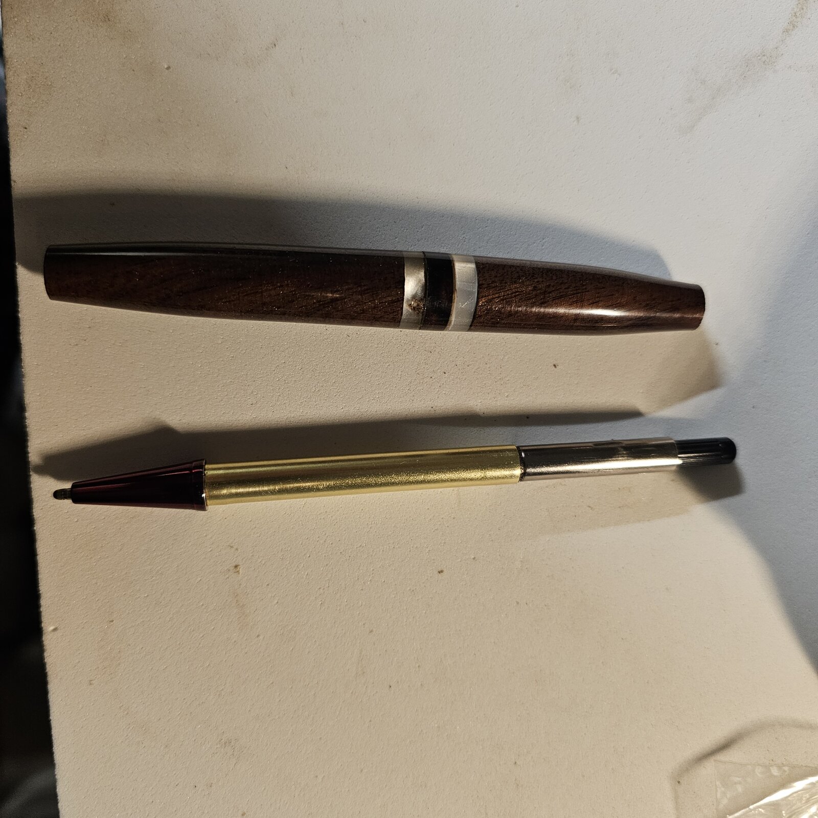

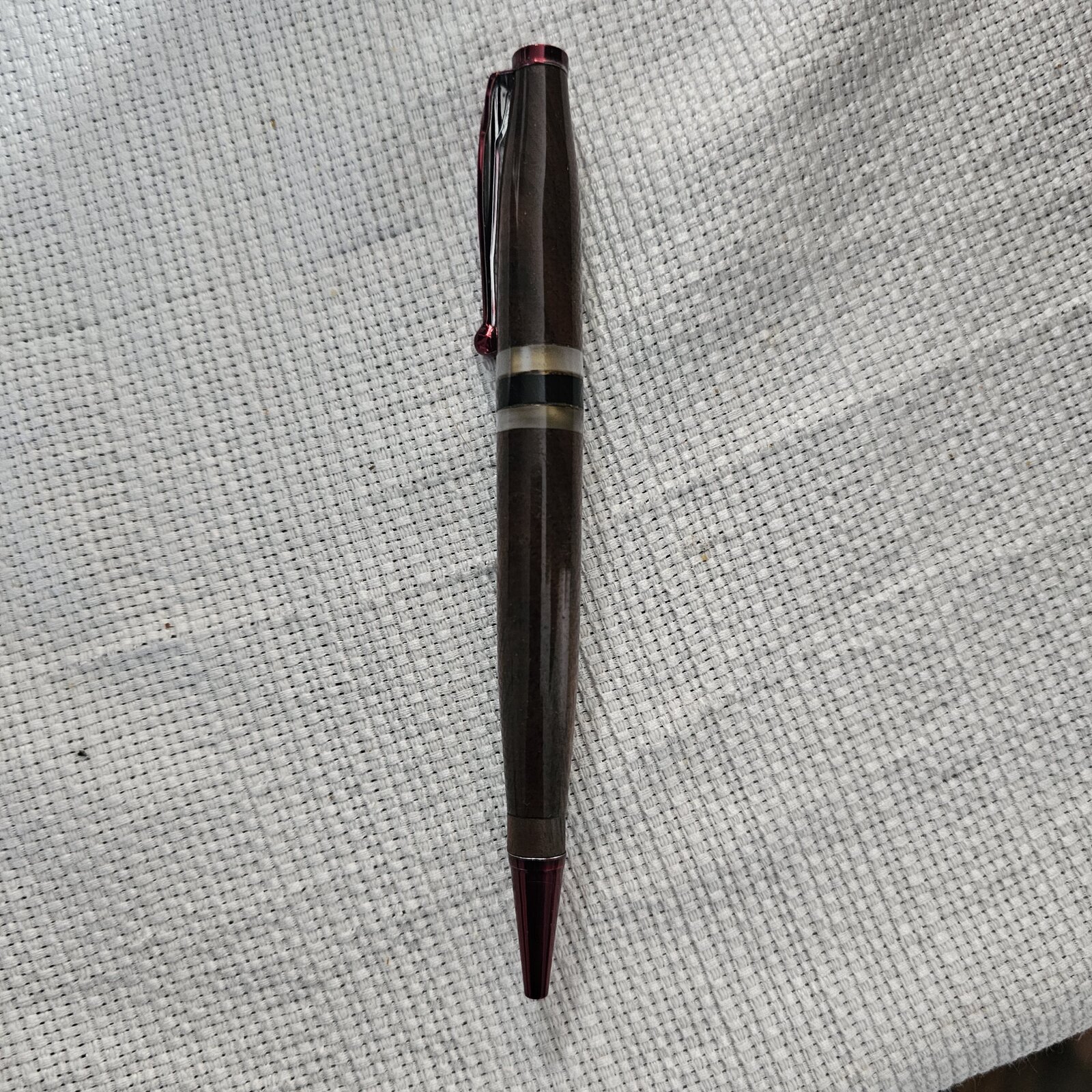

Ok I endeavored to make a modified slime line and I really like the way the blank turned out the problem is when i insert the bottom part of the pen, it does not turn and its hard to twist and pull out. I have to use a pen punch on the opposite end to pull the bottom part out.
What did I do wrong? I followed RJB Wood turners instructions and compared them with Sleeve Leather and it's the same thing.
I'm not sure what to do, I can assemble it and just leave it ready to write lol.

The blank looks great!
I see how frustrating it must be to not have it "work" the way it should.
Does the Twist Mechanism turn freely when you have it disassembled, or is it stuck there too? I once had a *bad* Twist Mechanism that didn't turn.
When the bottom is not inserted the mechanism turns fine, as I inserted It, I am testing it and it turns. As soon as I insert the whole thing, that's when it does not turn at all and it's also hard to pull the bottom out.
Thanks!

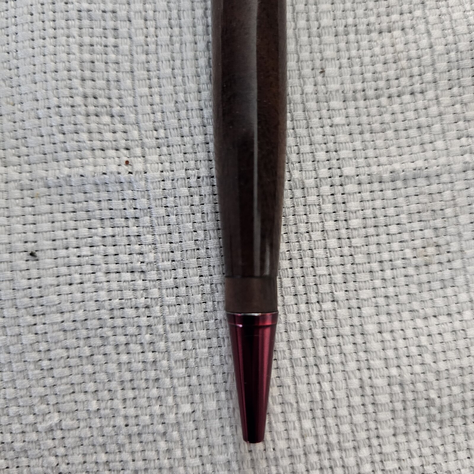

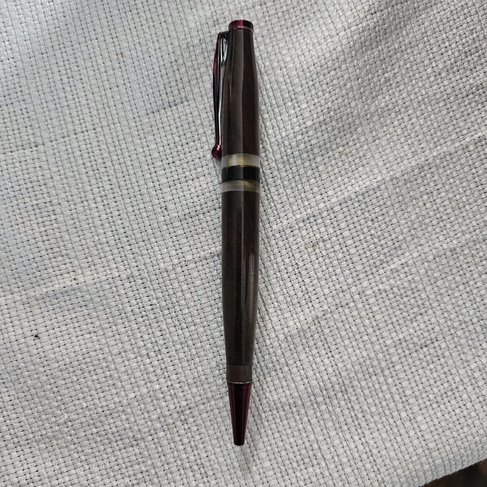

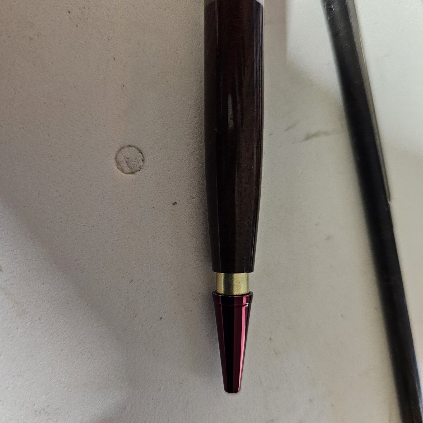

This is as far that it will go in before it stops turning. I've noticed that pushing it all the way in, it get very tight. It doesn't just slip in, you do have to out a little pressure and you can't just pull it put.
I have inserted the drill bit and have twisted it inside to clean out any debri, not hitting or touch the glued barrel.
What a disappointment lol. 😞

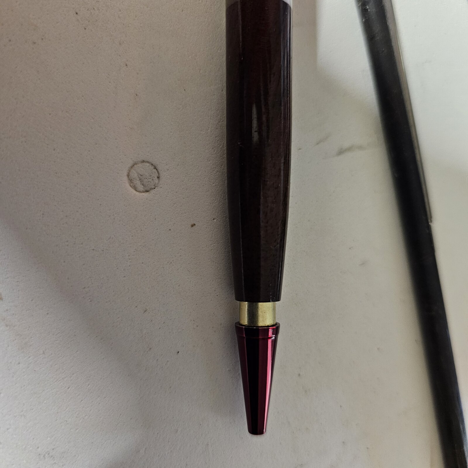

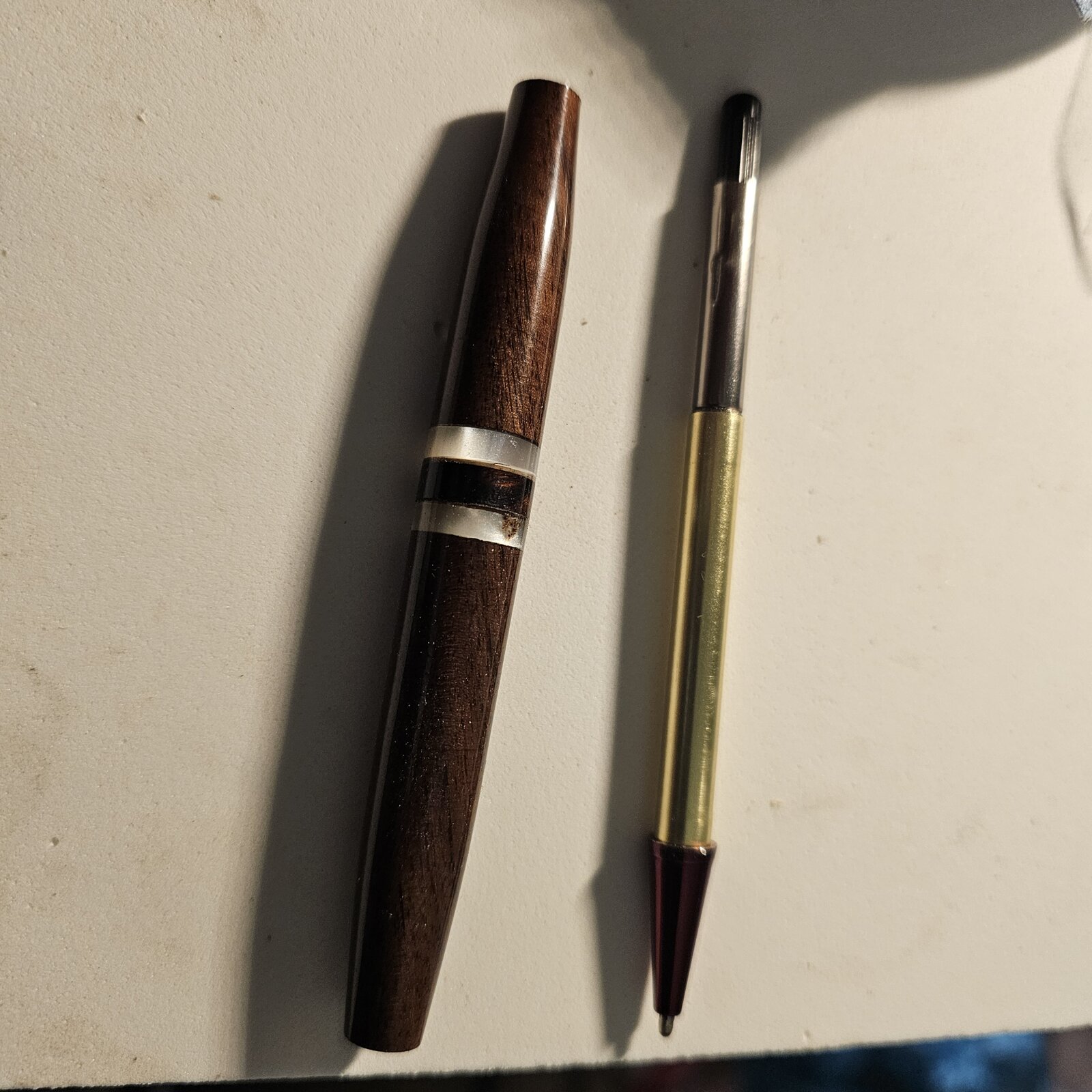

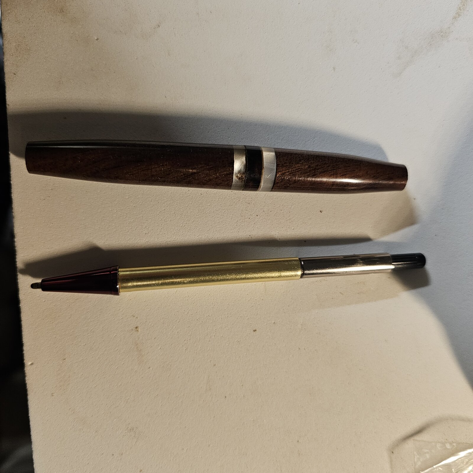

Well I had to improvise! you will see I had to add a small piece above the nib, That's was the sweet spot in order for it to engage and disengage. That's quite a bit of barrel that would have been exposed if I hadn't improvised. Well back to the drawing board and I'll make another one.
Thank you for y'alls help!

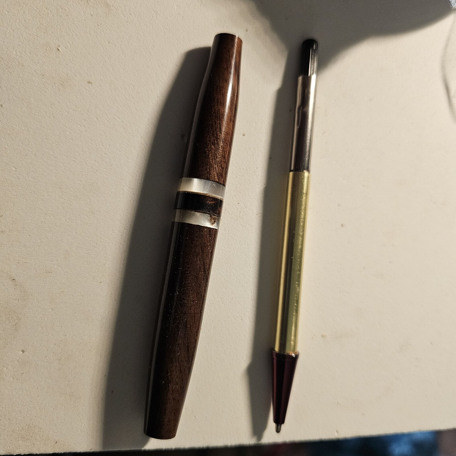

It sounds to me that something in the barrel is grabbing the tube when inserted to that specific depth, maybe even just some glue. You may have already checked this, but I would use a small rod or a bamboo skewer to poke around inside the blanks to see if there is a catch somewhere up there. Maybe it's a simple as filing a nub of something out of the barrel?
Having made several one piece slimlines I thought of a couple of issues. One is what Todd mentioned. Another was the total blank length was too short but this seems to not be the problem. Another is the upper tube is longer than it should be or it is glued in place incorrectly. When the upper tube touches the lower the drank cannot go on any further. Fortunately Lee seems to have solved this.
Do a good turn daily!
Don
I did all of that, and it didn't seem that anything was obstructing the tube.

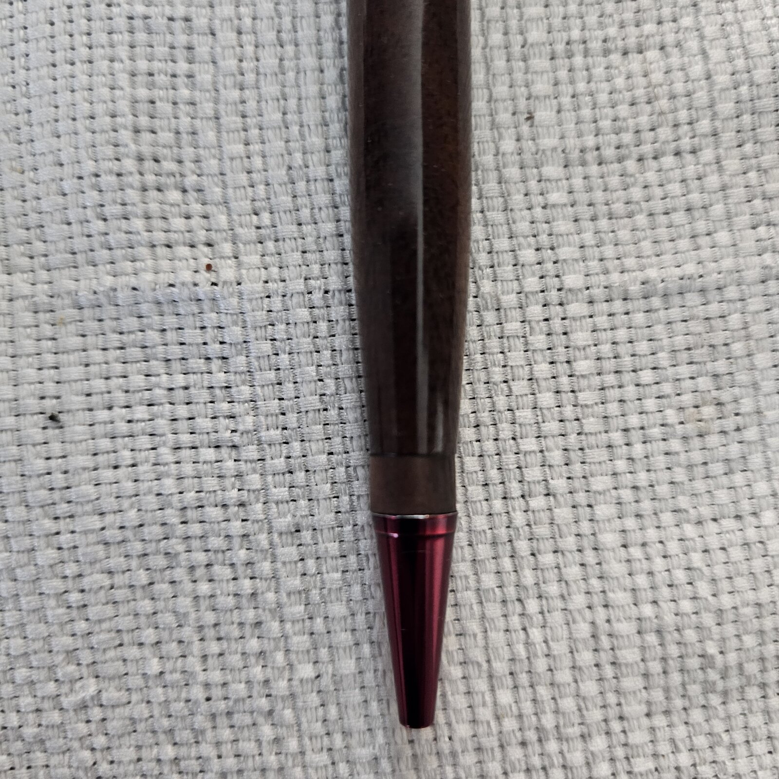

Just a thought Lee. It may be the run of the weave in the background cloth in the photo but I see a slight deviation from 180 degrees between the upper and lower parts of the pen and the slight deviation would cause the internal workings to be snagging.
Is it possible that one of the blanks is not fully square?
Just a thought because it has happened to me!!
Mike
Mike
The bottom part was added to make it work if that's the part your referring to. I'm thinking something went nuts inside the pen where both tubes meet..
