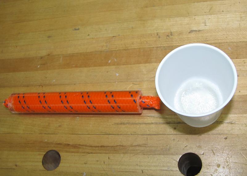

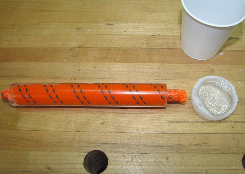

Alumilite is best used where it can cure while under pressure. The curing process of Alumilite generates small, near microscopic bubbles. If you did not have the trial casting under pressure, minimum 40psi(I use 60psI), what you may be seeing in the white color is all the millions of bubbles the curing process generates. The applied pressure keeps the bubbles in solution and results in a clear casting.

The difference between pressure and no..
I cast this blank a couple days ago. It cured under 60psi pressure. I left the remaining tablespoon or so in the cup sitting on my bench. You can see the results of no pressure. Don't know if what was in the cup is as white as you experienced but it is definitely "whiter" than the blank.
