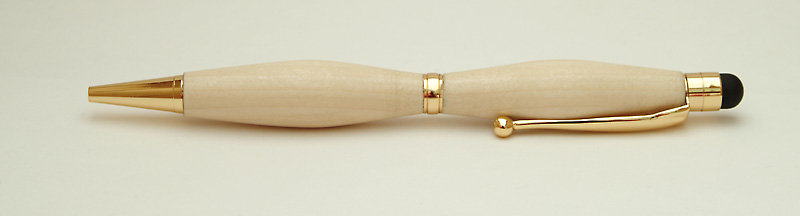

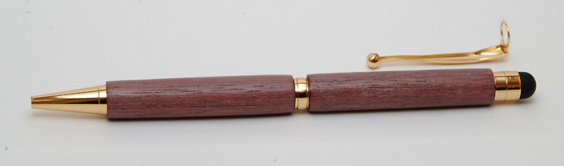

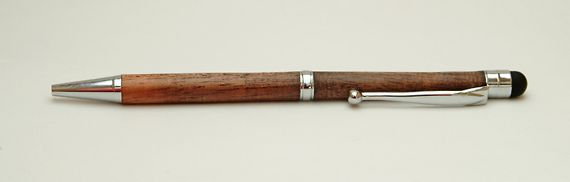

About a month ago I picked up a lathe and then the number of must have's (and some extras) to just be able to start turning pens. Rob from New Orleans sent me a box with more blanks that I would know what to do with... but I will find a way. Along the way, I shot a MT2 out of a chuck drill while spinning on the lathe and through my wife's windshield. Ouch. After a terrible bout with the flu and work that constantly got in the way, I've turned my first 3 pens. It has definitely been a learning process but I feel like I am making progress... and having fun at it too.
While making the 1st pen (purpleheart), I was afraid of taking off too much wood. On the 2nd pen (mahogany), I overcompensated and then on the 3rd pen (poplar), I was just having fun.

Now you got the fever...Keep them coming. Make sure you keep these and look back at them every 6 months and you will always smile and be proud!
I don't remember who said it, but buying a digital caliper at HF was the best investment I made. I measure the components of the pen kit and then match the blank to the measurements.
Thanks. I'm glad to be making the mistakes because I'm learning. I did pick up a digital caliper before I made the 3rd pen and I put it to use (I dunno good use but I put it to use). And from reading I've learned to not so much turn to the bushings but rather the kit that I'm working with. After the 2nd pen... the digital caliper was a must!
Nice start on the pens.
Caliper is an excellent suggestion. I use my grandfather's that is not digital, but I still use it because it was his. I turned a slim line yesterday and it was actually a little more difficult than the others I've done. I wanted everything absolutely straight and I was turning it down much thinner so didn't want to make mistakes.
Yeah. I inherited some of my dad's tools that he made (including a couple of calipers) and part of me wants to use them while the other part wants to leave them alone and admire them.
It did seem much easier to do that 3rd pen which is curved, rather than the first 2 which are relatively straight.
Nice start.
