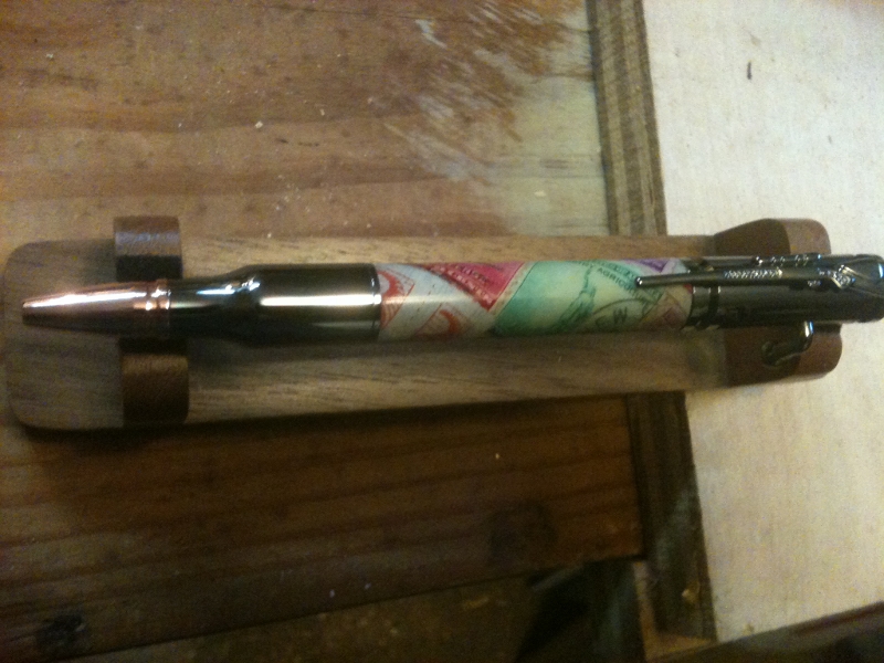

It wasn't until yesterday that finally got my hands on a Bolt Action pen. Looks pretty simple only to components to press into the tube.
then that over length spring... So Should I be more. perhaps the proper word would be respectful for this or just take care of business.

Final Thought
It twern't nuttin to have worried about after all.
