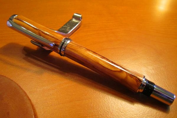

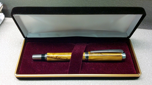

The pen is a BOW on a Navigator kit. A co-worker asked for a pen for his father-in-law, who is a pastor. So the natural blank selection was BOW. My first time working with BOW, and I have fallen in love. What a beautiful wood. Knew the best finish would be CA, which I hadn't tried yet. Well after a bit of practice, and couple failures, this is the end result. So thankful for the great info on IAP and YouTube on CA finishing; just wished I had gone through more of the posts before I started, instead of going back to see how not to do (or how to undo) what I just did :eek:
Sorry for the poor pictures. Any and all comments are more than welcome, and thanks for looking.

Nice pen and congratulations! It is such a rush to sell the first one.:smile:
You really made that BOW sit up and shine. Great job!
