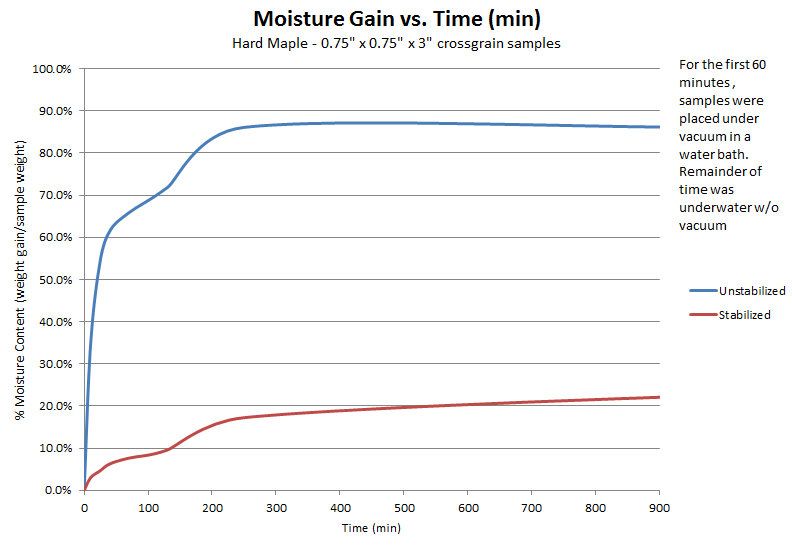

I will only say that the cactus juice is an awesome product and I have used about 3 gallons so far this year. I stabilize to make sure that my bangle products will be resistant to moisture absorption and that the wood growth/shrink is minimized. Here is a chart showing the positive effects of stabilizing for moisture absorption;
That is some great information Eric. I didn't think of the effects on moisture which is also a concern with pens although probably not as much as your bangles. I checked out your Etsy site, very nice.
