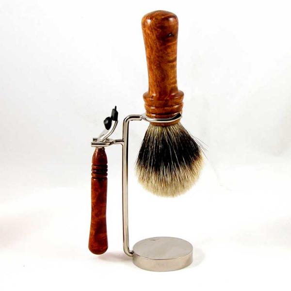

A year ago I bought the Knot and Mach 3 head from Anthony at http://www.thegoldennib.com/
it's a 22 mm best badger if memory serves, done on some Amboyna Burl
Comments welcome,

Nice! Will the brush hang with the hair down? I think this is important for drainage.

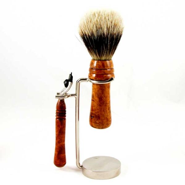

Ken, nice work,love that Amboyna. If i could say one thing. I have been making them for the past year and i learned one thing in the way the set looks best when hung on the stand.
When turning them place the curve at a midway favoring towards brush so it isn`t top heavy when hung brush down. Then also put a curve midway in the razor handle, favoring the head so that when hung on stand head down it would be even with brush handle on stand. I can take pic of what i mean, if you, want tomorrow. Carl

The wood's finished about 10 coats of thin CA, the hole for the knot was saturated with CA as was the hole for the screw in the Razor handle then drilled again ad repeatedly filled with thin CA, after mounting the knot and the razor head I used a very small brush and brushed epoxy on the joints ans exposed wood.
