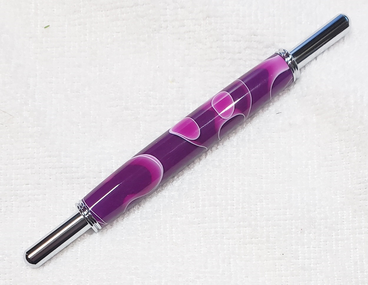

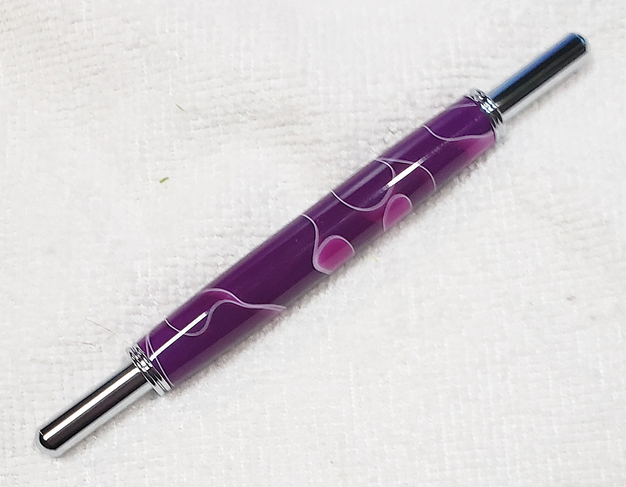

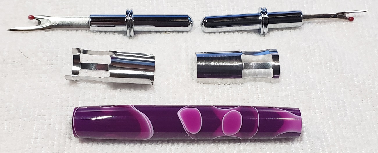

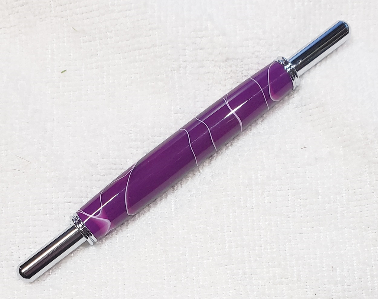

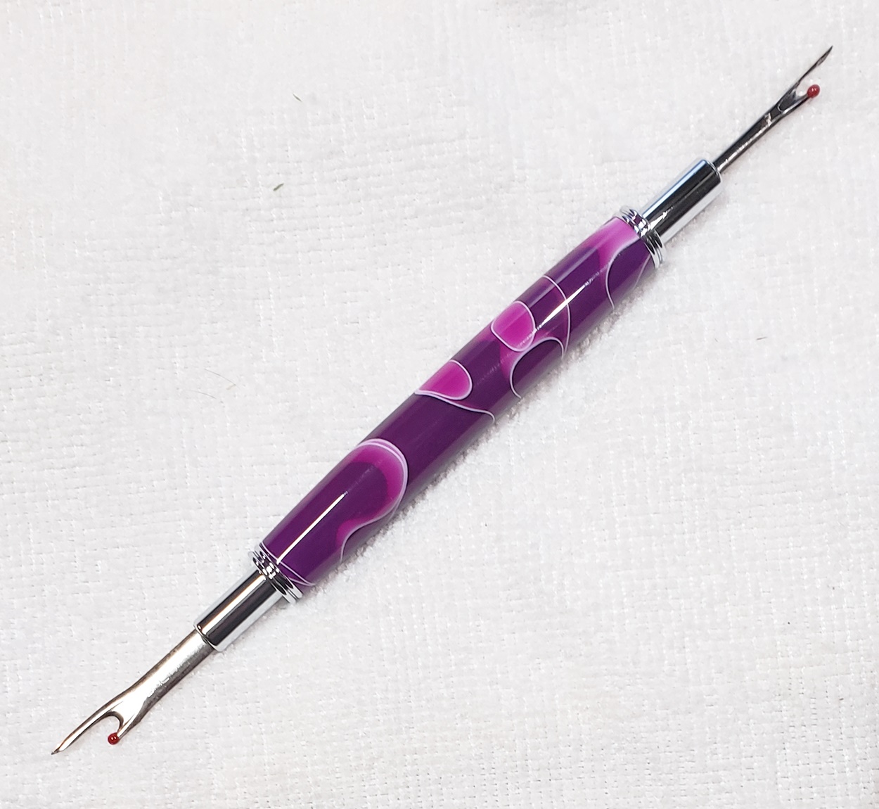

This is the PSI seam ripper in chrome, purchased at Rockler. The blank is called Purple Passion, and is also from Rockler. I made this for my daughter-in-law who loves purple. I really like the blank, but the quality of the kit is suspect. Nothing specific, but just doesn't have a "quality" feel to it. Getting the springs into the ends of the tube was more than a little fiddly. But it's together, and looks good. I think she'll like it.

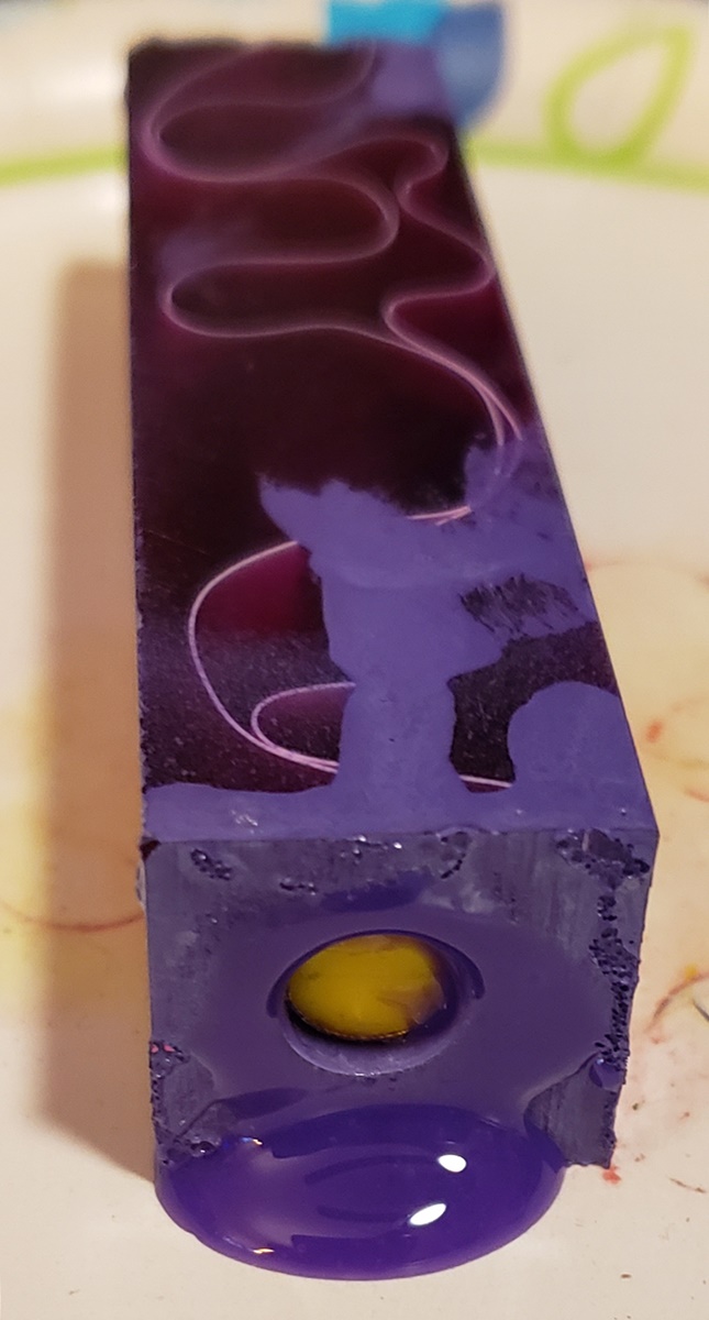

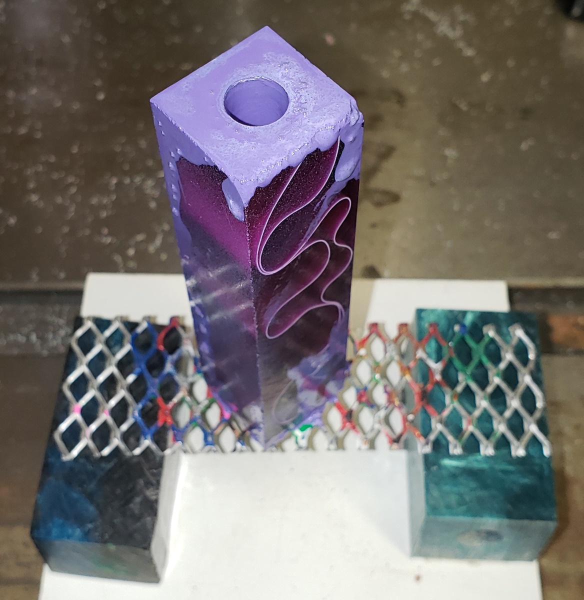

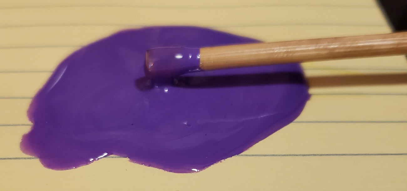

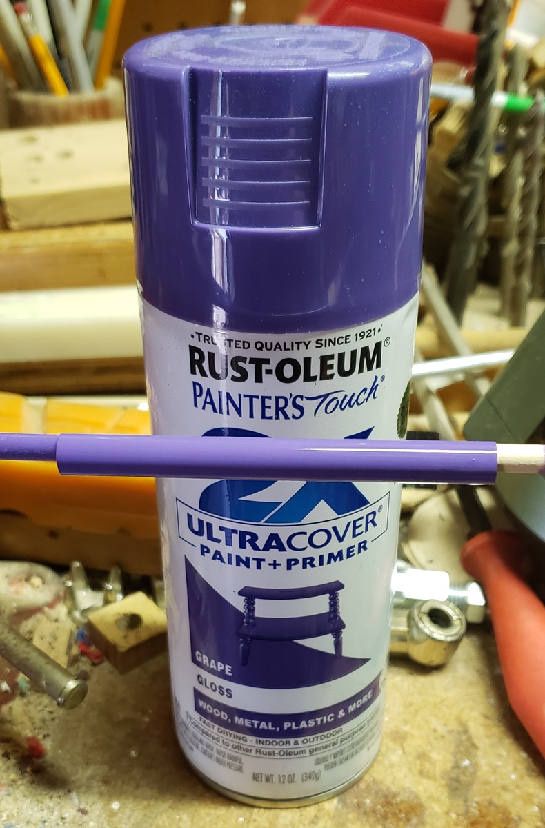

The blank appeared quite translucent, so I didn't take any chances. I back painted it, painted the tube, and colored the epoxy.

Nice ripper Jim. I sell a lot of these exact rippers and they can be troublesome at times, especially the retaining springs. But you did a great job on this one and I'm sure your daughter in law will love it.
Nice! There was another thread on the springs. Some are better than others but they all are lacking somewhat. The best way I've come up with is to use one of the points to help push the spring in the tube.
Looks like the ones Woodcraft carries. I haven't tried that style not because of the o-rings but I like the ripper with the two different tools. Funny as I wrote that I thought I've never used one so what would I know. Ha Ha
Good job on the seam ripper. Love the color.
I've made a bunch of both brands (PSI & Berea) seam rippers and I'm back to being more of a PSI fan.
The original PSI kits (like the one you got from Rockler) had a spring that was a little over half the length of the one in the current kits. There was nothing to seat the springs and the would push down in the tube sometimes and would not hold the ripper. The longer springs seem to push against each other if you make the double like you did. This keeps them in place and working.
One other thing on the PSI kits, they offer a stiletto replacement point and needle threader kits. I've started making these in pairs. One would have a seam ripper on one end and a stiletto on the other. The second would have a seam ripper and a needle threader. That way you will usually sell two instead of one.
On the Berea kit, the O-rings provide positive hold, but if the user regularly takes it out and puts it back into the handle, the O-rings will wear and fall off. I stocked up on replacement O-rings and usually give a small plastic bag with 4 rings to every customer. The O-rings are a pain to get on too.
One thing I learned from my wife the quilter is that if your customers are older, make them wider. Older hands can't grip a pen blank comfortably for very long. The other lesson I learned is to leave one side flat. If you make it round, it rolls off the table or sewing machine. Good luck with them. They are fun to make.
Steve
Very nice work! My cousin owns a Quilting Store and she tells me the PSI seam rippers are the best and sharpest she has every found. She will be happy.
