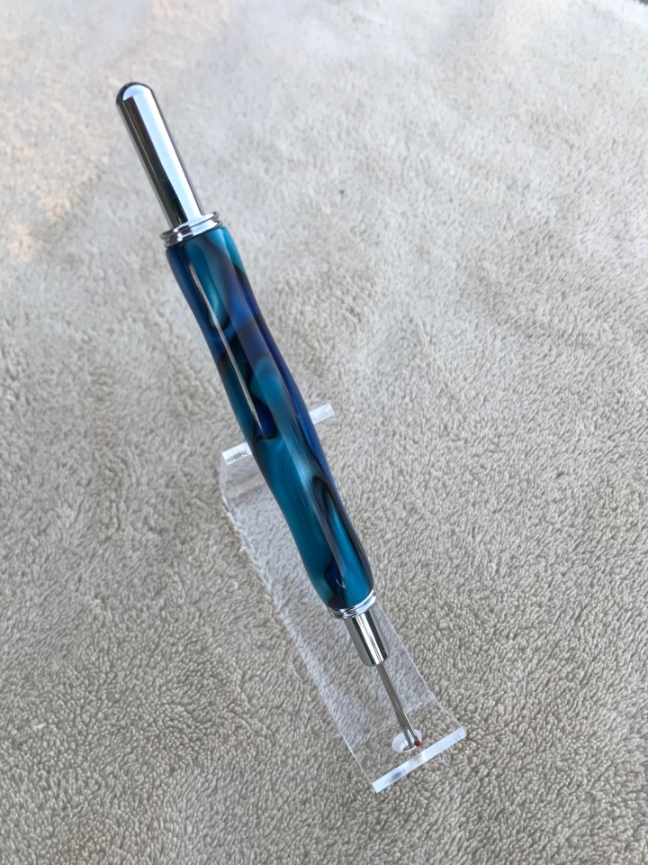

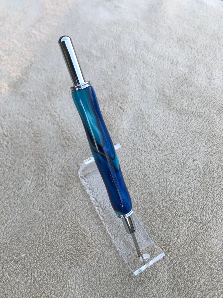

My wife has been asking for a seam ripper since I ventured into this new hobby a little over a year ago.
So I thought I'd post the outcome. She and I are both happy with the way it came out.
I know, I know... need to work my Photography.

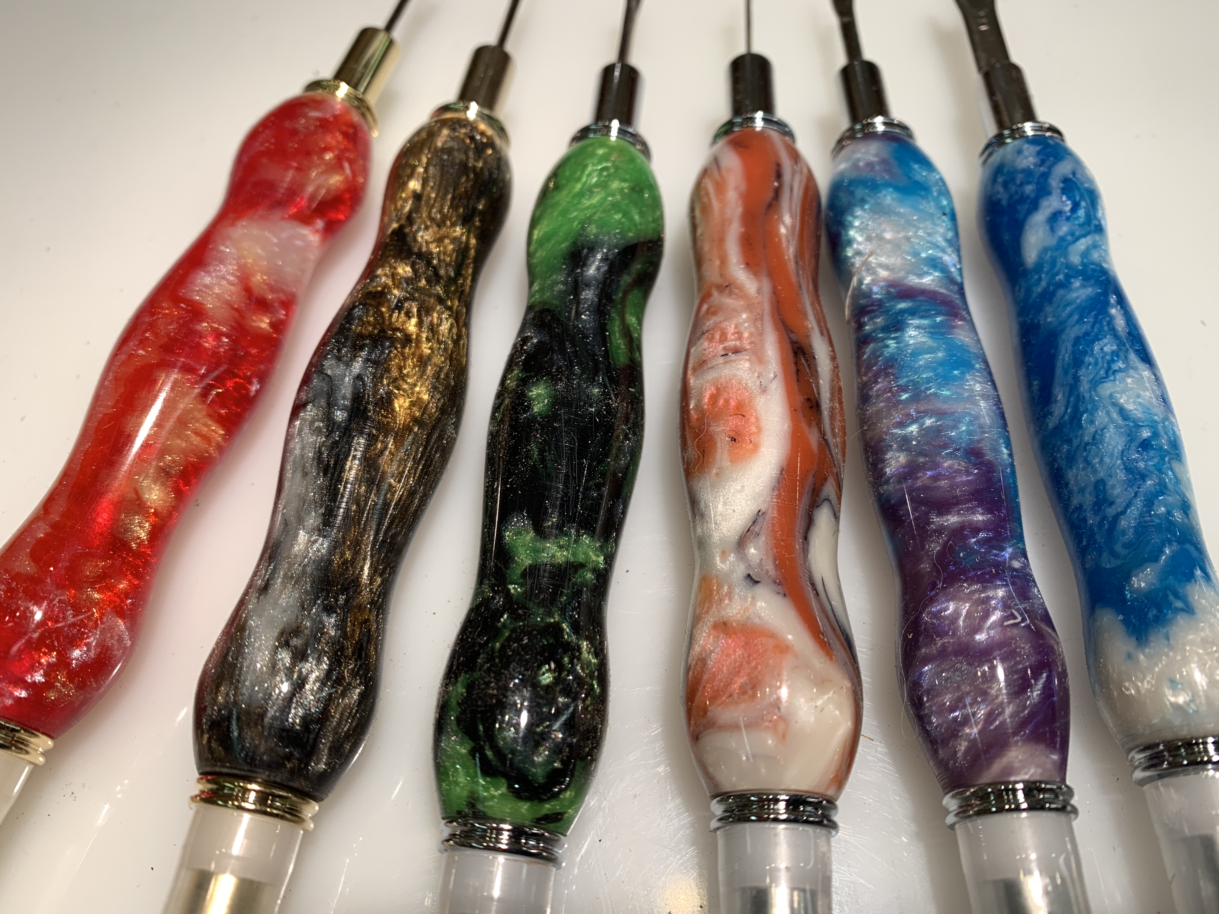

I make and sell double ended seam rippers with one small ripper and a stiletto. Long ago I started having a rounded portion near each end, similar to a classic dog bone shape. Numerous occupational therapists and quilters commented on how ergonomic the design was, who knew. I now am convinced this is the most comfortable shape for most women, especially women with some years behind them. Though it may seem counterintuitive for women where slim is in, larger ripper bodies and more comfortable for many.
The photo is poor as I am under the weather for now.
Good work.

Thanks for the advice. I will go for the more ergonomic shape on the next.

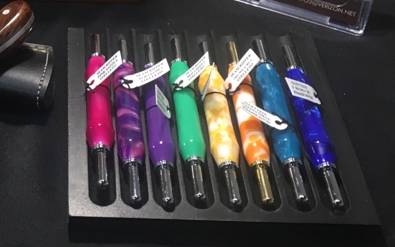

I've followed the theory of natural selection in settling on a profile, whatever sells the most gets reproduced more and a bit of minor random variation causes the profile to evolve. Apologies for the poor quality pic- the foreshortening obscures some of the shape, but the basic idea is still there. Concavity on both sides helps improve grip, and in general, older folk prefer the thicker ones, but not always-it's good to have a range of thicknesses. The one on the far right is prolly too thin.
As far as tips-few seem to want a small seam ripper tip paired with a large-it's redundant. A few more want the stiletto tip, but the most popular combo is either small or large ripper paired with a needle threader. For some reason, the tips are reversed in the photo-the needle threader usually goes on the narrower end for finer control. I always keep a supply of spare tips in case I'm wrong and the stiletto crowd is in town. Occasionally, people even want extra tips for even more versatility. The top request is for a cap for the ripper end which sadly I dont have
I should add that these are all longer than the tubes supplied in the kit, the extra length being necessary to get a good grip from both sides.
