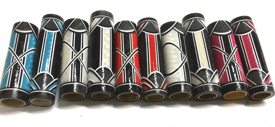

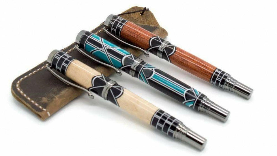

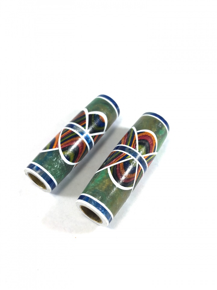

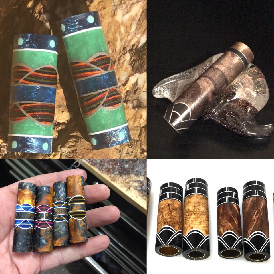

I would stick with med CA and accelerator most all blank segmenting. Working with metals is a little more challenging so maybe consider wood veneers, polystyrene sheets, fish paper, composite aluminum material or old gift cards as segmenting material. The key is to ensure you have a good bond. After the blanks is built it's a best practice to saturate the seams with thin CA to fill any voids and help prevent blowouts. Plan on getting really good at repairs, things do happen. Take your time and know that practice will make the experience better over time. I'll include some pics of blanks we've made using these techniques as well some finished pens from of our blanks. If you have any questions feel free to reach out.
