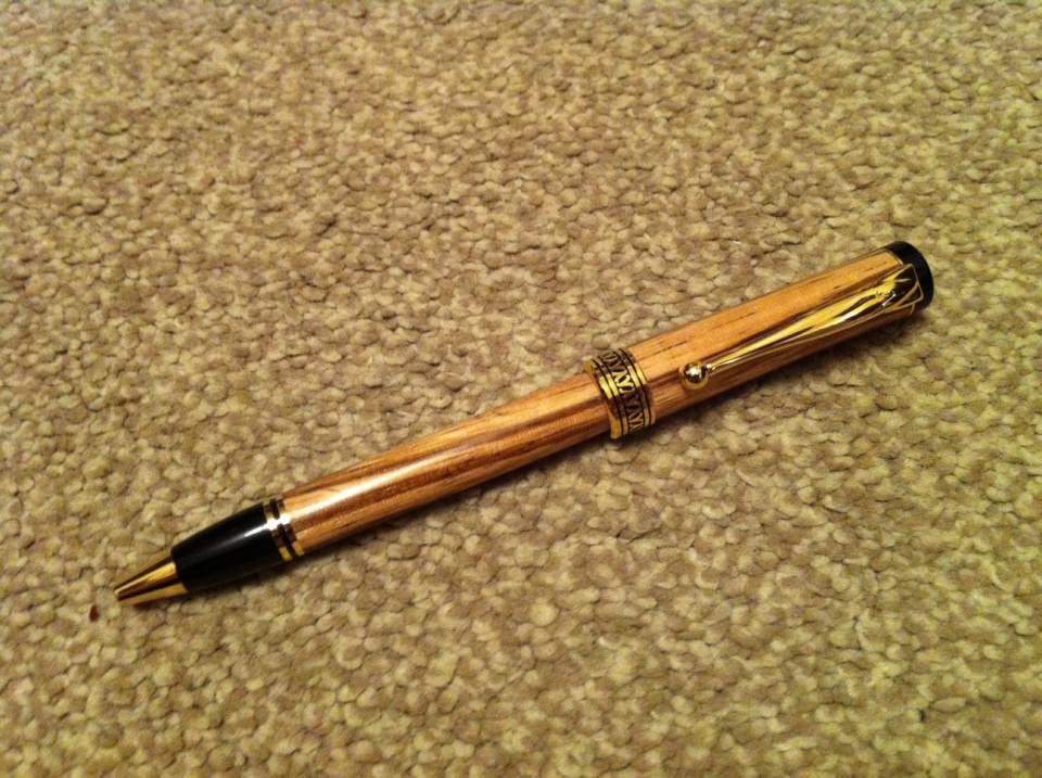

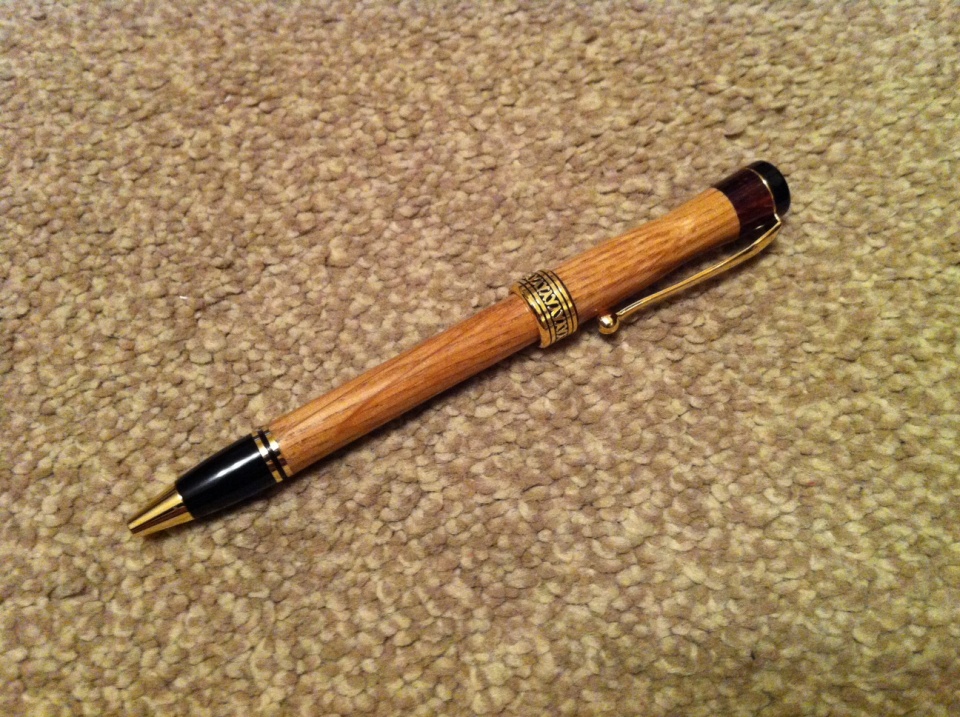

Hi all,
This is my first post here, having just started turning pens, as a novice...
See the attached photos of my first efforts - Zebrano on one, and Jack Daniels barrel/Cocobolo on the other! I know the photo quality is bad, will work on a better background next time...
