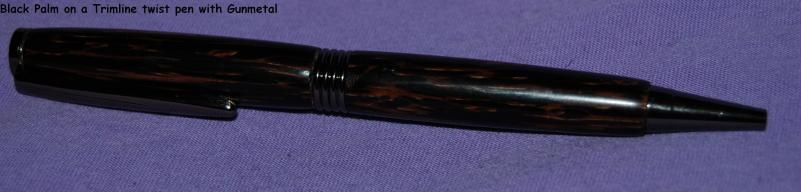

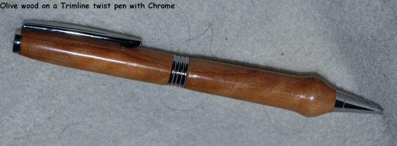

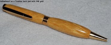

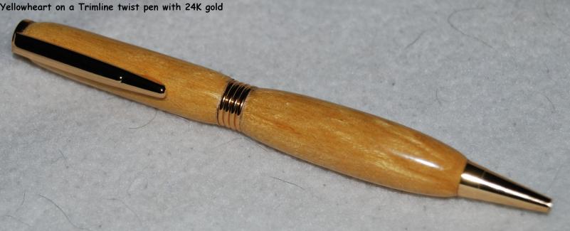

I have only been making pens, or turning at all, for about a month and decided it was time to get some feedback. All three are finished with CA/BLO with an overcoat of HUT crystal...
First is a Trimline twist with black palm with gunmetal fixtures
Second is a Trimline twist with Yellowheart and 24k gold fixtures
Third is a Trimline twist with BOW and chrome fixtures
please comment away and help me get better

The finish looks good, just be careful with the larger section on the middle pen. A little taper is nice but can get too fat for most people fairly quickly. The black palm looks nice and can be a bit of a pain to turn. Good work.
The fatter middle pen was on request actually...it's for my step-mother and she has trouble gripping things that are too thin/narrow.
Thanks for the feedback, and the black palm was a pain to turn it kept tearing out slivers, but i think i got it under control in the end.
Before finishing , I find it helpful to examine the barrels under different light sources . Low angle incident light , either natural or artificial , is preferable to direct overhead . Also helps to look at the barrel both lengthways and sideways , rolling it entirely around .
This should allow you to detect any areas needing further sanding to remove tool marks .
Difficult to evaluate the black palm because of the darkness of the photo , but it definitely is a difficult wood to turn , particularly crosscut .
