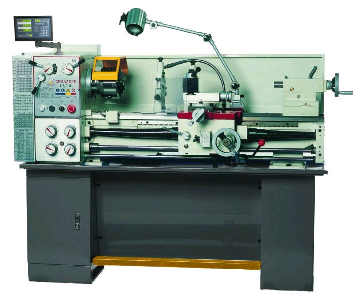

After pooling all my revenues together I have just ordered myself a Crusader Lathe!!!!!!
so excited, and cant wait to get turning on a big lathe again :biggrin:
The delivery driver will be dropping it off on the pavement, which will leave me about 15yards to move it across my solid driveway and into the garage. any tips for moving 450KG? :rolleyes:
My line of thought is an engine crane with 1ton slings, and a few guys to push it around. I am presuming it will be delivered in one piece on a pallet... chap on the phone seemed to think it may be separated from its stand..
I guess that means I will actually HAVE to clear out the garage at the weekend now that its actually ordered...
Lots of things to pick up again as I go along... but at least the expensive difficult bit is covered!
Thank you to everyone who's helped with this :smile:

Brad I had 4 of the little furniture dollys and put one under each corner of the pallet and rolled it up the driveway. Mine came separate of the stand as wellbut it was all in one big plywood box. I took all the extras boxes of accesories and the stand off before I moved it. I used an engine hoist to lift it into place.

Thanks for taking all those pics Mike, I may be copying your approach lol. There will be two of us so we should be able to muscle it in. Little envious at the Engine hoist you had though :biggrin: the one im hiring will lift upto a tonne.
Not only did Mike Roux provide all the expertise of putting it on the stand and doing all the work. He also borrowed the lift from his neighbor for me!

I ended up with 17 tool holders for the qtcp. I had to build a shelf on the back or the splash guard to hold them all. I also moved the dro off the top of the gear box to that shelf so its almost directly behind the chuck.
Oh and replace all the sheet metal screws for the back splash with quality socket head cap screws. They are so soft you can strip out the heads by hand. DAMHIKT

How long before it's delivered? Have you ordered leveling feet for it? How about the oil for the oil change after the break-in? Come to think of it, sometimes they're shipped with no oil in them. And way oil for the ways of course, but it's also what you put in the apron gearbox.
So much to do, so little time... or is it going to be a while before it shows up?
Mike
Being delivered on Monday Mike :wink: They wanted to deliver it tomorrow!
And no to all the other questions lol. Id assumed it would come with levelling feet... now you have installed doubt il double check!

You'd be surprised what they don't come with:rolleyes: Besides Mike Redburn's thread you might want to check this one out. Talk about a photo documentary. You may have to register to see this thread but it will be well worth it. CandlePowerForums

righty I've ordered some leveling feet :rolleyes:
Just picked up some cheap ones, which are rated to 500KG each. I figure with 8 of these for the lathe it will be fine
Not quite as wide as the one's you have used, but still. the concrete floor is quite level to begin with
