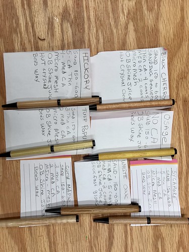

WigWag Workshop Member Joined Nov 2, 2016 Messages 30 Location Central Ohio Jan 15, 2017 #1 Good Day Folks Below are some of the first pens I have turned. I been comparing different ways to finish the turnings, and writing the processes down. -Steven

magpens Member Joined Feb 2, 2011 Messages 15,907 Location Canada Jan 15, 2017 #3 Those are really GREAT looking pens, Steven !!!! . Welcome to IAP !!!! Please tell me what pen kits you used ... I especially like the single barrel style And also, what is the "OB Shine Juice" that you use? . Not familiar with that . Last edited: Jan 15, 2017

R RegisG Member Joined Dec 15, 2016 Messages 110 Location Mount Juliet, Tn Jan 15, 2017 #5 Very nice work. And so well organized. I was surprised at the depth & gloss on the one without micro mesh (bottom center) Thanks for sharing Regis

B bon_sai Member Joined Feb 9, 2005 Messages 20 Location Houston, Texas, USA. Feb 20, 2017 #10 OB Shine Juice 1/3 part Boiled Linseed Oil 1/3 part Clear Shellac 1/3 part Denatured Alcohol Mix in a plastic squirt bottle and shake well. When finished using, mark a line on the side of the bottle. When you are ready to use again after a day or a few days, fill the bottle up to the line with denatured alcohol. Here is the youtube video from Capt Eddie: https://www.youtube.com/watch?v=taJbBmcaAZQ
