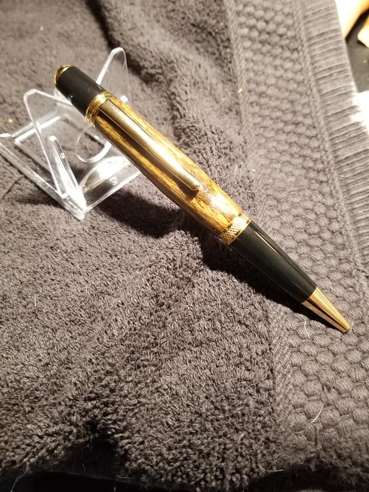

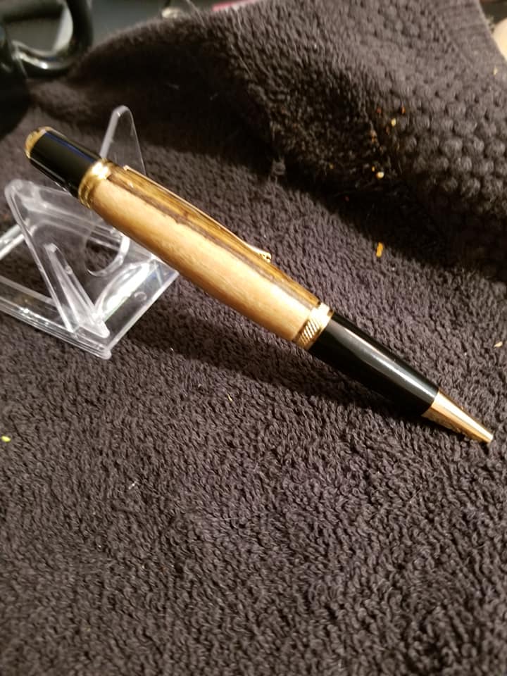

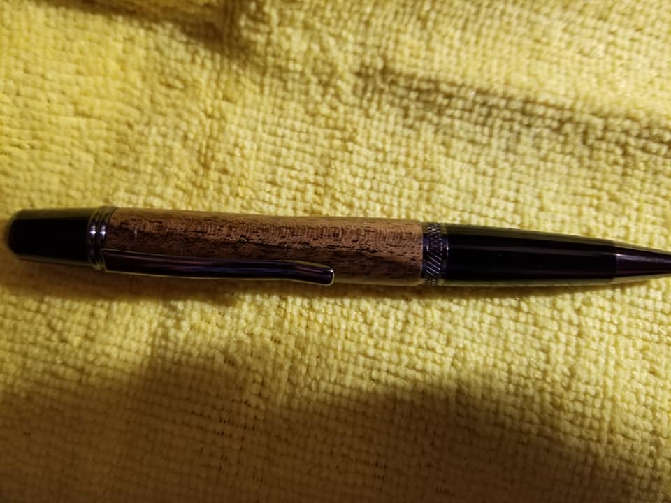

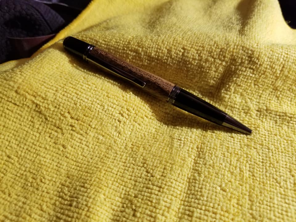

Finally after a bit of waiting and working things out!
Nice going !!!
Your first is really special.
It takes a while to get the knack of doing a CA finish. . It's a skill that just seems to build up as you practice it and then, all of a sudden, it works !
It's a bit like learning to walk ... LOL !!
Nice job! I think CA finish is a personal technique. There are a 1000 ways of doing it. Thin for me only. 6 coats, sand with 1000 grit, 6 more coats and then MicroMesh. You'll find what works for you. Good luck!
Well, that is a good topic. My many layers of CA do you all use?
The first use just 3
The second was 8 - 4 thin and 4 thick
For me, an average of 7 layers I would say (I don't actually keep track).
And I use only THIN CA ..... just the way the finishing process developed for me. . Tried MEDIUM ...didn't like it ... for reasons now forgotten.

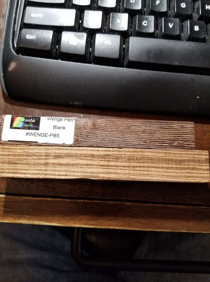

I have 2 kits left but they are a pen and letter opener set

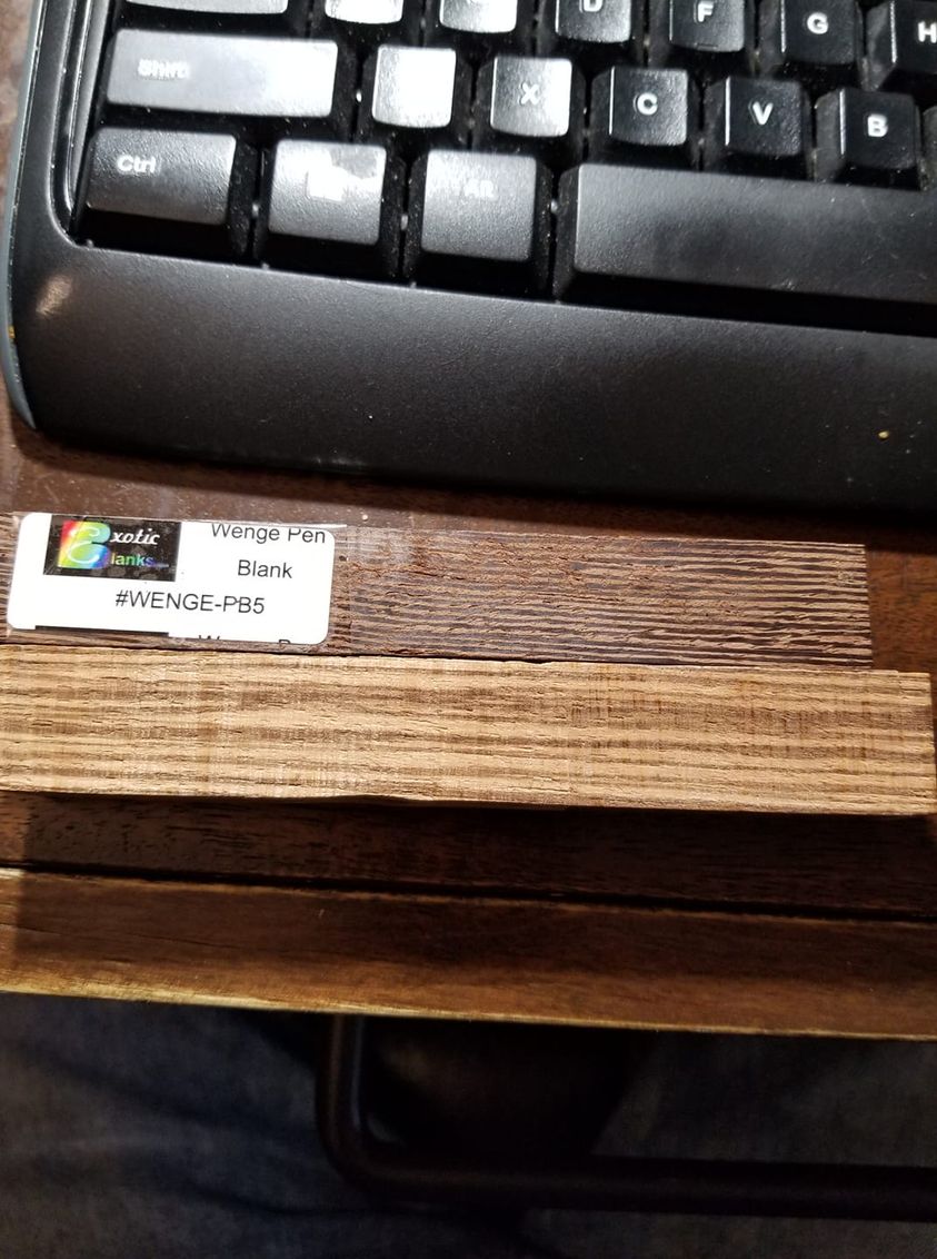

Which blank should I use?
@Madman1978
One of your displayed blanks is Wenge ....
I find Wenge somewhat difficult .... the grain is quite coarse and rather pronounced .... I find it hard to finish nicely. . With lots of CA it can be OK.
I would use the other blank for your next pen ... is it possibly Zebra wood ? . For future reference, Bocote is probably my favorite wood for pens.
@Madman1978
Yes, the second blank is Zebrawood. My daughter likes that blank.
