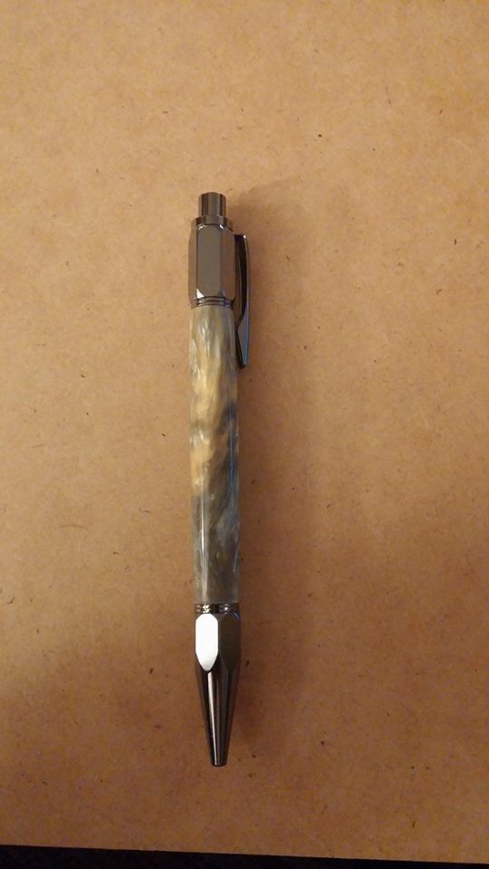

This is the first pen that I have made with a polyester casting that I created. I found it hard to do the casting in the cold weather of Michigan but was able to make it work with an air tight container after it was cast.

Joe, That is one Nice Pen,
Superb Blank, well done on your First, and matches Great with your hardware.
Your Fit and Finish is Excellent.
In all a Great job,
Congratulations.
Brian.
I don't mind sharing how I cast this.
I started with two 3oz Dixie Cups half full of resin. I added gold Pearl Ex Powder to one cup and silver Pearl Ex powder to the other and stirred them fully. Then added the hardener.
Once it was all stirred together, I poured both cups together into a corked piece of 3/4" PVC pipe, rotating back and forth as I poured.
Once the pipe was full, I put a piece of 10 gauge wire, that was crimped in and out up the length, into the mold then started to rotate it as I pulled it from the mold.
This was the end result. I got the idea for the wire from a YouTube video I watched.
