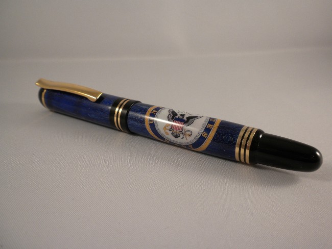

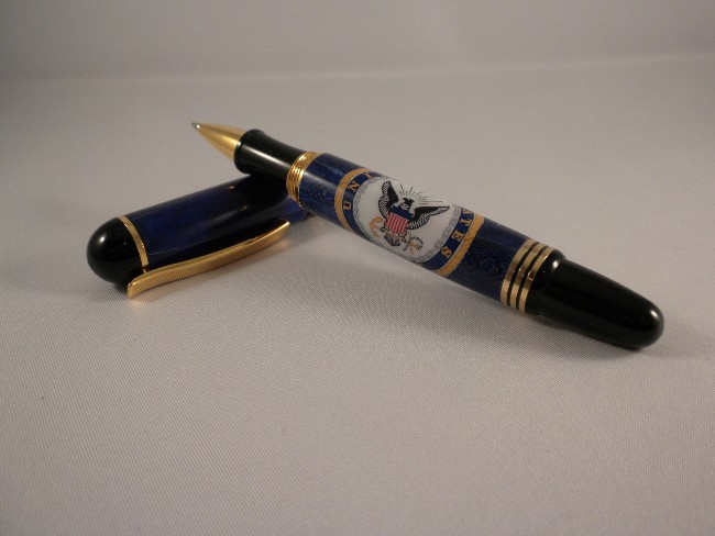

I've been wanting to try making some pens using decals on tubes and then casting them in clear resin or turning a blank and using decals on it. A friend of my wife asked if I could make a pen for her husband as an anniversary present and make it a Navy theme for his service in the Navy. Here's what I came up with. I used a Church Hill kit and a blue dyed maple pen blank. I searched the internet for free clip art of Navy logo's.
I turned the blank to size and sealed it with some thin CA and let it cure over night. I printed the logo on some Testors decal paper, trimmed and applied and then allowed it to dry for several hours then went back and applied 10 coats of Medium CA, MM'd and polished and this is what I ended up with.

Andy, what size (diameter) was your decal? I have a friend asking if 1.5" is too big. I'd like to send him your pic and dimensions to give him an idea of how it would look.

Steve, the diameter is 1.5" and was a perfect fit for the Church Hill body
Really nice. Can you feel any transition over the decal or is the CA built up enough that you can't feel it?
Jim, The decals are very thin so there was no feel of an edge when applied. I did the 10 coats of CA to be sure I wouldn't sand through and ruin the decal. It might have been some over kill but it was my first time trying this and I didn't want to screw up!
where did you get the decal paper?
Ryan, I went to the modelers section (cars,planes & etc) of our local Hobby Lobby. Look for the Testors model paint display and it should be just above the paint. Its called Decal Paper and comes in clear or white background. You'll also need a can of the Decal Bonder spray located with the model paints. I also want to add that the paper made by Testors is designed to be used with an inkjet printer only. I've heard they made it for lazer printers too but I haven't seen any yet.
