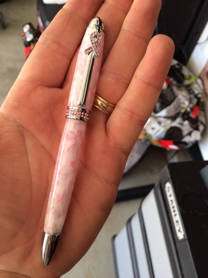

As you can see, the results are very nice. (Was entered into Summer Extravaganza BPC)

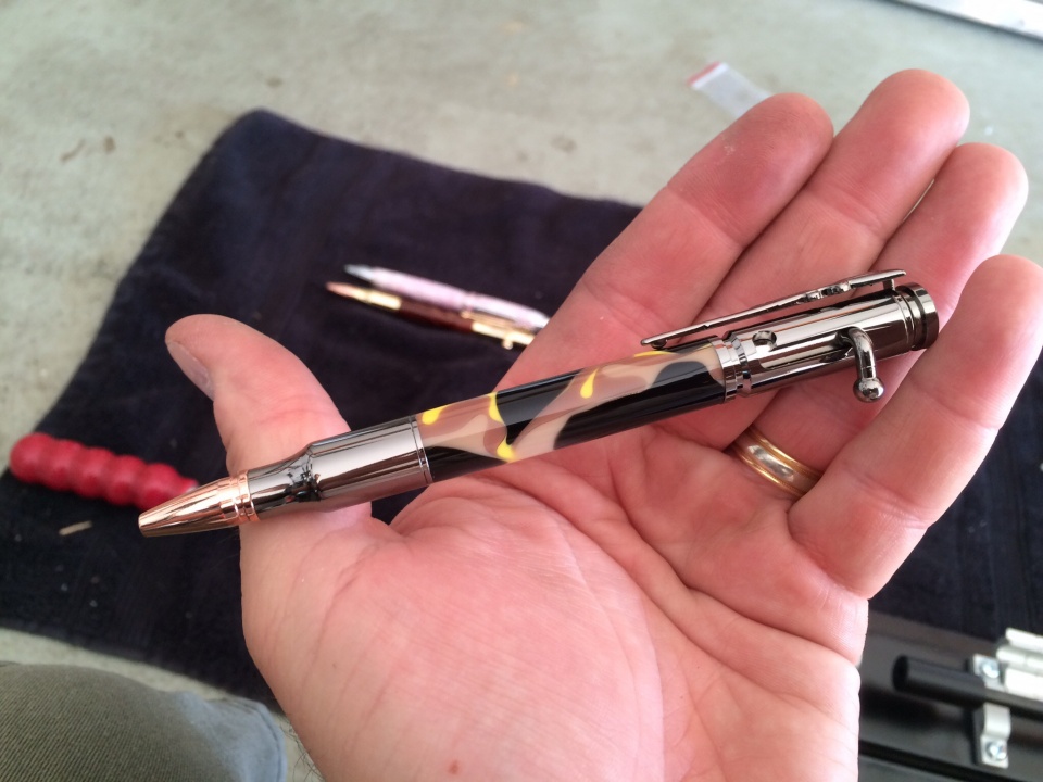

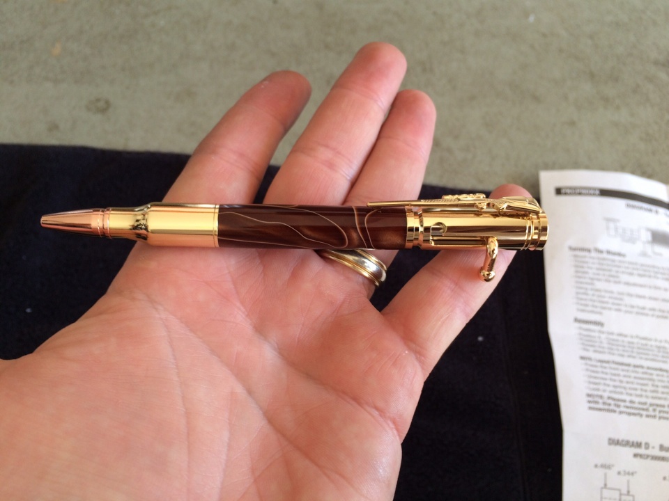

Thank you all very much, what is the process you use to paint the inside of the blanks? The pen turned out pretty well along with 2 bolt actions!

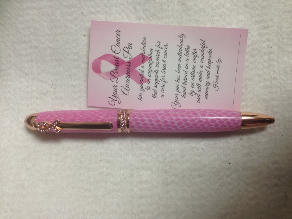

Looking good. It's more than a pen. I also made a BC with Heart blanks.
Show the bolts sometime. They have to be the coolest pens on the planet.
You've done awesome! It certainly doesn't look like a first effort! :)
