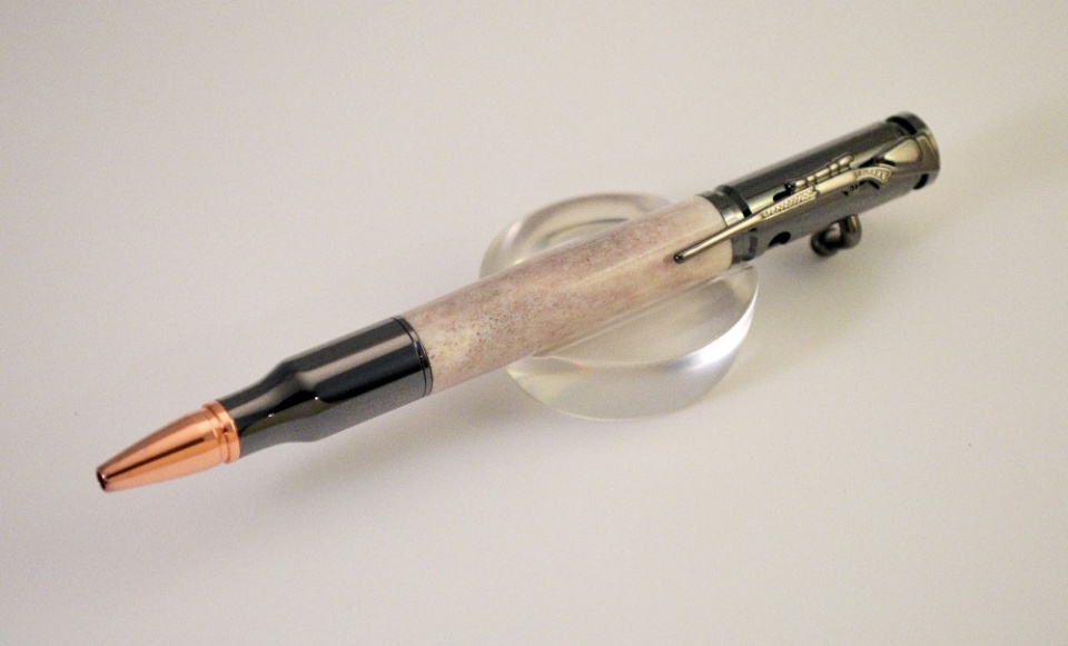

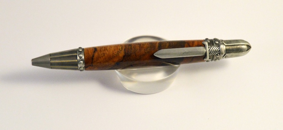

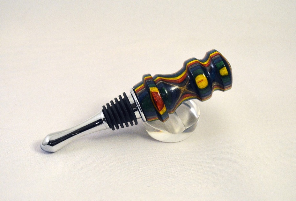

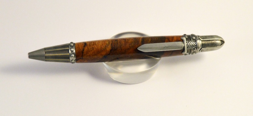

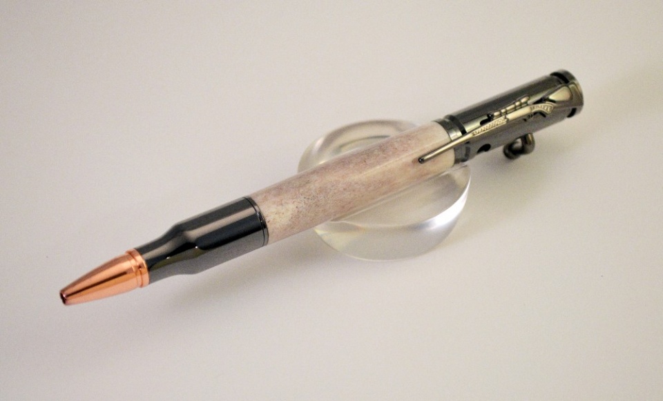

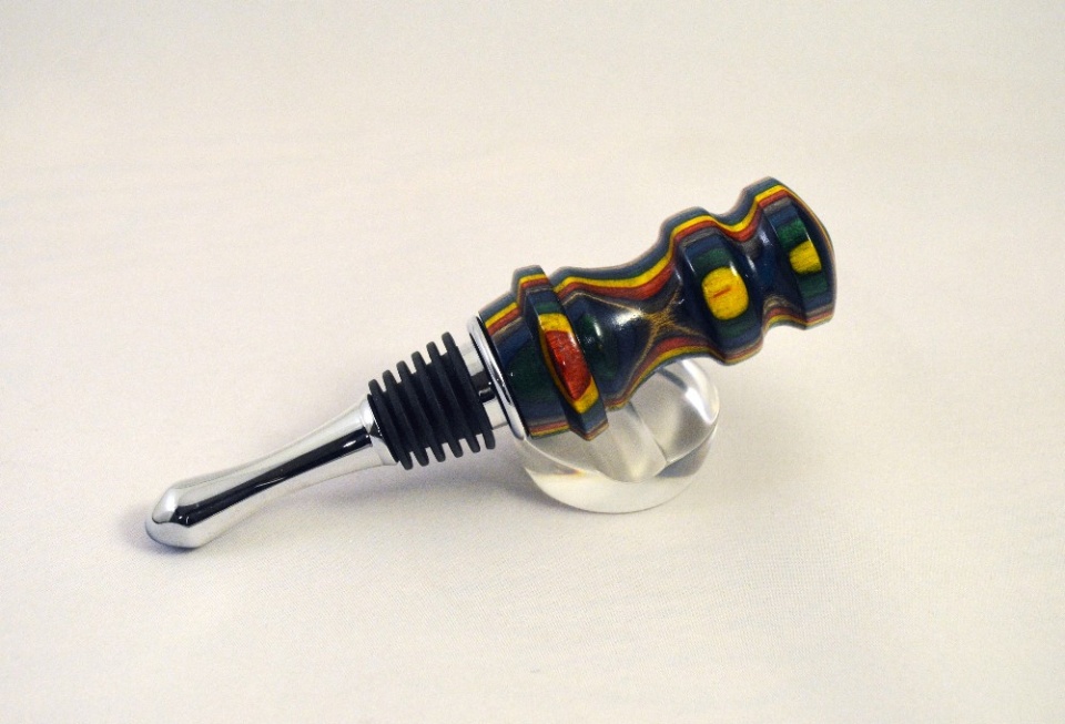

first pen pics with new camera
Feb 18, 2004
4,130
Grosse Pointe Woods, mi, USA
Better than my Canon point and shoot but not just right, yet.
Went DSLR, Nikon D3200 with AF-S DX Zoom-NIKKOR VR 18-55mm (these photos are taken with this lens) and a 50-200mm VR zoom for vacations. Looking to add a 50mm macro fro pen photos.
Used the macro setting with photo tent, no flash, f5.6, exposure time 1/25, ISO 800.
Any DSLR suggestions will be greatly appreciated!!

I like the 3 items!!!
Oh, a photo shoot critique... Yea... the new camera did good also. (Im no photographer... So Ya done good!). :)
I bought a used Canon Rebel T2i DSLR late last year and am slowly learning its capabilities... It will exceed my needs!
Have fun.
The Pics look good!

The problem is "auto-mode". It is readjusting the camera pen to pen. Not what you want.
Your best bet is to buy a 18-percent gray card like
Amazon.com: Mennon Set of 2 Gray Card's size 4x6 inches and 6x8 inches, 18 percent Gray / 92 percent White: Camera & Photo
You can put these in your tent angled so they get the same lighting your pen would. Frame a shot to fill the frame with the card. Using full-manual mode adjust your settings for perfect exposure. This becomes your base setting for shooting your pen photos. Now take a picture of the card and use it to set your camera's "custom white balance". This will make your color rendition perfect no matter what light you use (as long as all your bulbs are the same).

try using iso 100 slow shutter speed (1second) then use the aperature to set depth of field,
multiple shots with diff light settings. should give you a less grain pic or clearer shot.
and i believe this will increase color saturation. there are even slower films say iso 50.
the macro zoom lenses have a tight focal point if i remember correctly.
your f stop or f5.6 lens click to (play with these) f7 or f7.5 this will give you better depth of field (its like squinting, ie you see better). not out of focus pic #2 the only points in
focus are the rifle clip, the rest of the pen is out of focus or out of your depth of field.
imho: what do you think?
yes as gketell says shut off auto setting.

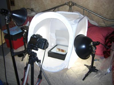

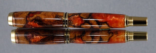

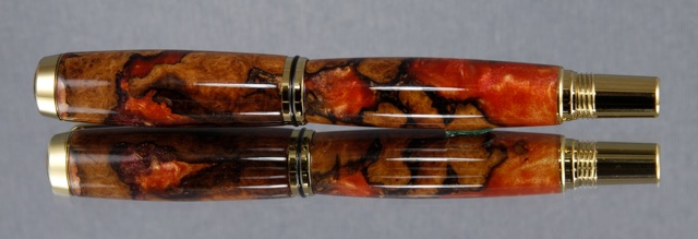

Shooting this pen:
attachment.php

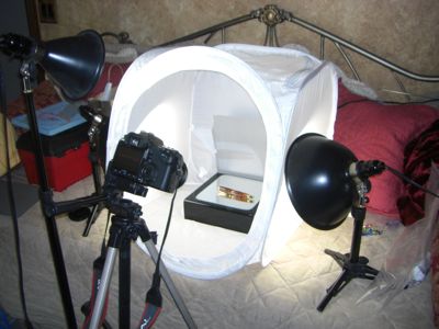

was done with this setup:
attachment.php
One light on each side through the tent creating all-over even lighting and one light from "over/behind" the camera coming in through the opening to cause the "reflection" that shows off the finish.
In this case, the pen was sitting on a mirror and the "grey base" was actually a file-folder standing vertically behind the pen. Shoot at a low angle and crop out the line between the bottom and back to get that nice even background.
Since this photo was taken in 2010 I've learned that I like "front side reflectors" like opaque acrylic better than "back side reflectors" like mirrors. The back side reflectors cause double reflections. Front side don't. I also like the reflection to be a bit more subdued so the pen stands out better and the photo is "less confusing".

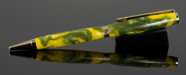

attachment.php

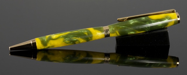

This was black acrylic with the white of the photo tent reflecting so it showed up "gray". Notice, too, that the pen is at a slight angle both vertically and front-to-back. This creates "movement" in the mind and makes the photo more interesting than the pen just laying flat and straight like the first pen photo. And lastly, the stand is designed to "vanish" as much as possible to not take away from the pen.
