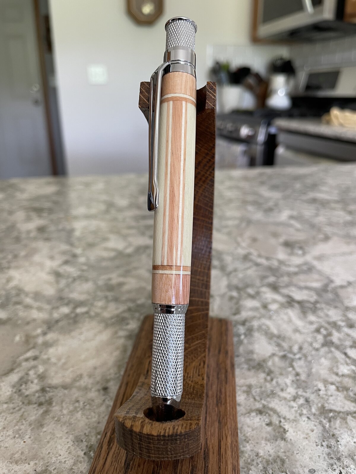

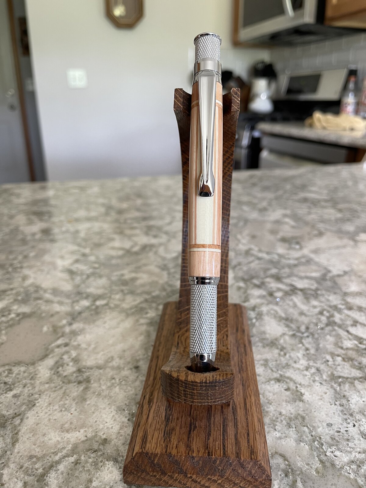

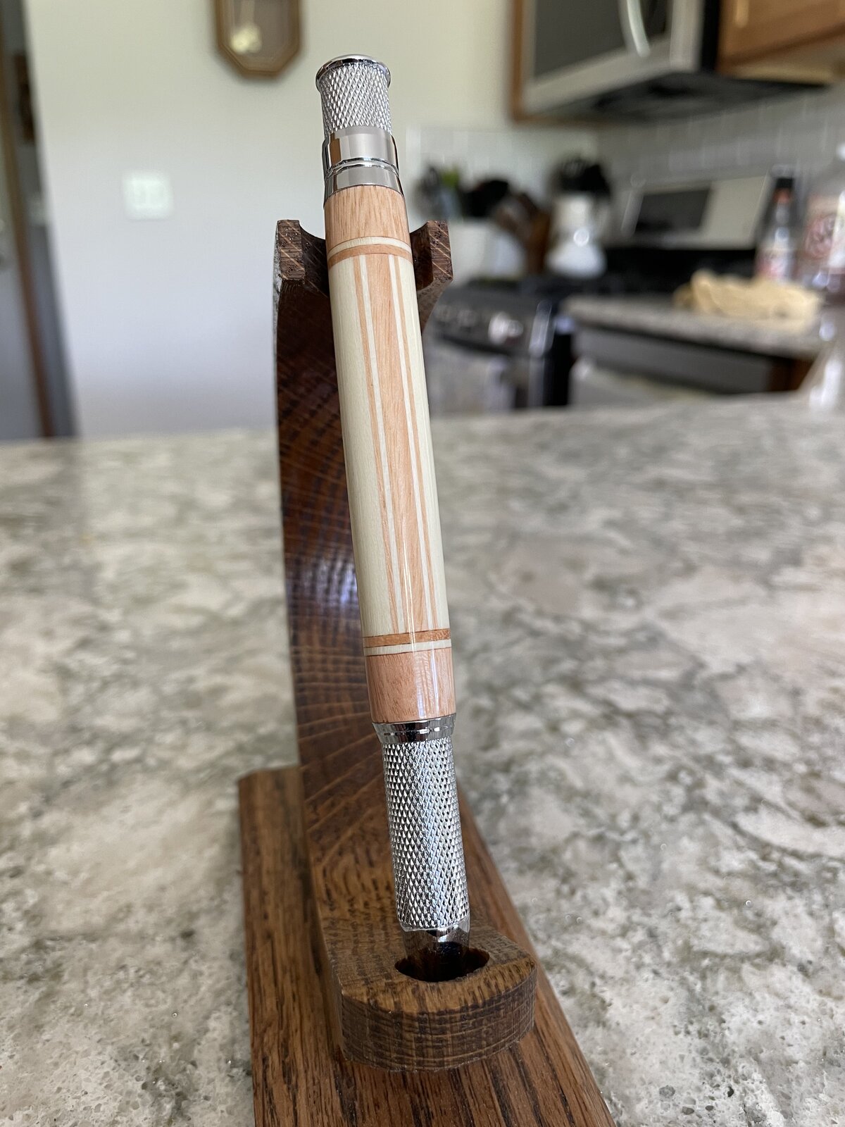

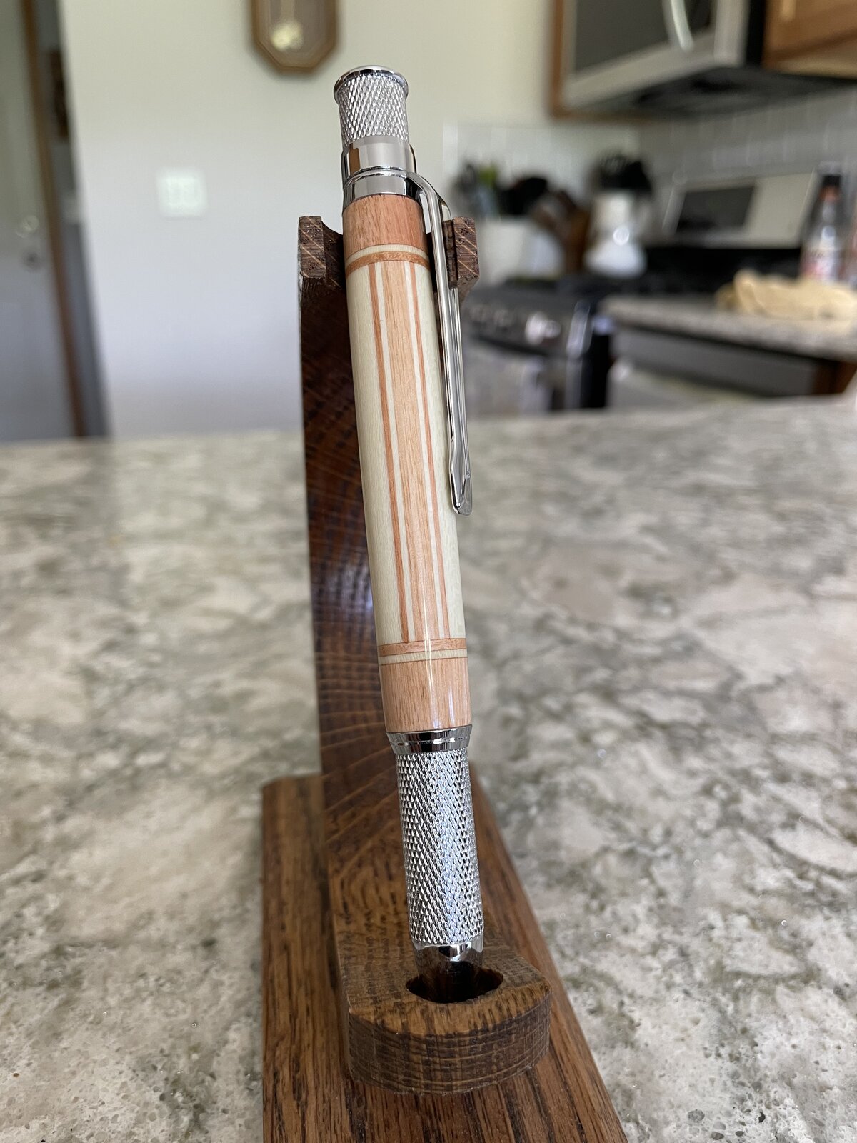

New jig is working very well. After routing the slots, the measurement between the slots was within .002. Woods in this pen are lyptus and holly. I was hoping the lyptus would darken a little with CA, it did not, it's still a nice looking pen but I probably won't use these woods together
. I should mention this is a three slot design on a Knurl GT, chrome finish.
Nice work. Thanks for showing us the whole 9 yards to make this. I'm still impressed with the way you designed the jig to make this pen. As mentioned before I'm not one to build a jig for a project, I'll just get a different project. Although that's a very nice pen I like the road you took to get to this point. Well done.
Sweet! Excellent as expected with your jigs. I actually like the color combination. A softer, creamy appearance.
I'm really enjoying your work. If I didn't have 'Frankie" I'd certainly give a go at your set-up; I see many advantages.

That is one heck of an intricate jig, but it certainly delivered beautiful results! I also like the wood combo. The low contrast really caught my eye as being somewhat unique for segmenting. It's just enough to show the segments off with a very "soft" appearance.
New jig is working very well. After routing the slots, the measurement between the slots was within .002. Woods in this pen are lyptus and holly. I was hoping the lyptus would darken a little with CA, it did not, it's still a nice looking pen but I probably won't use these woods togetherView attachment 309373View attachment 309374View attachment 309375View attachment 309376. I should mention this is a three slot design on a Knurl GT, chrome finish.
Very cool. Your extremely complex jig has already earned its "stripes" so to speak. It's fascinating to see your jig, then see a finished pen. I was looking at the pen, at each angle you photographed, and in my brain I was referencing the sketch you provided of the 3-channel cutout, and I can clearly see how the pen came together. Just plain awesome.
I totally agree . The soft delineation adds greatly to my eyes at least. For want of a better description it's an " I want to pick that one up" pen .
