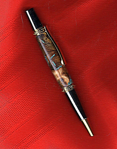

First pen from new mulberry wood
See more from sbwertz
sbwertz
May 11, 2010
3,654
Phoenix, AZ
I'm giving this as a late xmas gift tomorrow, and didn't want to set up the lightbox, so I tried the scanner. I don't much like the reflection, but wanted a pic of it before I give it away. The new wood is beautiful. I have about a hundred blanks in the dehydrator right now.

Very nice. You say Mulberry, is it a burl with casting inlay? Mulberry I have used tends toward yellow until it ages to a honey brown.
sbwertz
May 11, 2010
3,654
Phoenix, AZ
It isn't a burl. When you poll a mullberry tree to keep it from getting too big, you cut off all the branches back to half a dozen major limbs every winter. As a result, scar tissue forms big knobs on the ends of the major limbs. This wood comes from those scarred knobs. The trees have been polled every year for fifty years, and the knobs are upwards of three feet in diameter. So far I have only been able to cut up some of the smaller knobs because I don't have a big enough chain saw. The trimmer is going to come over with his 4' commercial chain saws and cut some of the big pieces for me.
These were live trees, so the wood is green. If cut and stacked it will take up to 6 months to dry, depending on your weather. Here in AZ in the summer, they will dry in about 6 weeks (10 % humidity, 110 degree heat :eek::eek:)
In the dehydrator they take about a week.
Right now the supply is limited to what I can fit in my dehydrator, and what I can cut with my little electric chainsaw.
If you want green wood and are willing to cut it yourself, I can send you slabs of green wood. Note...There are a lot of voids, pith, etc in these knobs because of the nature of the knobs, and because the trees were old and diseased. Most of the major branches were hollow inside (why they were being cut down.) So there is a lot of waste. When I cut up a big piece, I can only use about 50 percent of each piece, the rest is waste. A lot of the blanks have voids. This is what I prefer, since infilling with gemstone, particularly turquoise, is my forte. So I will keep most of the "holey" blanks for myself unless you specifically ask for it.

Sharon, that pen turned out to be an eye-popper. Beautiful job you did.
My chainsaw is 16" electric. Works pretty good on all these broken Pecan limbs I get every time the wind blows.
What size slabs do you have? Any small enough to get a few in a Medium Flat Rate Box?

My electric is a 14 inch. and is working it's little heart out.
The problem with slabs, is that there is so much pith and rot in the crowns that only about 50% of each slab is useable, and often I can only get 3" long blanks. When the trimmer brings his big saw over so I can cut up some of the big crowns, I should be able to get some nice slabs. Right now I am cutting up small crowns about a foot or so across.
The voids from the pith aren't a problem for me because I fill them with turquoise! Not a flaw...a feature!
I cut another hundred or so blanks today, It is green and wet, and next weekend when this batch comes out of the dryer I will put in one more batch. Then I will air dry the rest. My dehydrator is a big commercial job with 14 big trays, but I don't want to ruin it. Running it for two straight weeks is bound to shorten it's lifespan :eek:
It takes about two months in the winter to dry 3/4 inch blanks, half that in the summer. (Phoenix)
If you want green wood, I can send it to you now and let you dry it yourself. This is from living trees that were taken out because they had heart rot. Most of the limbs were almost completely hollow. They are about 50 years old.
If you have a dehydrator, it takes about 4 days to dry a batch of 3/4 inch blanks. Keep an eye out and you may find one at a yard sale or goodwill.

Crazy good Sharon.
Tell me how I can get some of that.:bananen_smilies008:
All this current batch is spoken for, but I will run one more batch next week. Then I will air dry and they will be ready in the spring.
I will send you a small flat rate box if you will pay the postage.
PM me.

That is a beautiful pen! Thanks for explaining where the dark brown color came from. I too have used mulberry quite a bit. Both Japanese mulberry and US mulberry (in the South), and all of it has been/is golden in color. I even had a mulberry tree in my yard when I lived in Japan. When not treated, it turns a beautiful brown as it ages.
But yours is a beautiful color that is different from what I have used. Having used wood from other trees similar to your explanation of "polling" I know that that wood in the other trees are certainly not like the normal wood of those trees, nor the sapwood either. I have some walnut that was taken from burl caused by cutting a limb a long time ago, and the color of that burl looks nothing like walnut or even the sapwood of walnut.
Thanks again for the explanation!
