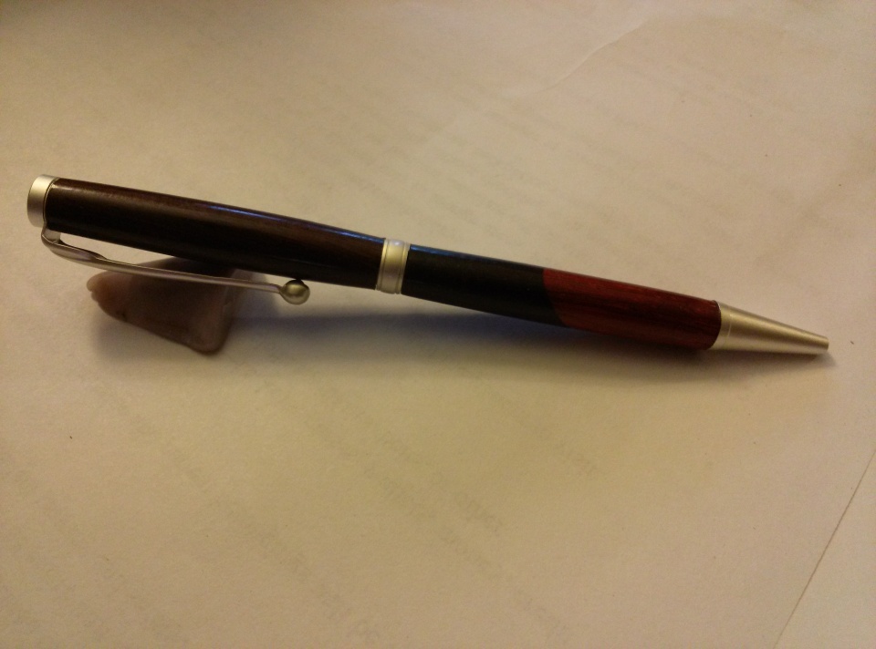

So this is a crap photo with my phone and I will see what I can do about fixing that but I am just so excited. My first completed pen ever! I did actually turn another last night which would have been great till I managd to jack up the transmission trying to install it. All and all for having never turned in my life before I feel pretty good about it.
I had to cheat and get one of the predrilled PSI blank sets because I have no drill press or chucks yet (next purchase) but I couldn't wait that long to get started. Woohoo new hobbies I can't really afford!

Nice pen, I have never done one with that finish but always thought it looked nice. There is nothing cheating about pre drilled blanks. The pen and pencil I carry everyday were made from pre drilled blanks.

We have all had to start someplace. I had a drill and Lathe. use a wood clamp to hold the blank while I drilled it. You did a nice on your pen. Enjoy your newly developing hobby. I still have some predrilled blanks the Grandkids use from time to time but they are getting good enough to do Sierra's and Rollerballs. The predrilled will be used for the 5 year old when he is ready even have some slims left over for him.

Very nice pen - much better than my first one.
I agree - nothing cheating about using pre-drilled blanks at all.

Very nice looking pen, you are off to a great start. The slimlines and their counterparts are probably some of the toughest pens to get anywhere close to right. You did a nice job. There is nothing at all wrong with using predrilled blanks, just saves you some work. Welcome to the madness :)

Great 1st pen, and much better than mine. :good:
Before you go buy a drill press, look into drilling on the lathe. It's cheaper than a drill press, and more accurate.

Congratulations on your first pen !!!! Looks like you did a fine job ! . Yes, I remember the excitement !!!!
I agree with BSea ... drilling on the lathe is more accurate and rewarding ... and probably cheaper than a drill press and clamping device
What you need is (1) a chuck of some sort for your headstock to hold the blank; and (2) a Jacobs chuck in your tailstock to hold the drill bit.
You can even buy both together, but you need to be sure about getting the right fit for your lathe.
https://www.pennstateind.com/store/PENPALXD.html
Browse around the Penn State website, and also check out Little Machine Shop.

Using pre-drilled blanks is not cheating, there many folks that use blanks that are already almost finished so, you don't have to feel like a cheater...!
It is certainly a great feeling when, I manage to turn something for the very first time and without much if any training, we all had to experience that but, that is quickly forgotten because, very quickly we start to make better things that surprises us more than anyone else, huh...??:biggrin:
If I could only show you, how many of us have hobbies that, we really can't afford, you would be amazed however, we all have our own ways of "prioritising" and with that, comes the freedom to do what we want (in most cases) so, we seem to always find a way to subsidize our hobbies, if they give us pleasure and enjoyment...!
Your first is a lot better that many of us first's, the pre-conception that, slims are the easiest to start with, is very wrong, a Cigar is a lot easier to turn and you have a lot more "meat" to work with so, handling slimlines means.

Thank you everyone for the encouragement I have so mch to learn with all of this so I look forward to getting to know everyone.
I actually had looked into getting a dedicated pen drilling chuck and jacobs chuck to do my holes on the lathe seems to make more sense based on several factors including cost, space, and from what I have seemed to read your bit won't wander randomly.
https://www.pennstateind.com/store/PKEZ5.html This is the pack of blanks I got from PSI and I don't honestly know what type of wood I used. That is an area of frustration for me because I would always like to properly describe what I have used. Something to educate myself on as I continue.
I used a CA finish actually. The picture makes it look more matte then it is but I definitely have a great deal of room for improvement with it before I find a glass finish. It was about 10 coats of thin CA followed by micro mesh and a couple of coats of One Step plastic polish.

The upper was Indian Rosewood (or possibly Burmese Rosewood) and the lower was segmented Padauk (the red part) and Wenga (the dark brown part), I believe.
After your initial 10 coats of CA, follow it with 1000 grit wet sanding to smooth out any major bumps and don't forget to sand laterally (with the grain) to remove radial lines from the finish. You stop the lathe and turn the spindle by hand while you sand the blank with the grain all the way round to break the radial lines. Then go to micromesh and do the same thing at least every 3 grits or so ... Your finish will be markedly improved.

Nice pen Marcia! I hope you didn't throw the other pen away. It is easy remove the transmission and put in a new one. You probably have some other members in the area that can show you how, as well as tips on IAP. Skie gave you good advice on the sanding. There are articles in the Library that go into much more detail if you want to do additional reading.

I ha e kept the first one so I can take it apart when I get the tools to do so. I have also taken to heart the advice of others (like Skie, thank you) and adjusted my sanding methods. I think my finish has improved but am hoping to see further improvement after I pick up some medium CA because I only have thin right noe.

That is a great first pen. The workmanship, composition and shape are spot on. I love making slimline's the kits are cheap to buy and the pens always look good and sell well. I recommend keeping the first pen you have made as you will look back on it one day with fond memories. It's worth having a look at craft coat. In my opinion it's a great easy to use finish that produces excellent results. It is not as indestructible as a a ca finish but it is much more pleasant to use and offers great protection to the pen.
