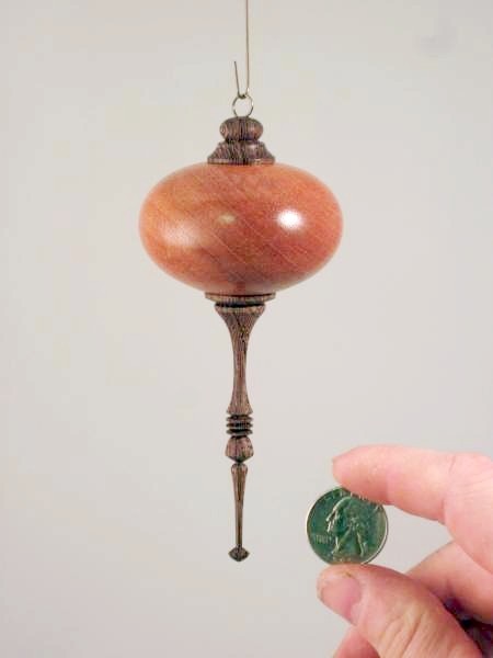

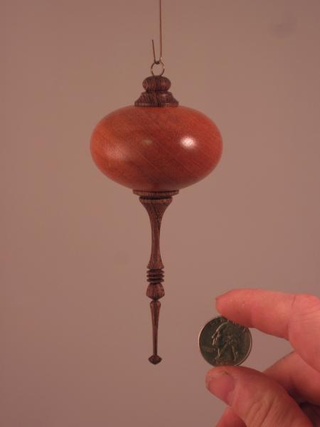

This is my first attempt at not only ornaments but hollowing. I used tools I made myself from allen wrenches. The bulb is Spanish Ceder and the top and finial are Wenge. The bulb is a constant 1/8" thick throughout. The bulb was sealed with shellac then buffed and waxed. The top and finial was only waxed on the lathe.

Very nice ornament, I like the finials. However, I think it is not nice to have your new Big Mustard as part of your signature. It makes me sad that I don't have one, Boo Hoo. Oh well, I guess I will have to just go turn something on my little tiny lathe.

Very nice ornament turning. Make a bunch more for your Christmas tree. You only have five days to get'em done. :):)

Thanks for looking everyone. :handshake: I really had a good time turning this project.

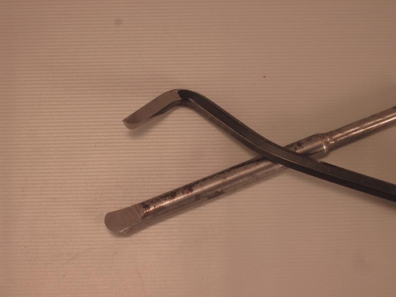

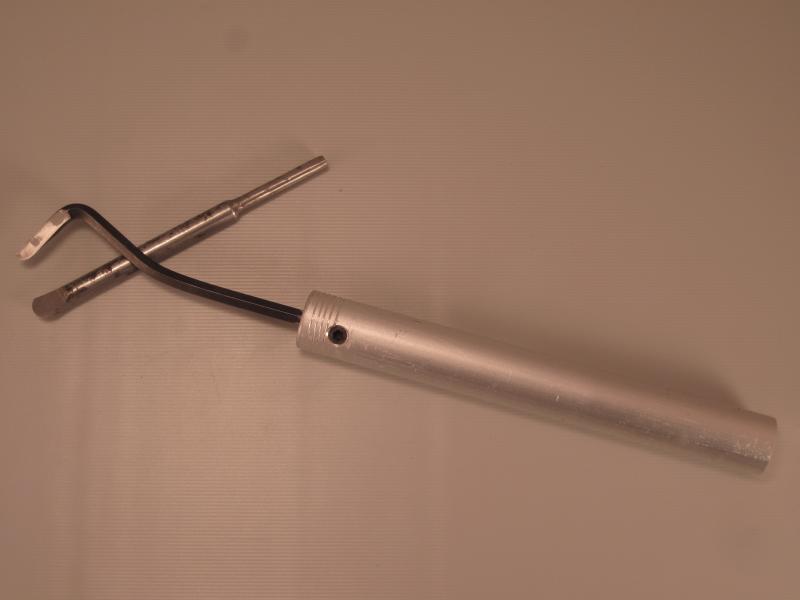

Here is a couple pics of the tools I made. The handle is 3/4" diameter x 6" long tapped for a 1/4 20 set screw. the Allen wrench is 3/16 and the straight cutter is an old speed bore bit. I am going to bore the other end of the handle to accept a 1/4 Allen wrench
