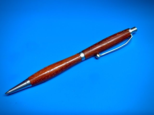

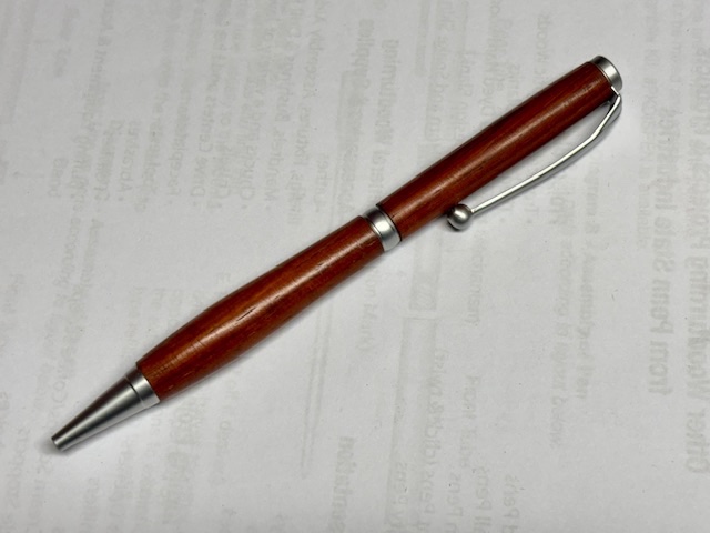

Lathe and start-up set arrived yesterday. I pulled out a slimline pen and pencil to get started. Before unpacking the machine, I glued up four blanks and tubes to set overnight. Getting everything assembled and ready to run was pretty painless. And now I just finished turning my first pen. Boring stuff compared to the beautiful pieces I've seen around here, but ya gotta start somewhere, right?! The only issue I had was keeping the knurled nut tight on the mandrel. I tried just hand tightening it first, but it came loose after a couple of touches with the chisel. So I put the pliers to it and showed it who's boss, and it all behaved perfectly after that. All in all, not bad for my first dance. I got the exact shape I wanted, and I'm happy with the finish. This was just Shellawax, but I have a can of EEE coming tomorrow that I'll finish these pieces with going forward. Maybe could have used a hair more turning on the edges (or maybe I'm being too picky), but otherwise I'm very happy with how it came out. Tomorrow I'll do a matching pencil, then glue up a bunch more blanks for the next round. Gonna use up the boatload of kits and wood blanks that came with the set before trying my hand with bottle stoppers and acrylics, but I see lots of fun ahead. Gotta work a bit on the photography, too. 😁
Photography looks solid to me. Good lighting and a white background is about all you need in my opinion. It looks really good!\
Also, as far as pen finishes goes I've found CA to be my finish of choice. It's very water resistant, durable, glossy, and with a little wet sanding using micromesh it is super super smooth.
CA has a bit of a learning curve and the topic of the best procedure for applying CA has always been a pretty crazy one on here, but if you ever decide to try CA, most people (myself included) are happy to provide insight.
Looks good for your first pen. The edges could be turned down a little more to match the hardware. For this, I would suggest you get a caliper and measure the pen parts and turn to the measurements instead of relying on the bushings.

I did just grab a set of thin, medium and thick CA plus accelerator, but I thought I'd see how it looked and felt with just Shellawax first (i.e., I was too tired and lazy to do any more). I've seen it used on a number of videos, now I might try it on my next one. I don't have any micro mesh (yet), but I do have a pile of steel wool that worked nicely on this first one.
Yep, I noticed that when I assembled it. It was close enough to be close enough, but I'm really trying for perfectly flush. I actually have a small caliper sitting around somewhere that would be perfect for this.
Good start. The only thing I will caution you on is overtightening that knurl nut on the mandrel. You will bend the rod and then come here complaining about out of round blanks. It happens. It is a fine dance you do with securing the blank and lightly touching the SHARP tools to the blank. Good luck as you continue down this path.

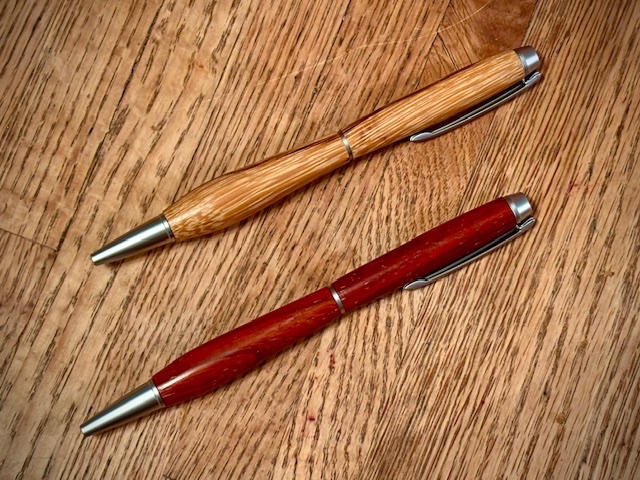

Meanwhile, piece #2 just came off the assembly line, a matching pencil for #1. I got closer on the wood to hardware gap, but still have about a fall a hair to go. Also the finish came out better than the first one, I think because I applied the Shellawax even thinner and buffed it with a dry cloth a little longer. Next time I'll try a CA finish. Baby steps.

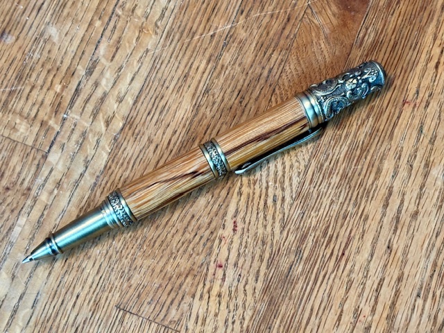

First two Christmas gifts done. I'm slowly figuring out how these things will look before they're actually assembled, but still got a ways to go there. But we're making progress. Got a beautiful Victorian kit setting up now that I'll be turning tomorrow that will be going to my mother. Cannot wait to see that one done.

Thanks for all the advice and compliments! The marblewood (top pen) has a little more of a belly than I'd like, though it is very comfortable in the hand. But it looks like it's wearing pantaloons. I really prefer a more slender shape.

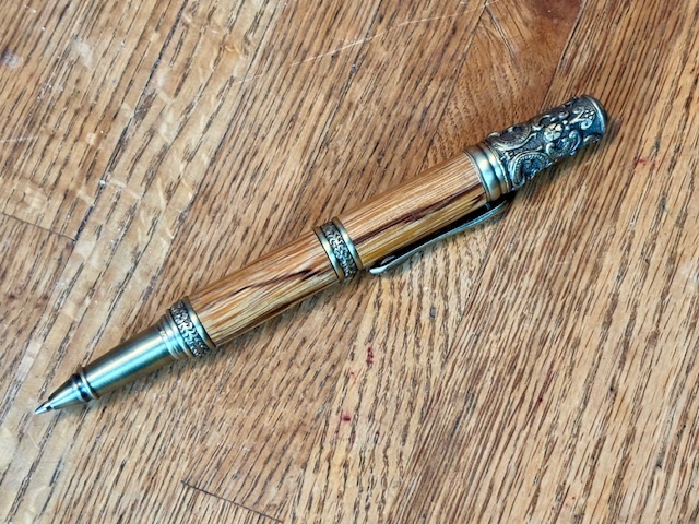

Here's the next supposed-to-be Christmas gift. It was intended for my mother (88 years young, God bless her), but it weighs a ton, so I think I'll make her something else a bit more dainty. This thing is a beast that fought me the whole way. First I couldn't square up the ends to save my life, but once it was assembled you have to look really close to see it. One more thing I need to work on. Then one of the blanks was drilled off-center, but luckily there was enough meat that it turned ok. Then the twist mechanism didn't work right (wouldn't retract without a push), until I reversed the spring from what the destructions indicated (a friend's suggestion!). Now it works great and looks pretty good, I just gotta find another he-man to give it to. Or keep it for me self. 😁
Nice pen!! You did a great job, Danny!!!
