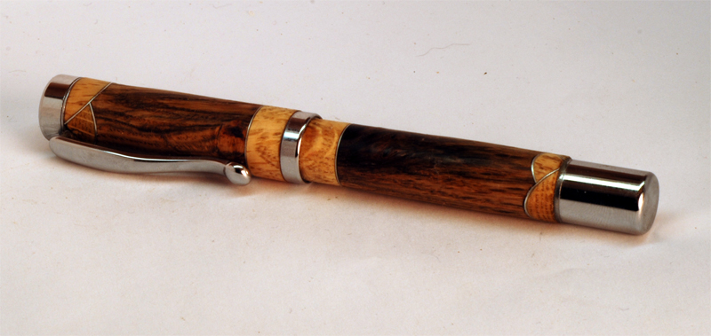

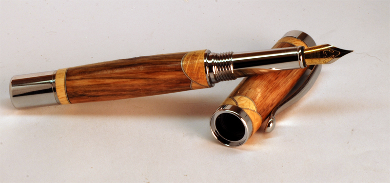

This is a rollerball (Continental from Woodcraft). The wood is walnut from an old tree in Forest Park here in St. Louis (site of the 1904 World's Fair).

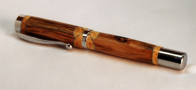

Body is the heartwood and the scallops and trim are the sapwood. I'm doing a fountain pen tomorrow which will be reversed (scallops in the middle, band at the end) so the user can differentiate them without opening them up.

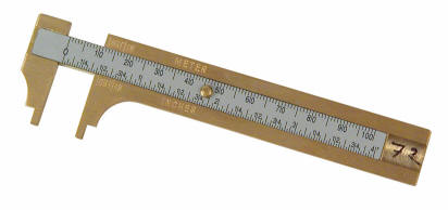

I don't go so far as using digital calipers, just my grandfathers old brass calipers like this. As long as it slides the length of the blank on both axis (axises, axis' axi?), it's square enough for me.
