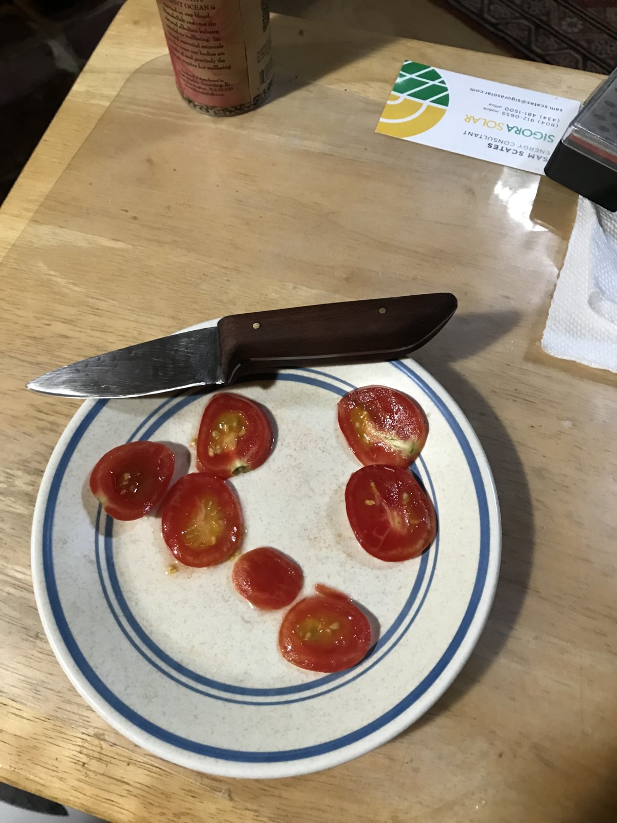

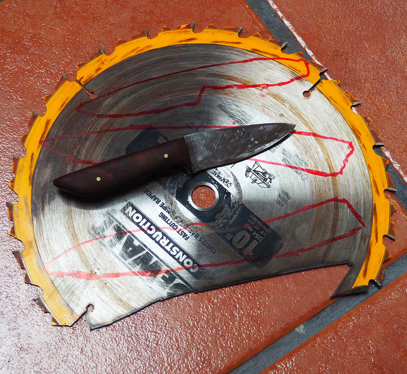

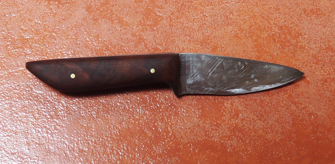

I decided to make a knife using an old circular saw blade. I heat treated it with a Mapp torch and fire bricks. Not a work of art but it's sharp enough to shave hair off my arm.

That's something I would like to try also. . What size is the circ saw blade; and, how do you cut it ?

It was a 10" blade. I have an old band saw that I put a metal cutting blade on and used that. I tried cutting with an angle grinder but hat was taking too long so I tried the bandsaw. I did use he angle grinder to do the rough shape on the blade.

Be careful with saw blades with carbide teeth, the base blade isn't always good for blade steel. The ones with teeth ground directly on the blade have to be made of hardenable steel. Also, Vegetable oil makes for better quenching oil, thicker oils are slower to pull the heat out of the steel reducing the chance of getting a hard blade.
