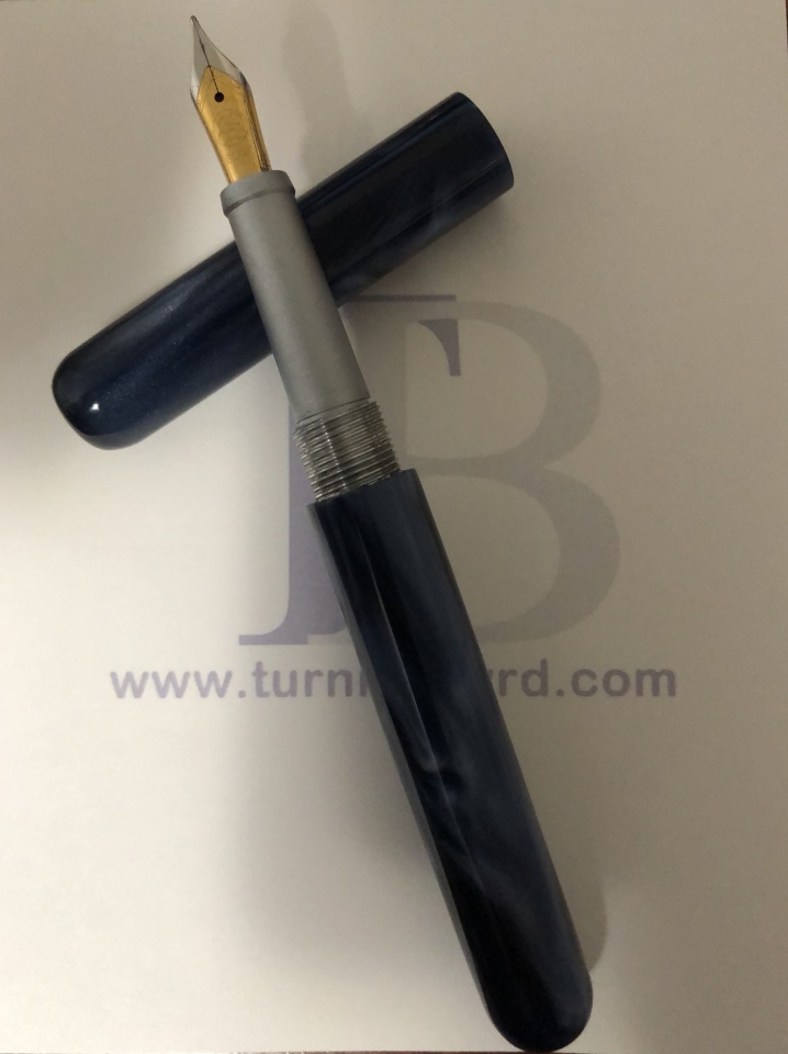

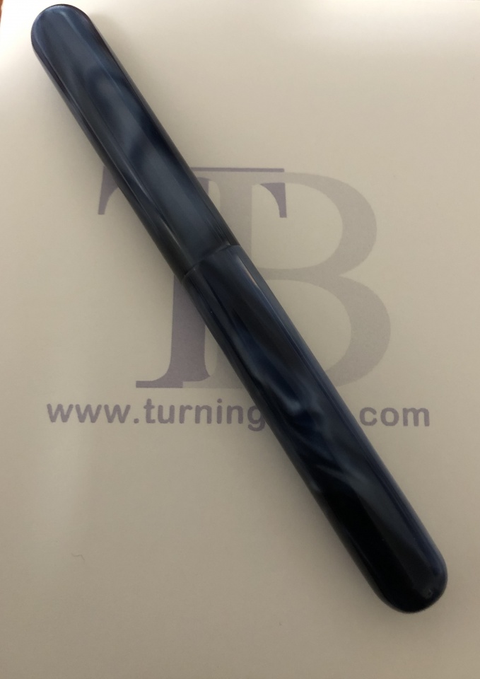

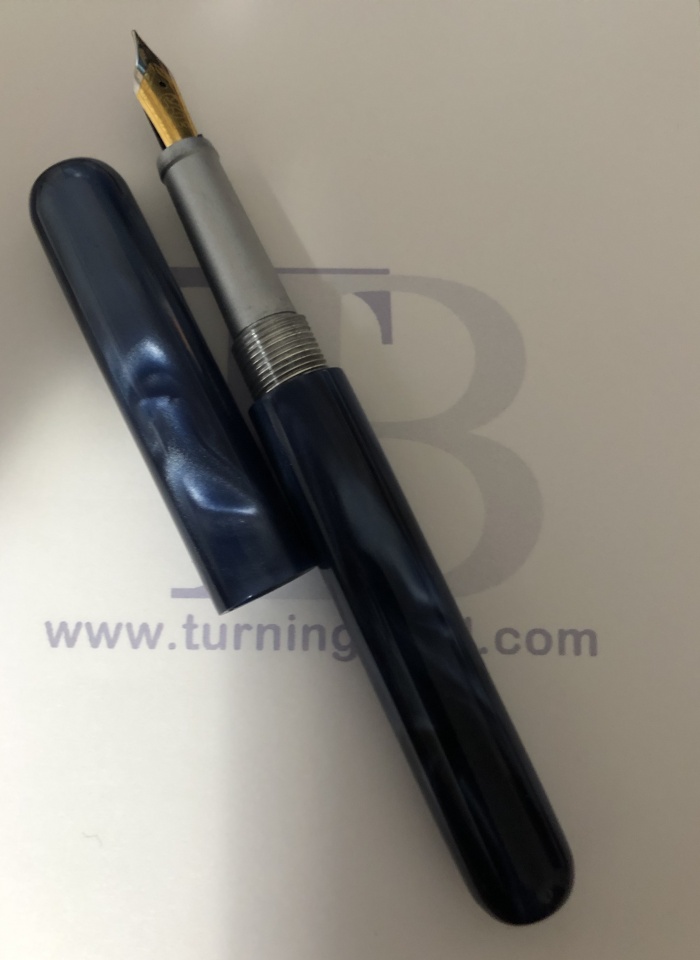

I admit a lot of work to be done to perfect but I am happy with the first one! Had trouble with cracking on the body threads so I made them out of aluminum. Got a new tap so will try that again! Turned on a wood lathe - Can't wait to get a metal lathe!
5MM Bock nib and section.
Comments and critique invited.

Nice first kitless Keith. I like the material for cap and body. So Bock has sections too? Didn't know that. You're on your way!
This looks great - good for you! I've used a Bock section a few times, as it allowed me to get down to an 11mm cap thread and make a very small custom pen. Now...time to make your own section! Good luck on the journey.
I admire your work, Keith !! . This is a pen to cherish !!
I would be interested in knowing the thread specs please ... the threads that are shown.
And what is the material you made the cap and body out of ... the usual acrylic ?
Thanks Mal
Thank you!
I used M11-.8 tap and die for the cap and body threads and M8.5-1 tap for the section using a Bock section.
It is an acrylic - I. think I got from Exotic Blanks call Blu Steel mist. I have made several pens out of it over the years.
