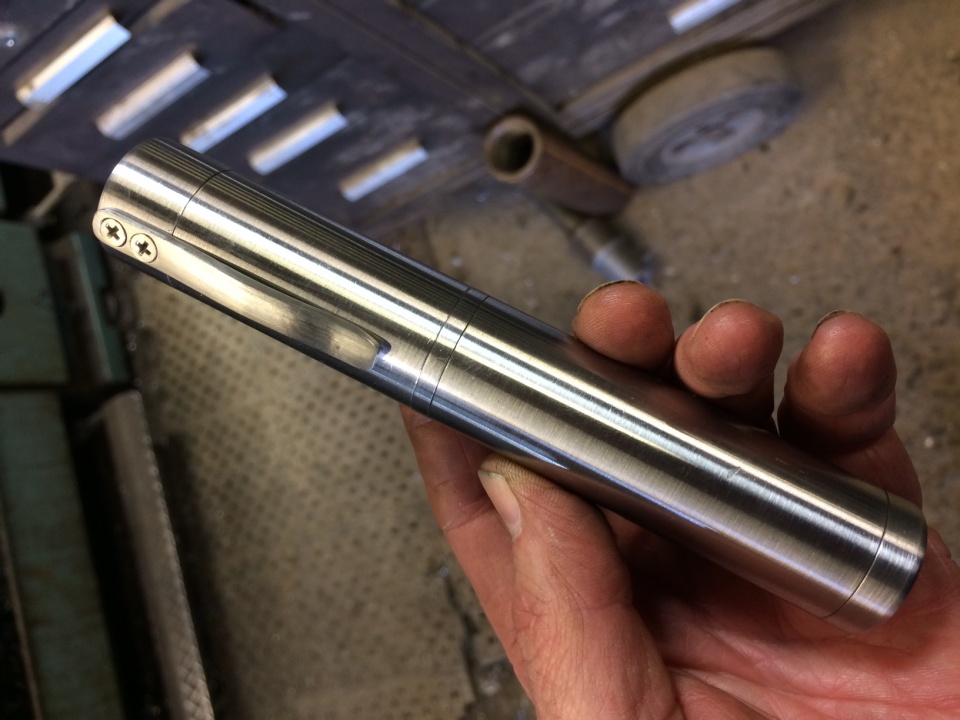

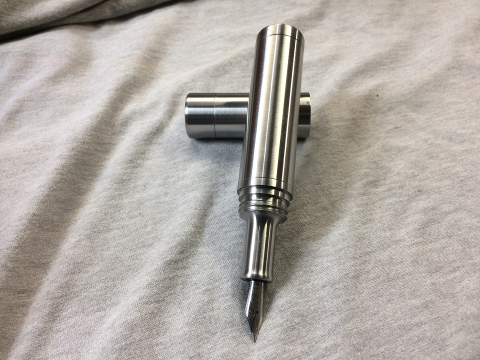

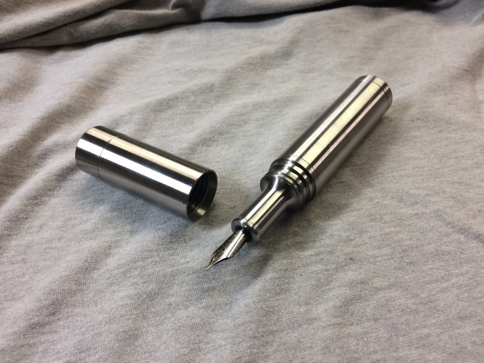

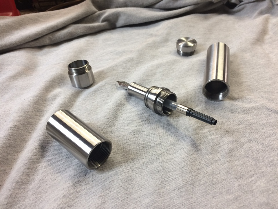

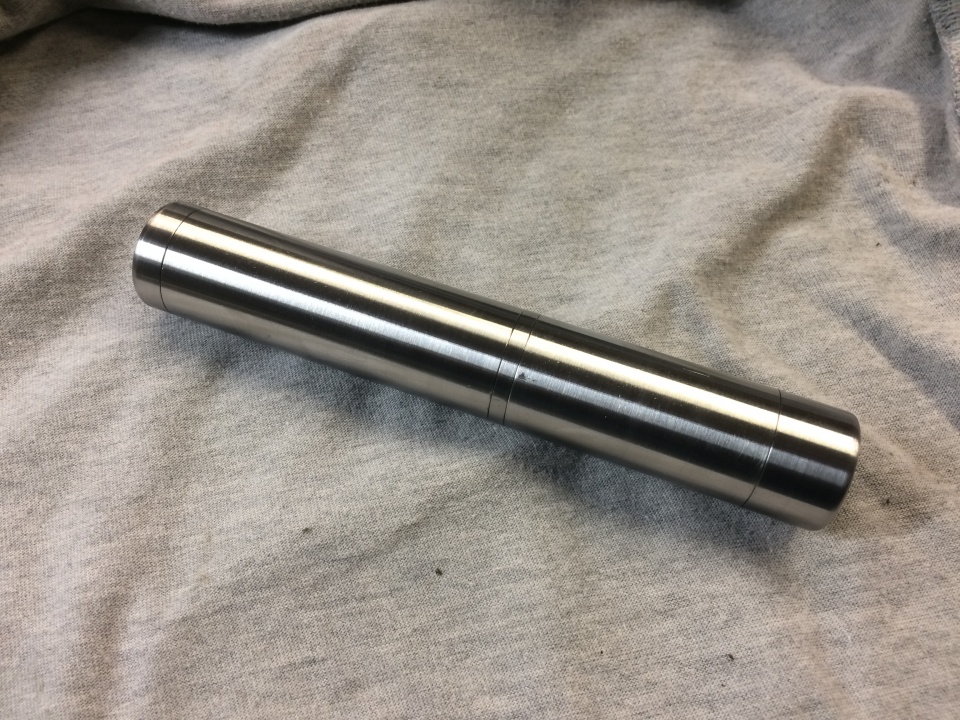

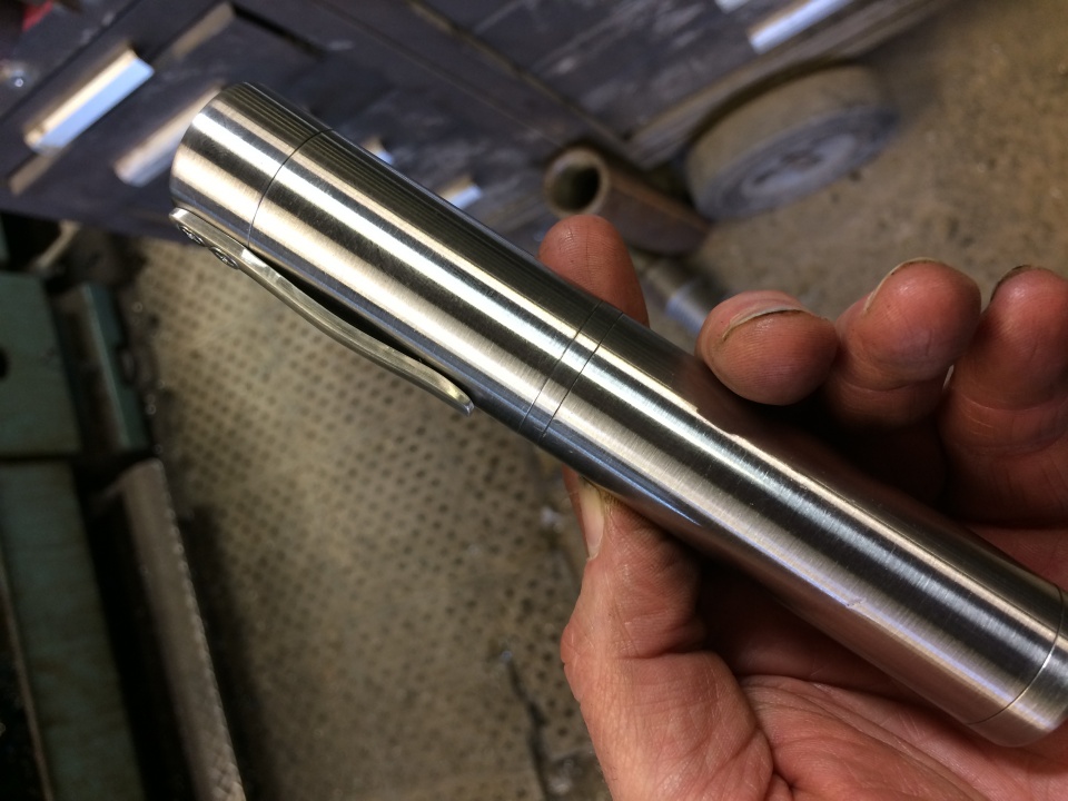

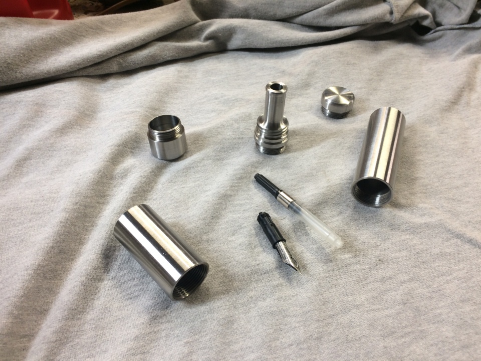

It really is. I tend to over think projects so some get put of. Decided to just play and go big. One inch 304 stainless tubing, and some left over 17-4 stainless. Was fun to make and let me play with some thoughts. Next one will be 'normal' size of similar materials, hopefully soon. Oh, it has a Bock nib :). Closed it is 6" long and weighs 8.9 oz!

Paul many people ask what threads a kitless maker used for their pen. The cap threads look like doozies. Would you mind telling me what it and the others are? Thanks.
Like I basically said on Facebook. As an eye dropper it would hold an entire bottle of ink. :)
Paul in OKC
Jul 26, 2004
3,092
Oklahoma City, OK, USA.
Threads on both ends of the body, and top end of the cap are 20 tpi. The cap to body connection is kind of a combo. I didn't want to mess with 2 or 3 start threads, but didn't want a bunch of turns either, so I tried to making a shallow 10 pitch thread. The female used a regular V thread. The male thread is a modified V. There is an oilfield thread called an MT, it is 60* with a .055 flat instead of full V profile. It is also a 6 pitch thread. So I played in AutoCad and came up with what it would look like run as a 10 pitch. Still deeper than I would like, but I had plenty of material :). Also the advantage of the full size machines at the shop. I intend to give double or triple start threading a go on one in the future, and will come up with a size that fits what I am doing. At least that's the plan!
