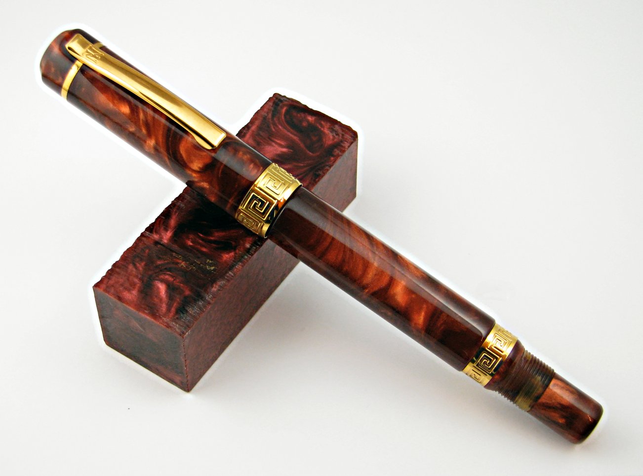

I realize is might not be technically kitless because I used leftover parts from a PSI Apollo kit. While I don't think much of PSI, they did a real good job getting the Gold Ti to look, well, gold. I used the innards a while back for something else, and it seemed a shame to waste the rings and the clip. Of course I could have done it without all that (except the clip) so I would say its my first kitless.
It has few flaws, but I now know how to fix them, and my next should be perfect.
I wanted my first kitless pen to be from one of Dawn "PR Princess's" Polyresins. She was one of the first to really "get" how to do these homemade blanks. As anyone who has done kitless with PR knows, it has many pitfalls, all of which I found. I actually have not yet finished the nib. But I'm almost there. If I hadn't discovered a freebie of the Burnt Copper in my FIB (Forgot I Bought) box, I wouldn't have been able to finish it. The main problem with PR is how hard and brittle it is. Further compounding this is how the brittleness varies within even a single blank.
You can tap thread it, as long as you leave enough supporting material around it. You will have to "face" the first part of the hole because it will likely have chipping, but it works well. However, die thread it at your peril. (If you can do internal and external threading with a lathe, that would probably work.) Thus to use PR with taps and dies, I recommend tap holes only, and anywhere the parts need to be joined do a screw made of Lucite. (Lucite does not have this problem. It is a dream to turn and thread.)
Along with using centerband threads on the nib, instead of the lower barrel, I wanted to do a postable finial. That meant die threading, so I had to make Lucite triple start thread sleeves, slipped over a Burnt Copper tenon. That meant that both required five different parts. It took three tries to do the finial. (I started hearing cracking sounds in my dreams.)
Kitless can be done with PR, if you're willing to work through the complications. Or perhaps some of the more expert kitless folks have found a better way, which I'd love to hear about. I plan on doing Cetacean Seas, Golden Dawn, Verdigris, and Ancient Mars PRs at some point, but my next will be Lucite.

Though not a panacea, you can make an insert with the same thread as the internal to provide support for when you cut external threads. Makes a big difference in failure rate. I made mine from delrin and cut a little slit in the top to screw in and out.
Nice start anyway.

Yeah, I did that. I made two 3/8 NC24 delrin plugs for the tap holes in the lower barrel, and one with the M12 x .8 for the cap. You definitely want to provide support for the PR whenever you can.
The only real trouble was when it came time to die thread a PR tenon. Especially one that small (3/8), although even the m12 x .8 was a mess.

I have seen the outside threaded first and then a piece (delrin or similar material) that screws on to the outside threads, then drill and tap the inside threads. So it could work either way.

Very, very impressive. I have had so much trouble with PR that I have almost completely stopped using it. You are inspiring me to put it back on the bench. Though I must admit I have had ZERO success with any outside threading, and have no solution to this....any tips are welcome :redface:

Wow Eric! That's beautiful! I did my first kitless in PR as well and I got lucky with the cap/body threads. The front section gave me alot of trouble though, I think it took me 4 blanks just to get that done. I also had nightmares about that "cracking" sound. You know you have to turn that die just one more time but you just don't want to! I like how you incorporated the bands and LOVE that you made it postable. With the cap/clip section, is that threaded as well or is it pressed in? You have such a perfect fit there! Congrats again!

The cap finial / clip assembly is threaded. Everything is threaded. It's really pretty cool to be able to do that now. I've been hoarding extra special blanks for when I would finally be able to do this and I'm excited anew about making pens.
I also finally hunkered down and learned to tram a four independent jaw chuck with a dial indicator. It's not that hard but it seems daunting at first. The 4 Indy Jaw chuck is my new best friend. I may even sell off my Grizzly precision collet set.

If I had known at the beginning, I might have started with something else. However, having it sussed, I know how to do it and I have some very sharp blanks that are just wasted on kits, yet too good not to use.
I made about six pages of notes on this pen. Some of the notes were superseded by the time I was done.

I seem to recall in reading through some of the casting threads, there is a PR type that, once cured, is easier to turn. I don't know if switching to that is possible, or if it would solve all of the difficulties in doing a kitless PR pen, but perhaps it would be worth looking in to? A metal lathe makes turning them round very safe and easy, but I did notice how some sections of even a single blank could have greater degrees of brittleness. Bit one of those with a skew, and well .... I can understand why some have had difficulty turning PR on a wood lathe. Your single and multi-colored blanks are just too nice not to get used.
At any rate, that one was worth the trouble. I think, on this pen, I made just about every mistake one can with this kitless turning, and I know how to get around them, so I'll be doing more. Save your best blanks for me. :biggrin:
