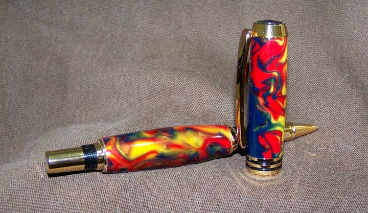

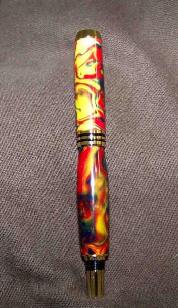

This is made from my 1st batch of PR. I used Cast-n-Craft PR with Testers Enamel paint. Somehow the Yellow in the cap didn't stay as translucent as it does in the body of the pen. Dunno what happened there. Any and all comments or questions welcome.

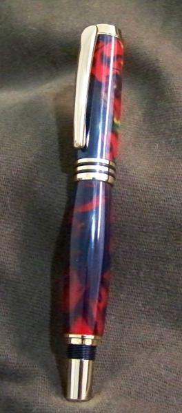

Thanks everyone for the kind words...however - there is only 1 pen in those pics. Since it was my first time casting I goofed and poured all my blue color first then the red then yellow. I should have poured blue-red-yellow-blue for a better transition bc most of the blue is on one side of the blank. The order i did this was I mixed my colors then added catalyst. Since this isn't a PR with a part A and part B i would assume I could add color at either moment bc i'm not diluting my mix with an extra additive (i could be totally wrong though) The colors i used were testers enamel paint. I just added color till i was happy with what i saw. I used 4-5 drops per oz. of catalyst. The kit is a 22kt gold tycoon from PSI. the second pic the flash makes the metal look a bit off. maybe thats why some people think theres two diff pens. maybe i'll title this mix Harlequin for its light side and dark side :tongue:

Jonathon did an excellent job on this pen! Much better blank than what I cooked up. The colors are somewhat translucent so it appears like they are floating. Really cool effect! The yellow and red have metal flake in them and have this amazing sheen in the sun. Great Job Babe!

Nice. I believe your yellow is different in the cap than the body simply because the resin in thinner there. The cap tubes are larger, so the acrylic is turned thinner. I've had that happen as well...

I didn't think of that...i'm betting that is what has happened. The lower barrel has such depth to the colors and the upper doesn't have quite as much so i think the larger barrel size is the factor. Thanks! something more to ponder for my next pour!!
