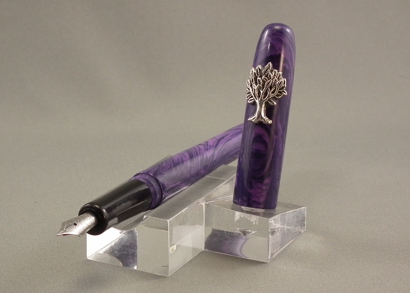

Well I himmed and hawed, I planned and I procrastinated, but I finally did it.
My wife has always complained that she is the only one that has not received a fountain pen from me. I didn't want to tell her that my intention was for her to get my first full custom for her birthday on the 17th. The whole thing took me about 14 hours over the last 2 days. Silly me, I had told her that I was all finished my custom orders for Christmas. A lot of fast talking to explain all the shop time on the weekend.
I chose a piece of Charoite TruStone for my first attempt. She loves purple, and didn't want acrylic. {I'm a glutten for punishment}. I had a number of problems.

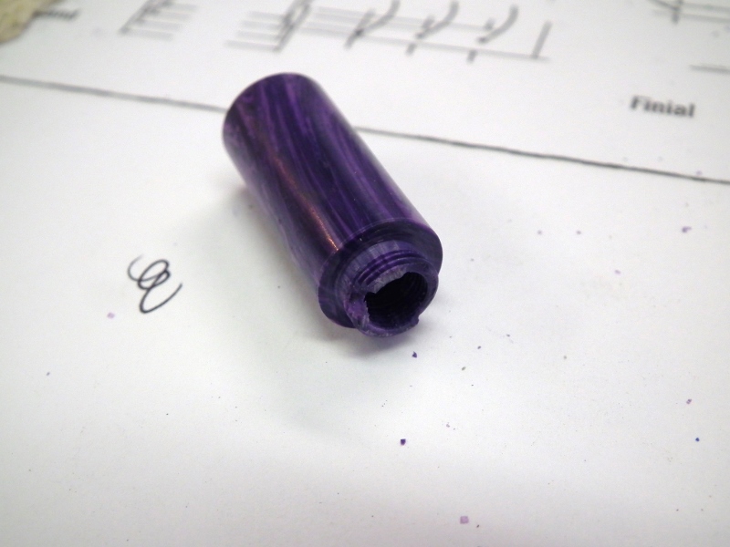

The first fail was in the TruStone, the section to body thread broke while trying to thread it with M9x.75

The third attempt was a fail again with the Trustone. It broke in the same place as the first attempt. I almost had the converter hole drilled out, when it broke. I guess my problem is with the material, not the technique.

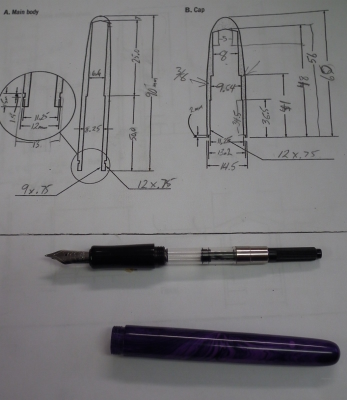

I used "The Penturners Bible" for guidance. Since I didn't have the same tooling, I had to alter the dimensions to fit what I have. I photo copied the dimension page, whited out the numbers and used it to record my own measurements. Helped to visualize.

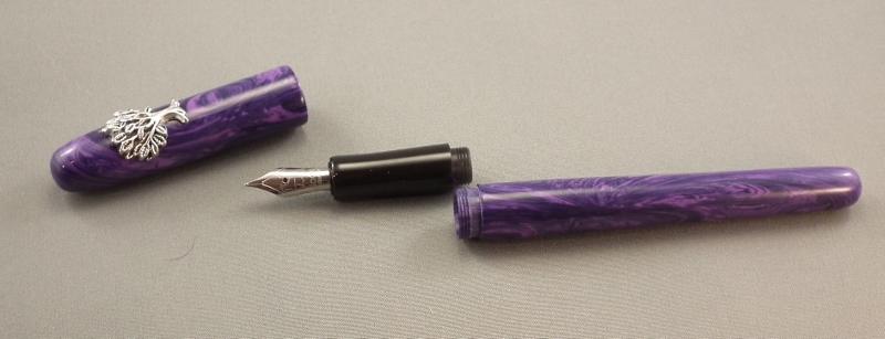

Section to Body M9x.75
Cap thread M12x.75

Thanks to my handy dandy Princess auto super set of drill bits, I was able to figure out the best ones for all the steps I did. You can see the measurements I used in the photo.

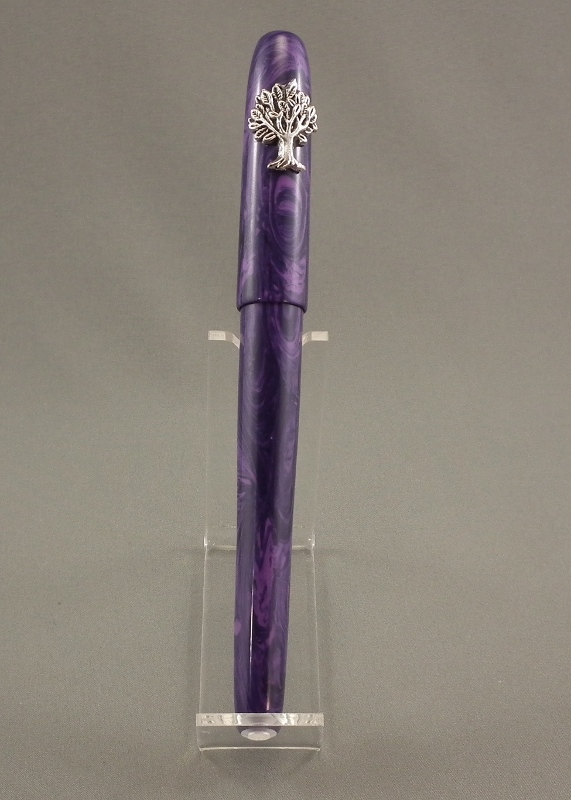

I finally added a rollstop from a charm of the Tree of Life. Shaped on a dowel and thinned, then epoxied onto the cap.

147 mm Capped - 24 gr
141 mm Uncapped - 14 gr
160 mm Posted
13 mm diameter for the body at its widest
15 mm diameter for the cap at its widest

WOW!?!? I can't believe that you made a custom pen from tru-stone. I'm really impressed. That had to be a nightmare to thread. I know you had several failures with the section, but don't worry, you're in good company. In the future, if you use tru-stone again, you can make the body threads with a complimentary color of alumilite. Basically, you drill the blank and insert a sleeve made from alumilite. That's how many custom wooden pens are done. You could use the same color of alumilite to make the section if you wanted something other than black. But I'm really impressed with the pen. Even more so that it's your 1st custom pen. :good:
I sure hope she never drops it.:eek:
Beautiful! Great job. I didn't know truestone would thread or that there was a Pen Turner's Bible, gonna check that out.

Very nicely done! That is a beautiful pen and justifies all of the trouble it caused. Congrats!
The second one is usually more difficult, because we all think we can knock it out after doing all the learning on the first one. The combo of high expectations and not-quite-fully-developed-skill level can sink a person.
She should love that purple pen.:smile:

Different trustone,s turn differently. I found this one worked well, it was just to thin at the section thread.

How did you do the roll stopper, like a hidden clip method?
I just thined it with sandpaper and shaped it on a dowel, then I used 5min epoxy. I also drilled a couple of shallow holes under the charm for the glue to go into.

No its not a clip Phil. It acts as a rollstop, to keep the pen from rolling of a flat surface when you set it down.
Its a necklace/bracelet charm i picked up at michaels. I filed off the ring for the chain then sanded the back to thin the overall charm. I then bent the charm to shape on a wooden dowel. Finally i epoxied it to the pen cap.

Trustone threads nicely BUT is very prone to through-cracking. DAMHIKT. Much better to 'sleeve' it with ebonite, alumilite, brass or aluminium to carry the threads. Ask your lady to be very gentle with it - slightly too much pressure on tightening and the threads are gonna pop.
