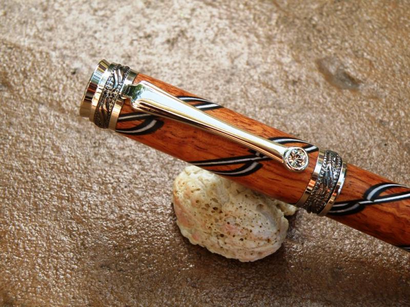

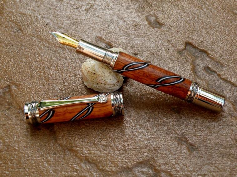

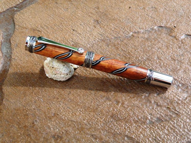

For my first fountain pen, I went big. Didn't realized the Majestic from PSI required a drill bit that was this big! And even better, the blank didn't blow! I received a gift from Steve and wanted to do it right. I'm really happy with the first shot. It's a Majestic with a BLO/CA finish. Let me know what ya think. Sorry the pic is a little on the shaky side.
I've updated the pics and am much happier with it.

The turning is nice, the blank is nice. It could be just the limitation of the photography, but it looks like the CA/BLO finish isn't quite there yet because it's not glossy.
I do struggle with getting a real shine from the CA/BLO. I tend to get a beautiful shine with the thin CA 20 coat method, but didn't want the thick plastic look. I think i got what I was going for with this one. Some day I'll figure out the BLO with CA. I might not be doing enough coats of it. I did 5 or so.

For the record, I never did master CA/BLO myself. I am still using the same thick CA method that I am comfortable with, with its wet plastic look and all, which I love.
I just noticed you mentioned needing 20 coats of thin CA. You might want to try medium or thick CA to build up thickness fast and to cut down on the required number of coats. I only need two coats using thick CA that I apply by sandpaper (not by BLO). I let the CA harden in between coats and sand smooth and polish.
