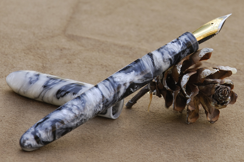

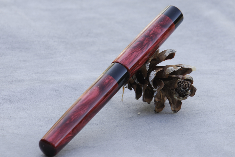

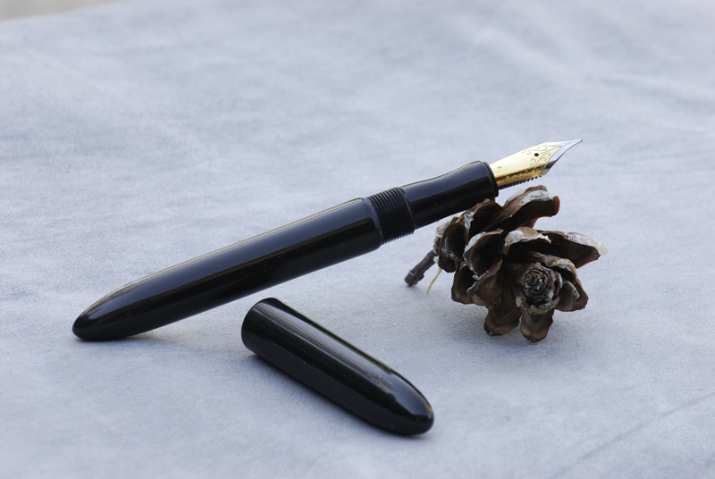

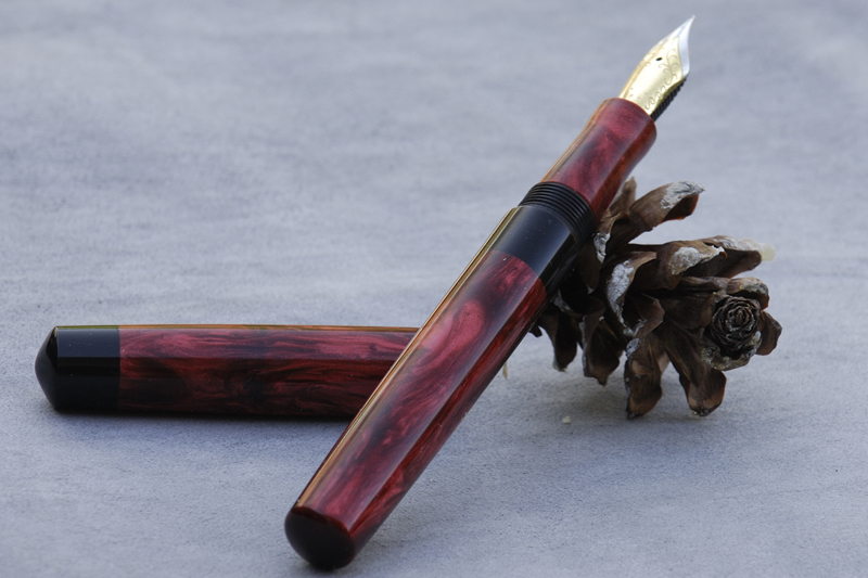

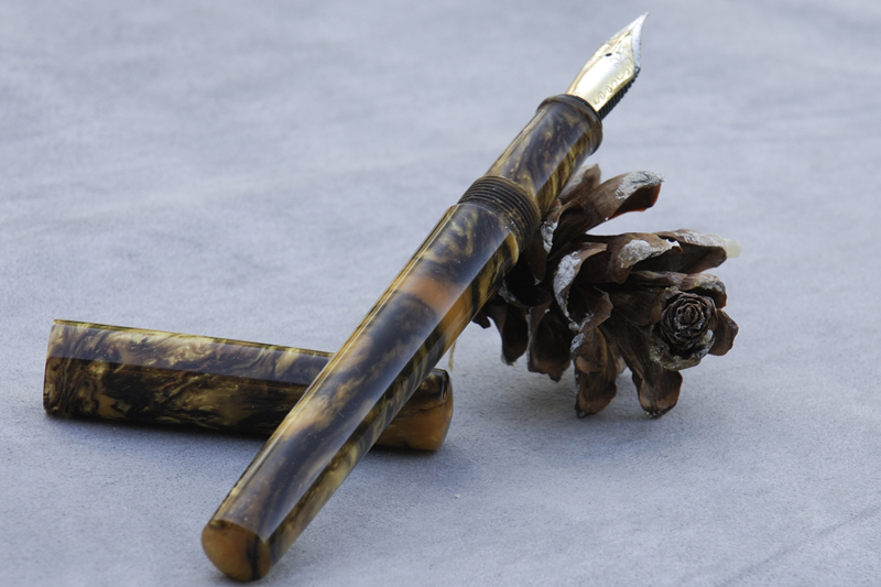

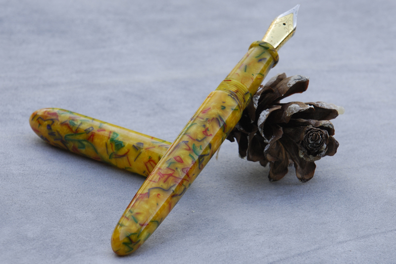

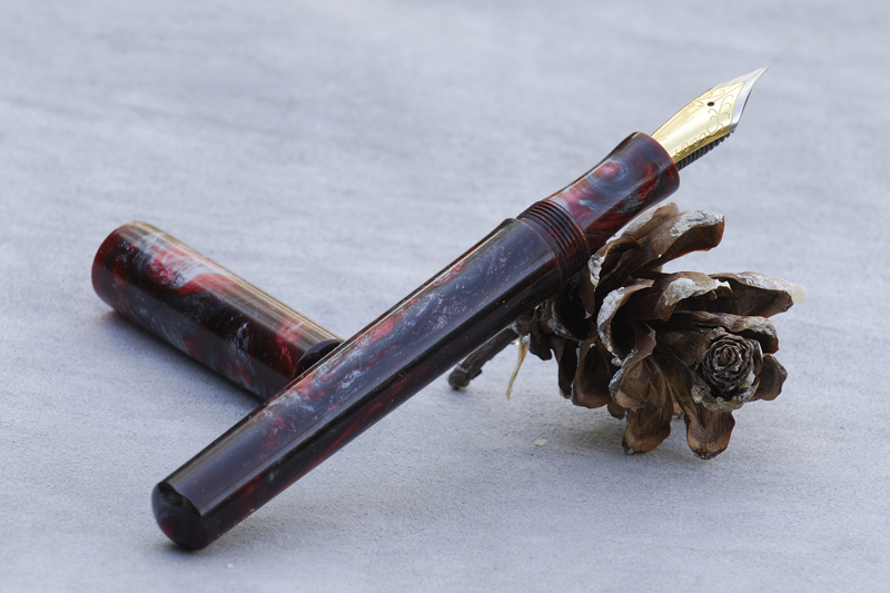

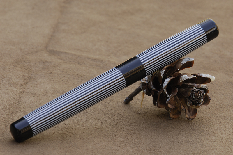

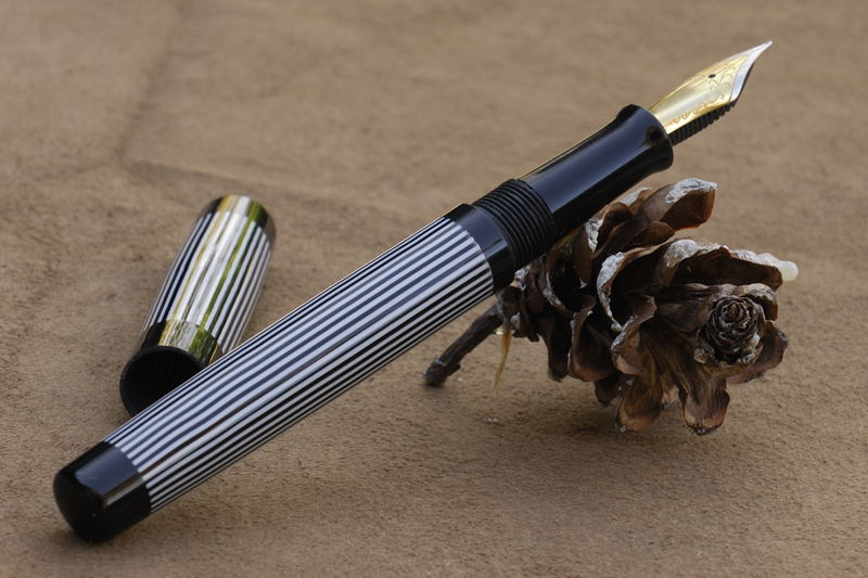

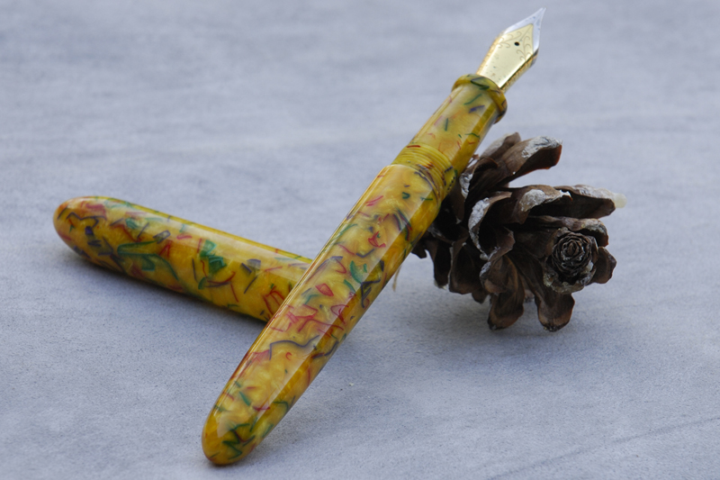

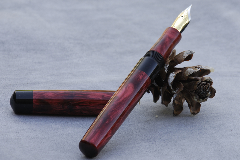

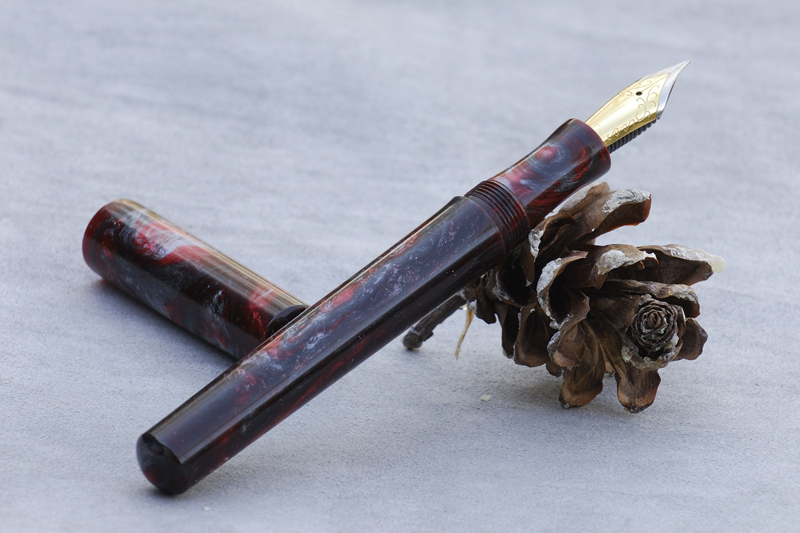

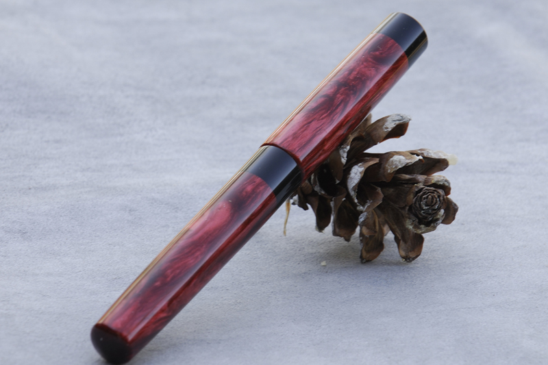

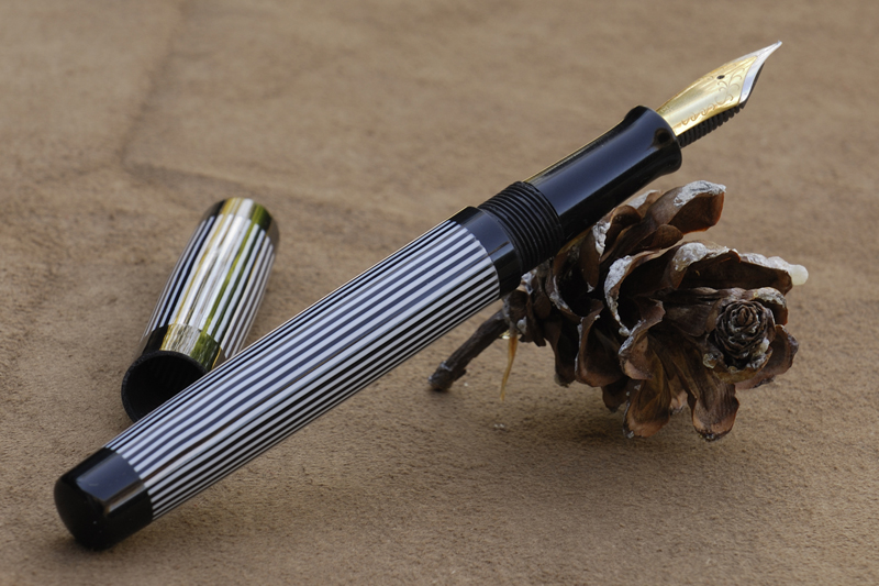

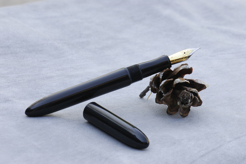

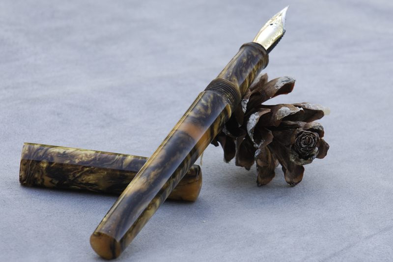

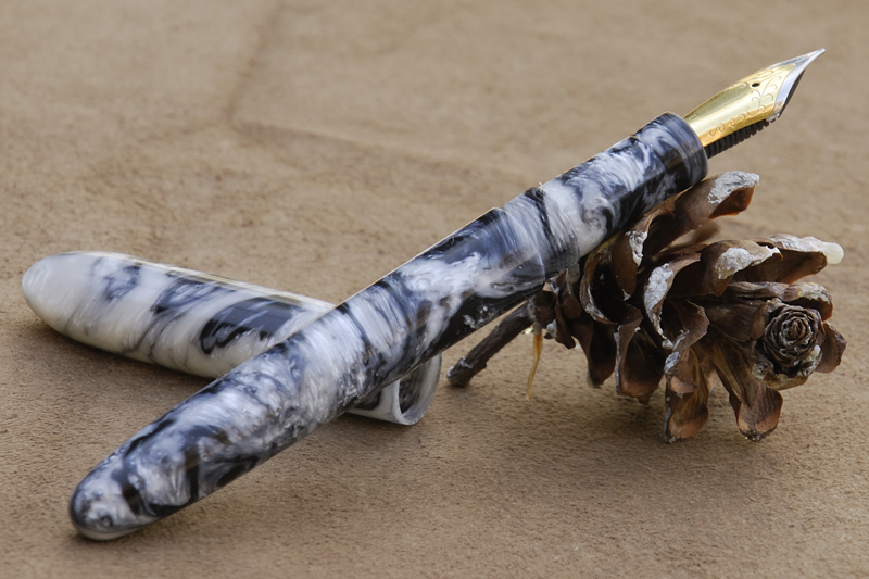

First seven kitless, actually more like the first nine. I figure I made 4 pens to complete the first two (5 sections, 4 bodies and 3 caps) before I got the hang of it. Since then have only had a couple of remakes, both sections. Constructive criticism would be appreciated.

Wow! man those look great. the striped and red ones are eye catchers. Did you happen to take measurements of the body and cap o.d.? Love seeing other peoples kitless work. thanks.

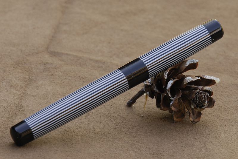

The threads on the first six are 12 x .75 single. The first couple take about a minute to remove the cap, way too long. 4 or 5 threads should be adequate but I just couldn't seem to shorten that tenon enough. After I finished the sixth I splurged and bought the 12 x .75 x triple from silverpenparts.com for the black/white striped one.
The cap outside diameter on all the pens is between 13.5 - 14 mm. I need to take and record measurements after turning/before finishing and afterwards. At this point, I just turn/until it seems right and finish, so I don't have an exact plan for finished diameter. Most of the bodies are slightly smaller than the caps, the last two I tried to make the same diameter. Thanks for the comments.
Lol, I hear you on the multiple turns with the single starts. I sprung for a 11x.8x3 from Mike after making a couple of kitless roller balls. What a difference the triple starts make, 3/4-1 turn. Definitely gonna get the 12 mm T&D when I can.
Great work, there! Lovely shape and consistency in your pens. Haven't made enough myself to give any constructive criticism!
I think these pens are gorgeous. I've made three kitless so far, all but one too ugly to post! Your work is inspiration.
Nice work.
I think the red one is my favorite.
I here you on the threads. All of mine so far have been 12x.75 thread. The trick I found was to remove threads from cap until the body takes 2 turns to screw in. Its a little hairy getting in there with a cutter, but its fairly easy once you get the hang of it.
Do you plan on adding clips? I have been using Triton clips if I want the ring visible, and Churchill clips for hidden. I haven't gotten to the point of making my own yet.

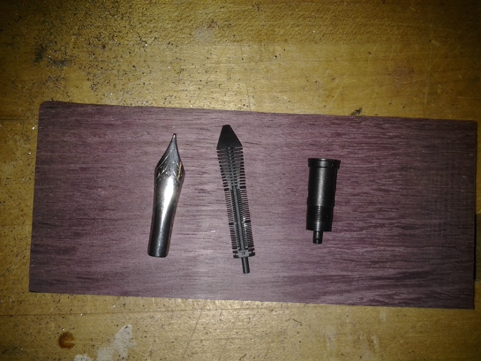

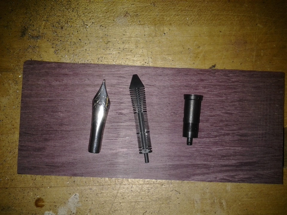

While they do look a little like sections, the pictures are not sections. Those are 3 piece combo's.
The nib
The feed
The feed holder
You drill and tap a hole to fit the holder, then the feed and nib push into it. You do need a special tap, depending on the size of feed.

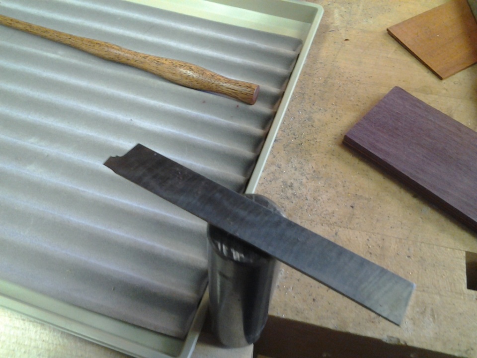

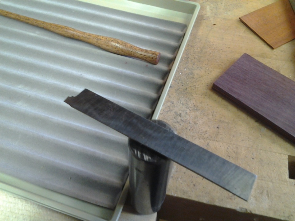

I use a flat cutter. It actually started life as a part off tool.
I ground the corner so that it is thin and square. I have a flat tool rest that I lay it on, and set it so it is exactly center height in the hole. I hold it against the threads Iwant to remove, and turn the lathe with my hand. Usually a couple of turns us sufficient.
I'll try and take a picture of my set up. I have at least 6 more pens I have to finish by friday, so it should be in the next couple of days.
Here us the cutter sitting on the tool rest.
