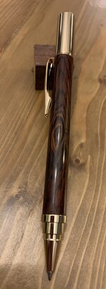

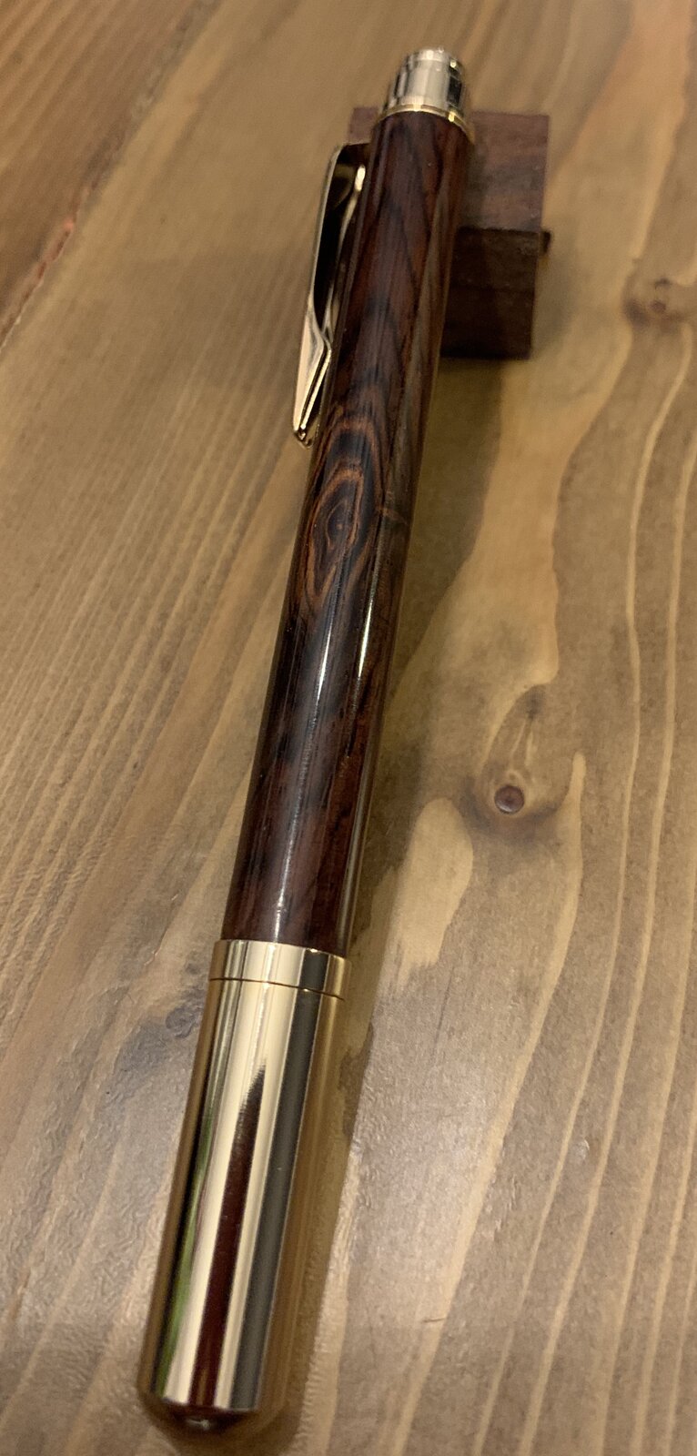

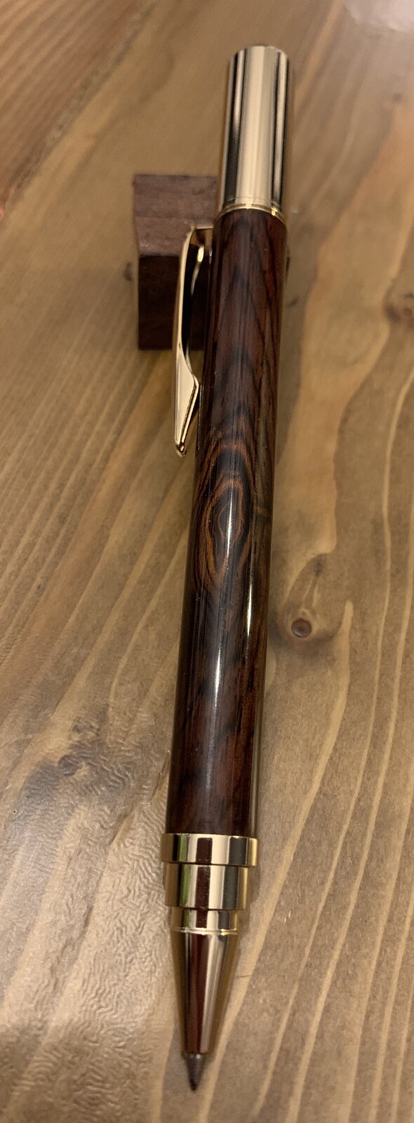

Rollester kit cocobolo wood
almost gave up twice on this pen after sub par finishes, sanding back down and starting over. Glad I didn't because I think the finish actually came out decent (at least for my standards)
only thing that irks me is I'm undersized on the nib side, I would guess from sanding it down twice....

Looks really good !!
And with that style of nib it does not look out of place to have the wood slightly undersize.
In fact, it could be said that that is a style-enhancing feature of the pen !!

That looks like a really good finish to me.
Could you maybe disassemble and reassemble the other way round? Less noticeable that way.
Thanks! I've never disassembled, I thought about flipping it around before I put it together, wasn't sure which would be more noticeable so I went nib side. I knew I was undersized before I assembled but couldn't bring myself to mess with a good looking finish...
