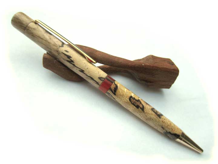

This is a first attempt at a custom finial. That's a new challenge :rolleyes:. I can see the advantage of collet chucks (which I don't have).

Yes once you have a set you will wonder how you ever did without them, especially when it comes to custom pens. Nice job BTW.

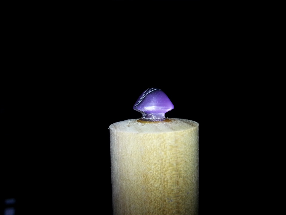

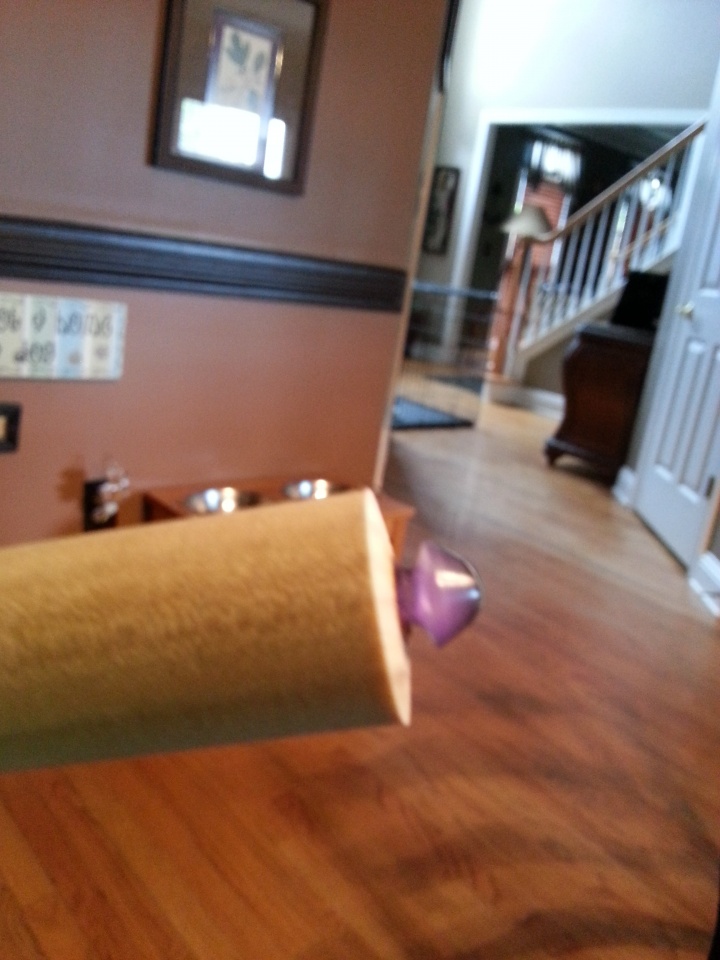

First attempt at custom finial.
Yours is much better than mine....and I have a collet system LOL
At least your made it over to the pen!
I know what I am doing now (sort of :)).
Nice work!

You did a nice job of grain matching of the finial to the upper barrel. To me it looks a little long and it was me I would cut the length by at least half.
