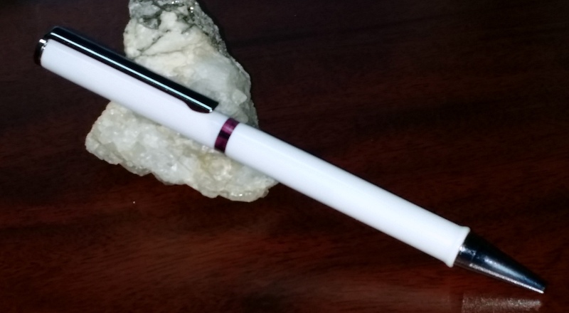

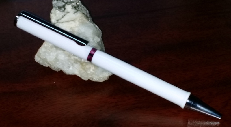

I just made this Corian Slimline. I have a number of 1/2" blanks I received from a member on this site. I was hesitant to try drilling the blanks because they are not square so they cannot be easily drilled on the lathe. I have a new drill vise which allowed me to drill the blank very accurately. I did turn the blank with carbide. It turned like a dream. I am very, very impressed with Corian.
