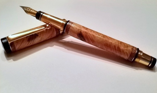

Not only was this my first commission but it was also my first fountain pen. It's a natural stabilized buckeye burl with rosewood segments at the top and bottom of each piece. I love how this blank polished up, I did 3 coats of thin CA and 2 coats of medium and then wet sanded it and it turned out great. I hope my customer is happy with it as I am.

Great choice of using the natural Buckeye...it just wouldn't have looked 'right' with the segmenting any other way! Congrats on the sale and the fountain!!

So I just delivered it, he liked it so much he tipped me a bit extra, gotta love that!
Thanks for the kind words all, also wanted to mention tried a couple other things on this kit for the first time. First a digital caliper, my God don't know how I sized things up without this before, made life so much easier, and Second I put sandpaper on my barrel trimmer and sanded the ends briefly after turning and finishing, wow did that improve the fit and finish of the pen.
