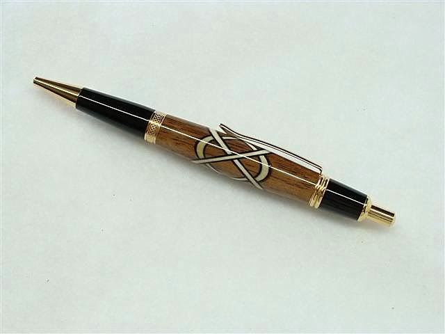

This is my first one with the black outline on the knot . It is also my first one done at 60 degrees . Nice change from all the ones I have made previously at 45 degrees and with no outline.
Hey . . . I think I'm catching on how to do these :biggrin:
Being my first one with the outline and not knowing the outcome , I used a plain piece of walnut. Wish now that I had used one of my highly figured walnut blanks
This one is going to be my own pen until such time as someone wants it more than I do .
Finish is 5 coats of BLO/CA 20 seconds apart followed by One Step Polish and then TSW.
I glued it up in the evening yesterday and let cure overnight . Then drilled , put the tube in , turned and finished it this morning.
Thanks for the kind remarks

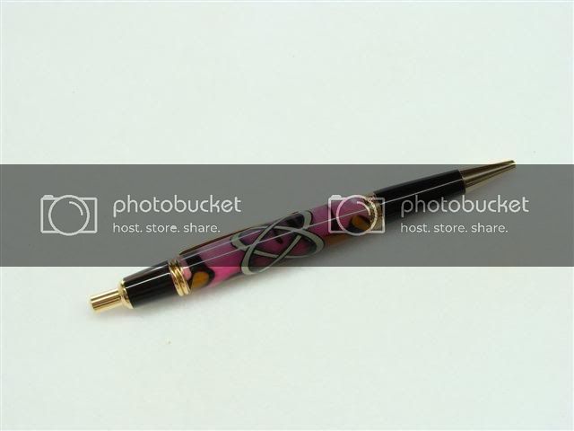

I decided to try one in acrylic so after lunch I found an odd ball blank that was purple on one side and brown on the other and thought that would be a good one to experiment with because if it didn't turn out right I would not have lost much.
These things sure are time consuming. It took me from 12.30 to 3.00 PM to make that one right from scratch.
I fully understand that a plain background is better than a figured one for this type of pen but I wanted to see how it would look in acrylic . I might check a few suppliers for some plain , no pattern acrylic blanks now because although a lot of us woodworkers prefer wood there are a lot of non woodworkers that will buy acrylic ahead of wood . At least that has been my experience.
I also love the fact that no finish is required on acrylic . . only a sanding and polish.
