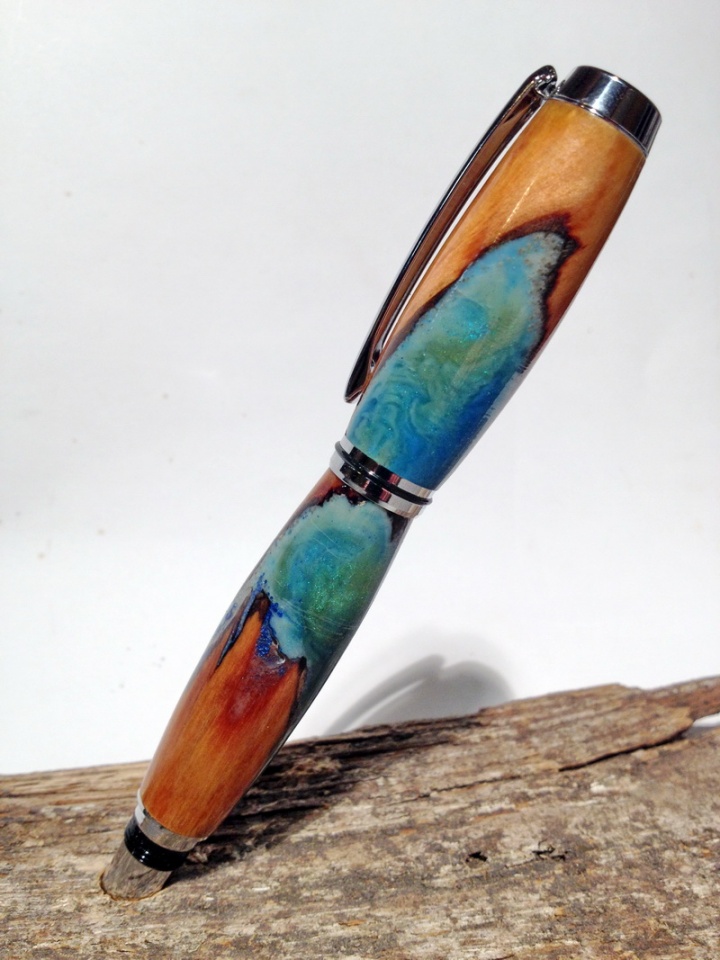

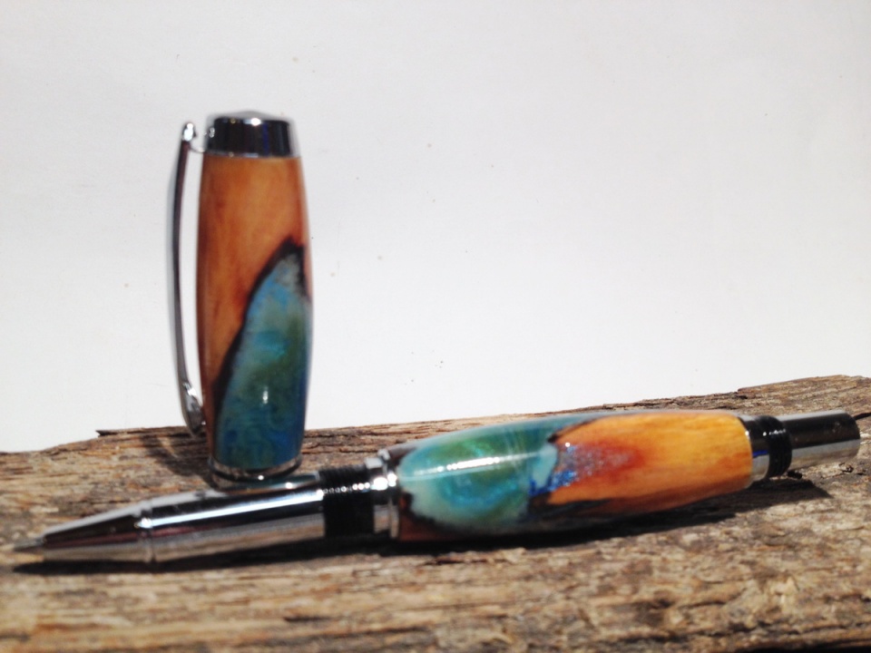

I bought a HF pressure pot on Memorial Day to cast some worthless wood blanks. I have played with casting resin from Michaels Craft store but never Alumilite. I have also been using some rich or fat pine for pens that I like and had some to use with Alumilite. This pen is the result of the casting, it was cast at 80# for 2 hours and cured overnight before turning. This turning has become adictive!

I agree with Jim... Less pressure will still be fine!
Sounds like me :eek:... If 30 is enough, 60 will be better!!!
After only 50 cast blanks... I like 40 PSI for 60 min (Alumilite). No experience with PR.
Take Care!
Oh!!! The PEN!
(Was too busy looking at the blank!!!)
This is a mighty nice PEN! I do like the blank ! Nice separation of colors.
Good job! :good:
I regularly use 65 for alumilite. I think as long as you stay above 30, you're fine. But since my pot is rated for 80, 65 seems reasonable.
