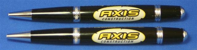

Here is my first try at casting a label. I just pretended it was a snake skin and all went well:D Didn't have time to take a better photo..the customer was breathing dowm my back wanting the pens. Comments welcome. Thanks Bruce!

Thanks Alan and thanks to the others for the comments. I did use Avery lables, 82xx series. Painted the tubes white with flat white spray paint. Thanks again.

Originally posted by laspringer
<br />It looks like another fine job from you Don.
Did you use the Avery labels?
Alan

Thanks Glenn. The label was stuck directly onto the brass tube which I painted white (spray...Rust-Oleum Painter Touch Primer) . Bruce Robbins first showed this to me.

Originally posted by oobak
<br />fine job Don, how was the label attached and was it directly onto the brass tube?
