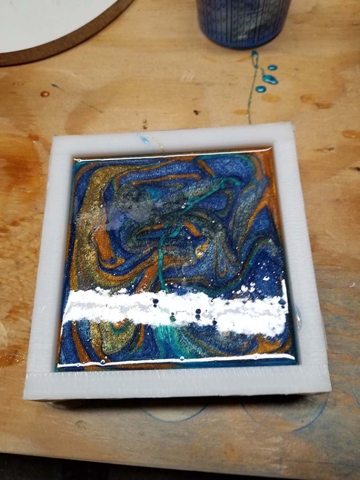

Its been awhile since I was even turning, well I started again and have now moved into casting. (well ok, trying to move into casting lol) We'll see how the first pour goes.

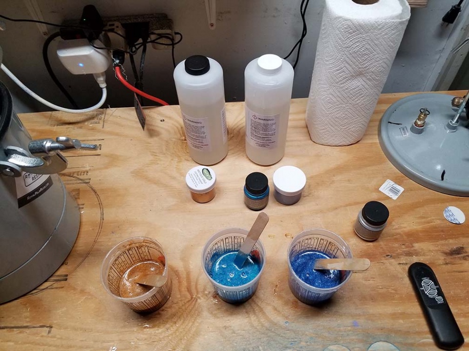

Starting out with Royal Palm resin. Going to pick up some Alumilite this weekend cause I don't like waiting. figure to cast with the alumilite over the weekends and the RP on the weeknights and let it sit in the pot.

I added the pics from my station setup and my first pour that is in the pot now.

I like the colors. Did you let the RP thicken before you poured?

And yup, she was about 110ish degrees when I poured. Then right into the pot.
