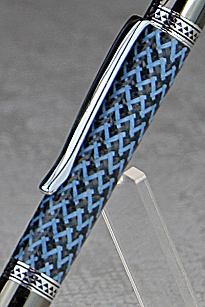

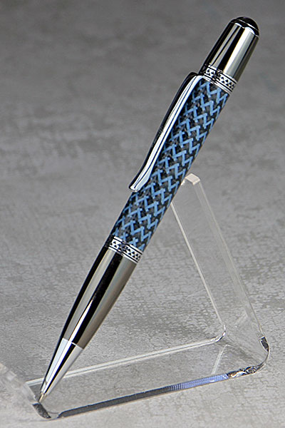

After seeing David's (a.k.a. theidlemind), post "carbon fiber how-to", I decided to give it a try. I ordered a small assortment of carbon fiber and carbon fiber/fiberglass sleeves and my wife picked out this color (after complaining that it looked like a box of snakes).
attachment.php
attachment.php
I was impatient to try it, so I simply painted the tube, glued on the sleeve, and then did a CA buildup. I guess I'll just have to find another excuse to break out the casting resins.
I hope you like it,
Eric

How layers of CA did you need to put on this one? Is it completely smooth, as if it was PR cast?
I didn't count the layers - probably somewhere around 25. I built the blank up to just over 0.500" diameter and then turned it back down to 0.475". After sanding and polishing, it is completely smooth and indistinguishable from cast.
